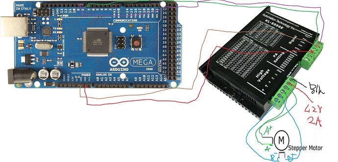

Hello everyone, I have been having a problem on my old Arduino setup with a NEMA 23 motor and the HY-DIV268N-5A driver as described on my previous post - the motor will work fine for a few hours or days and then stalls and grinds randomly. A few folks here recommended replacing the stepper motor and/or driver.
So, I've replaced the NEMA 23 motor with an identical new one, and switched out the stepper motor driver to a KL-5056-E which I've heard good things about. I connected this driver to my Arduino Mega and the NEMA 23 stepper motor, making sure to copy the same wiring as I did with my HY-DIV268N-5A. However, the motor does not seem to turn at all (and instead it will eventually get hot to the touch after a while). This heating up did not happen with the old driver/motor combo.
Attached is my wiring setup, which is the same as that for the old driver and motor (apologies for the MS Paint lol work computer here is quite old). I hope you can help me figure out why this is not working as I am still very new to this -
  1. First, I connected the Arduino to the Driver like so:
  • DIR+ is connected to Arduino digital output port 7 (green line above)
  • PUL+ is connected to Arduino digital output port 8 (purple line above)
  • PUL- is connected to Arduino PWR GND (red line)
  • DIR- is connected to another Arduino PWR GND (brown line)
  • Red power cable (42 V, 2A) to DC+
  • Black power cable ground (42 V, 2A) to GND
  1. Next, the KL-5056-E driver is connected to the new NEMA-23 motor: one pair to A+ and A-, the other pair to B+ and B-.
  2. I am using the following Python code to control the Arduino, the KL driver, and motor - user inputs 0 or 1 and then the motor should move 4060 blocks in one direction or the other (only one axis of movement). This is the same code I used on the HY-DIV driver setup with mostly no problems, except of course when it started grinding out of nowhere.

Running the motor at 2.8 amp from a power supply of 2 amp.....
timecode is set to pin wiring
Nothing wrong with that.
The driver works like a buck converter, drawing about 300mA from a 42volt supply.
Leo..

Interconnect all (-)inputs on the driver with short pieces of wire, so you can run a single common wire to the Arduino.
Normally you don't connect the EN pins.
Using them gives you the option of turning the driver and motor off.
Not sure why you mention xyz. I see one driver, one motor. Two pins are required per motor, step and direction. Almost any Arduino pin can be used for that.
A 24volt/2-5Amp supply should be ok. If you want cheap, then use an old 19volt laptop supply from a secondhand store.
Leo..
