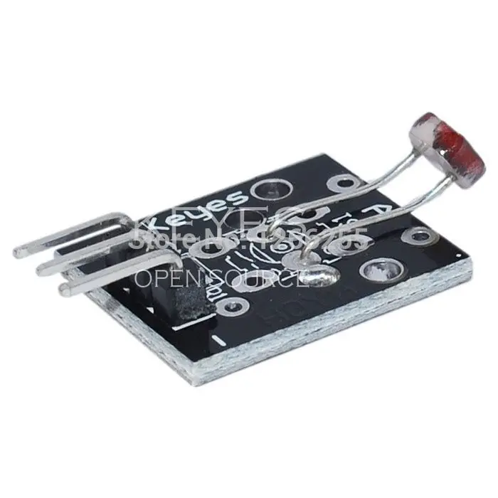

I tore off the whole thing and am now using an actual red laser emitter and a photoresistor on an analog input pin. ( this time on an arduino instead of straight on my raspberry pi's digital pin) |500x500 |500x500
for the photo resistor I used a piece of rectangular dark plastic where I drilled a hole in , glued a small dice sized block of wood next to it and put the sensor on that. the laser shines on the wheel and the reflection is a bright line. The photo resistor on the analog pin reads about 200 when lit, about 600 when the laser goes over the dark spot.
I also had to tape over the transparent parts of the meter because the thing sits close to the garage door. When the garage opened sunlight would interfere. Which did not happen for the IR sensor though.. Still . The laser saved my life. It's way more robust than using an IR sensor/receiver.
