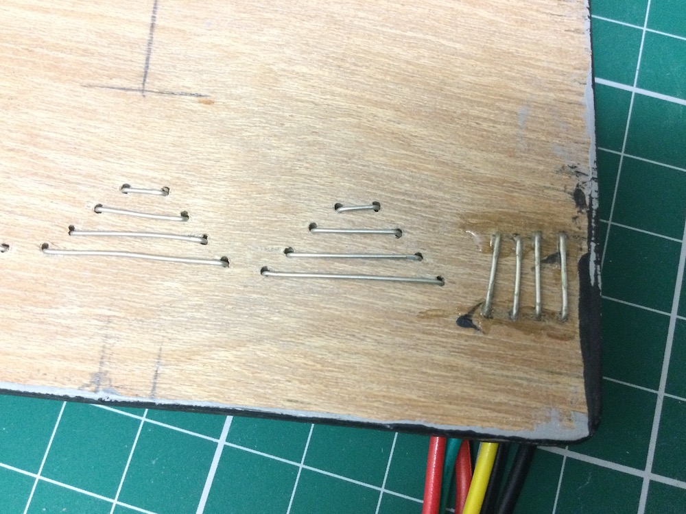

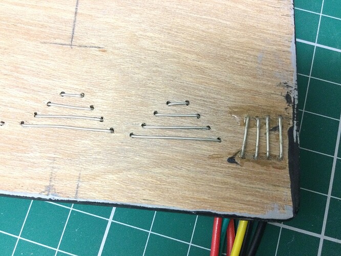

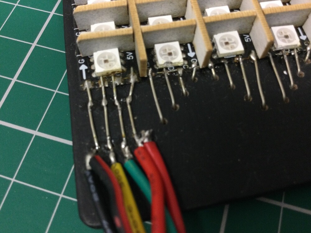

What you need is some backing, if the strips do not have to bend.
I used 0.5mm diameter tinned copper wire, this is very strong, you can not break it. I uses some thin ( 3mm ) plywood for backing when I made a matrix using this sort of LEDs. But you can just use a thin strip, or even smaller piece if the strip needs to bend beyond the first LED.
I drilled two 0.7mm holes for each wire connection and bent the wires under along and out the other side of the board. Then I bent the wire towards the strip connectors, and cut then off after they overlapped the connector. Then I soldered them in place with a fine tipped soldering iron. I also added a short piece of wire to the top of the board, basically in parallel with the piece that goes under the board to get a good mechanical fix on the wire.
I think a solder gun is way too heavy and has too big a tip to do the job. Also they tend to be under powered for this sort of job.
These photos are of the matrix I built but you can adapt the technique for a single strip. It is easy to solder things on the stubs of wire that stick out of the board. I would recommend you use fine core ( 0.56mm ) MULTICORE solder lead / tin 40/60.

Well it’s not thin, 0.5mm diameter is quite chunky for solid wire. You need to bend it with pliers.
The thing is that the technique of laying the wire over the pad and then soldering it down, is what you need to do. Even to the extent of hold it down when molten with a very thin screwdriver. To stop it springing back.
Now what would be a rather good idea, would be to bridge each "zigzag" of the power wires - 5 V and ground - together across the back of the board - the way you have arranged it makes this dead easy, just connect all the top jumpers together one to the next, and all bottom jumpers.
Because you lose voltage along the thin foils in the strips, it is a good idea to inject power onto as many points as possible along the strip. You may otherwise notice loss of voltage as yellowing of the colour along the strip when you run it at full brightness white.
