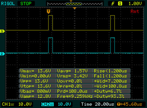

3.) i was solder 4nos signal wire from a printer, and connect to my oscilloscope and get some waveform reading.
1.) Address 1
2.) Primitive 1
3.) GND
4.) Power
Imgur
4.) according to above testing of a printer and cartridge, than i using arduino1280 and ULN2803A to made a pulse to firing up a nozzle, I have no idea why it don’t fire any ink ???
(see below pic is a waveform which generated by my arduino… i am not sure that am i need to making same waveform as reading from a printer ??? than i can firing up a nozzle ???)
Address 1 —> pulse 1
Primitive 2 —> pulse 2
GND —> GND
Power —> 13.5V (pull high : According to oscilloscope reading from printer,
power line always pull high when active Primitive line)
Imgur

tv7957ht: At the beginning i'm just working on a BLK cartridge 10N0016 first, which has 204 nozzles and with 600dpi resolution.
I think you mean it has 24 nozzles. I've one in front of me and it looks like about 25 * 2 connections to the nozzles. There are 42 connection points plus 3 round holes and 2 square ones. I think the holes are there for positioning the connection 'film' during manufacture. I notice that one side of the printhead connections is marked with a '+', suggesting that the other side has to be connected to ground.
Which connections have you identified?
