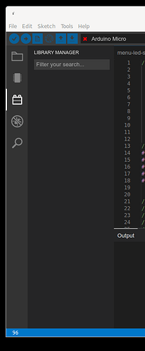

Just tried the nightly on Ubuntu 20.04. Library manager still doesn't work.
Hi @peteypops. Please provide a detailed description of what you mean by "doesn't work".
- What did you do?
- What were the results you expected from doing that?
- What were the results you observed that did not match your expectations?
Make sure to include the full and exact text of any error or warning messages you might have encountered.
This is on Ubuntu 20.04 with Cinnamon desktop.
Downloaded the beta .10, .11, the nightly build, whatever, they all do the same.
- Unzip in a folder as normal user
- cd to folder and ./arduino-ide
- Click on Library Manager icon
Expected result - I should be presented with some sort of information regarding libraries
Actual result -
The cli output is as follows -

root INFO Board config changed:
root ERROR Request installed failed with error: 13 INTERNAL: grpc: error while marshaling: string field contains invalid UTF-8
daemon INFO ERROR: 2021/08/26 19:47:08 grpc: server failed to encode response: rpc error: code = Internal desc = grpc: error while marshaling: string field contains invalid UTF-8
root ERROR Request list failed with error: 13 INTERNAL: grpc: error while marshaling: string field contains invalid UTF-8

This is the cause:
The Arduino IDE 2.x beta can't handle text that uses encoding other than UTF-8:
In that bug report, the problem was found to be the library.properties metadata file of one of the installed libraries. I notice that your error message is a little different though, so I don't know for sure that the problematic text comes from a library or somewhere else.
The workaround is to find the problematic library (or whatever) and then either change the encoding of the problematic file or else remove it if you don't have any use for it.
Unfortunately, the IDE doesn't give us any idea of where the file is so you'll have to find it by trial and error.
I would start by doing this:
- Open the Arduino IDE's File > Preferences menu
- Take note of the path shown in the "Sketchbook location" preference field.
- Click the Browse button on the right side of the "Sketchbook location" preference field.
- Create a new folder. This will only be used for a quick experiment, so it doesn't matter where it's at or what it's named. Just make sure it's empty so we can be certain that it doesn't have any effect on the IDE.
- Select the folder you created.
- Click the Choose button to choose the selected folder as your new sketchbook folder.
- Click the OK button to confirm the preferences change.
- Close all Arduino IDE windows (you must restart it to get it to recognize the folder change).
- Start the Arduino IDE 2.x.
- Open Library Manager
Do you now see the library list as expected?
If YES, then you now know that the problem is most likely one of the libraries that are located under the libraries subfolder of your original sketchbook folder. If you want to verify that, you can copy the libraries subfolder to your new empty experimental sketchbook folder, restart the IDE, and then check to see whether the empty Library Manager problem is back. After that, you can either start on a process of doing it one library at a time, or else directly check the character encoding type of of the library.properties file of each of the libraries until you find the non-UTF-8 ones.
If NO, then you know that the files in the sketchbook folder were not the source of the problem. The next place I would check is the /home/pete/.arduino15/packages folder, which contains all the Arduino boards platforms installed via Boards Manager. In addition to containing their own bundled libraries, these platforms also have metadata which might cause the problem if not UTF-8 encoded.
Excellent instructions thanks!
The offending item is this one - TimerFour - Arduino Reference
Removed it and the beta now starts as it should
You're welcome. I'm glad to hear it's working now. Great work on managing to track down the library that was the cause!
Hopefully some sort of a solution will be found to this soon.
