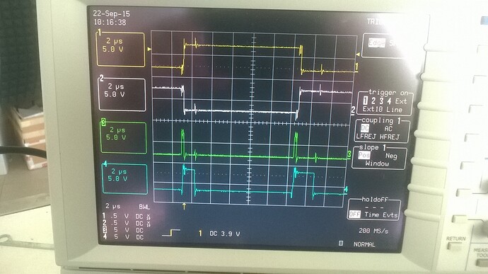

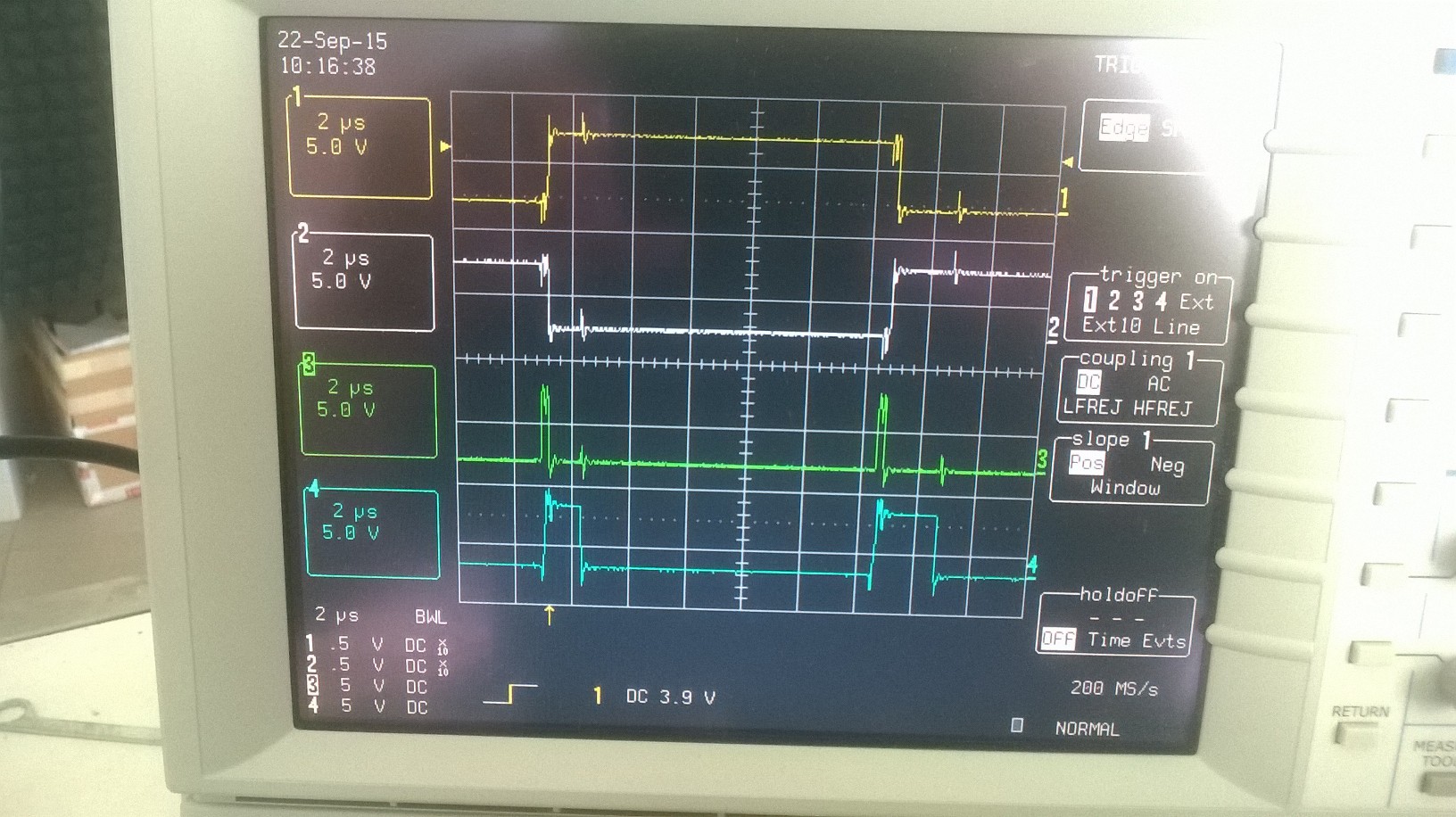

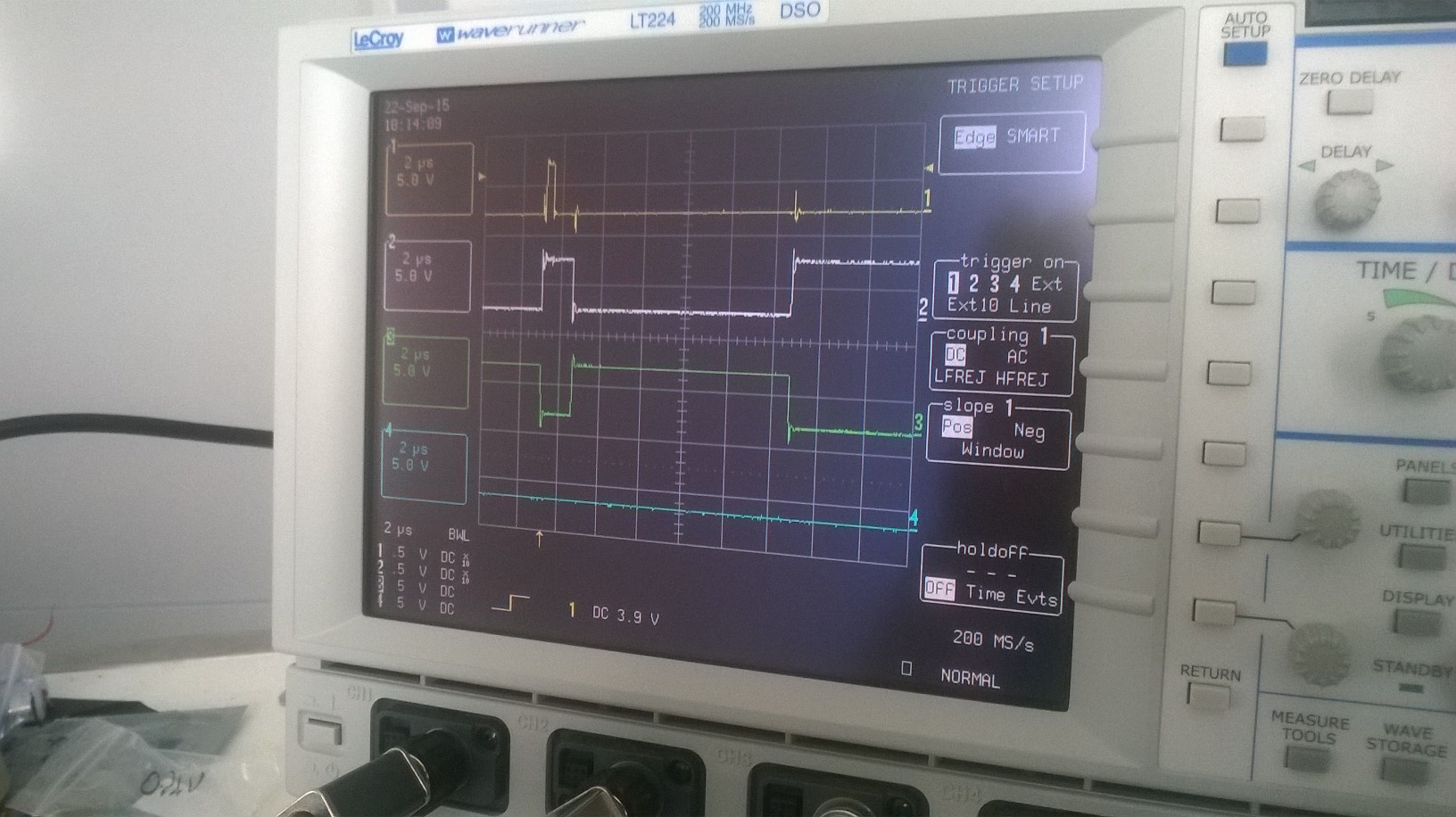

btw i got this sensor (TCD1201D) time ago and wrote an article about it (it works!)
picture details:
WP_20150922_002.jpg show signals SH, PHI1, PHI2
WP_20150922_003.jpg show signals PHI1, PHI2, RS, BT
WP_20150922_004.jpg show signals OS, PHI1, RS, BT
