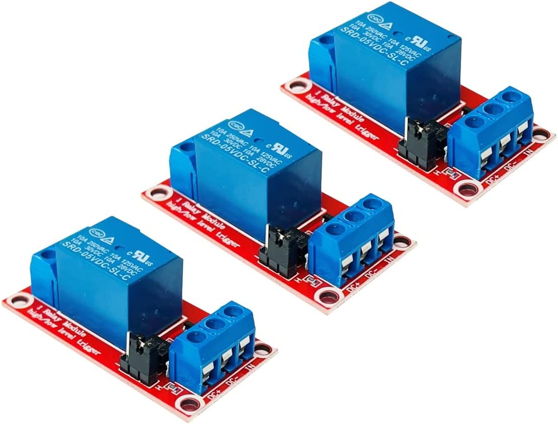

The Arduino will not make the fan work. You need to connect an Arduino output pin to control a relay compatible with Arduino. The relay will pass the 12vdc needed from a 12vdc power supply to the fan.
Let's draw a circuit.

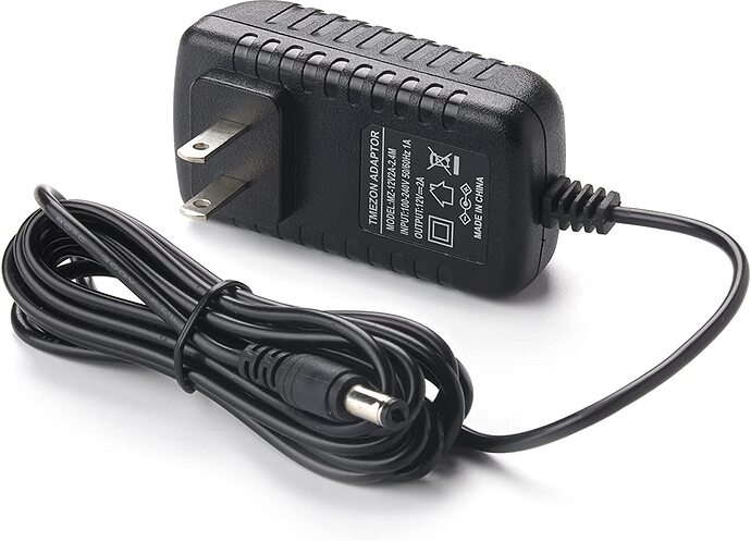

You are killing your Arduino - disconnect it from the fan. Arduino is a microcontroller on a 5vdc board, and not a power supply. Look at my drawing... the fan is powered by the power supply when the relay is energized when the load cell weighs more than "5" (you may change the weight to your choice). 12vdc is present on your computer's power supply (as are GND, +/-5VDC, +/-12VDC terminals).
Noted. What material should we use about the relay and power?

A fan using more volts means a bigger power supply. Cooling fans have a "cubic feet per minute" (CFM) rating that you will need to experiment with for your application (to keep it cool). Never power anything with an Arduino. Use the relay to pass the power from the power supply to the fan. Ensure the fan power requirement does not exceed the power supply output, and you really should not use 100% of the power supply output.

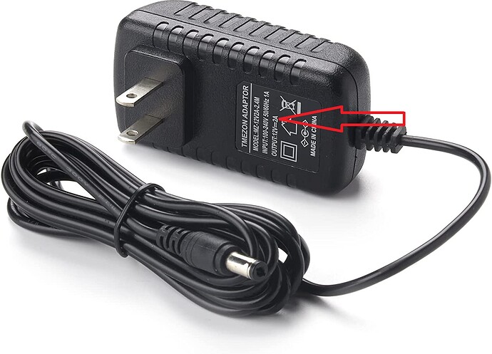

Noted sir. I was told by my teacher to use one Ac to Dc power supply for our Arduino and 12Ptc heater, are there material you can suggest to about this? He said about to make it parallel circuit to connect the power supply of both Arduino and heater since they are a different components of our product. And I would like to clarify if is it ok to power the Arduino with the 12V ac to DC through the power in Arduino or we need the back converter?
