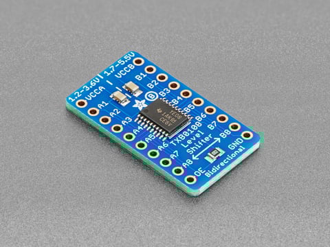

To clarify, I was looking at using this level shifter from Adafruit. The way that it is written, it sounded like it would work, but I guess that it's more for digital sensors:
Because the Arduino (and Basic Stamp) are 5V devices, and most modern sensors, displays, flash cards and modes are 3.3V-only, many makers find that they need to perform level shifting/conversion to protect the 3.3V device from 5V.
Although one can use resistors to make a divider, for high-speed transfers, the resistors can add a lot of slew and cause havoc that is tough to debug.
That's for digital signals only. 0.5-4.5volt indicates an analogue signal.

Yes, and I realize that now. I'm looking at setting up some voltage dividers instead.
That doesn't fix the fact that the output of the (ratiometric) sensor is now depending on three variables. A standard 10%-90% (0.5-4.5) sensor is designed to work with a 5volt processor with 5volt (VCC) Aref. You're trying to put diesel fuel in a petrol car. Expensive boards need expensive (digital) sensors. Good luck...
