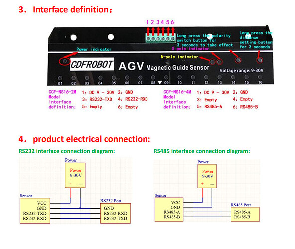

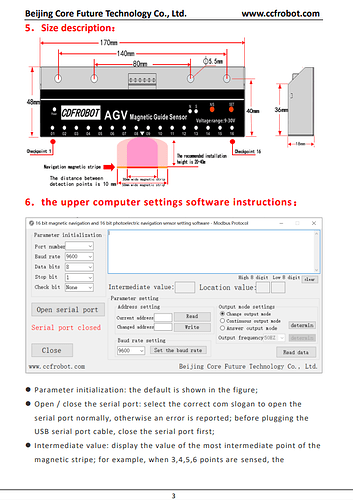

Hello , first of all i am new to this arduino world and programming. I am trying to build an AGV (automated vehicle) that is guided by a magnetic tape on the ground. I did my own research about sensors but i really need your help . So far i found some chinese sensors(i will post some pdf's below) that are similar to roboteq's famous magnetic guide sensor and also the Hall Effect sensors. Can the chinese sensors be incorporated with Arduino Mega for example and read the specific value of each sensor it has so i can tell the agv which way to go? Also do you think i can make the same type of sensor if i put 6 Hall effect sensors perpendicular to the magnetic tape and read the signals from each? Can Hall effect sensors read magnetic tape? I will post below some photos+pdf's about sensors(so beacuse im a new member i cannot upload here) .

I could not post an entire PDF with images and so on..
Here is the tape i am talking about
and this is the chinese sensor im talking about
also this one+
Much better, thanks. Hall sensors would certainly respond to that type of magnetic tape if the orientation is correct and the distance is small enough.
In order to predict success in advance, you need to know the sensitivity of the Hall sensor and the field strength of the tape as a function of distance and geometry. The fact that these items are designed for the purpose strongly suggests that you can make it work, so again, try it and see.
Spend some time studying the sensor manual to see what recommendations are made for operating conditions.
Thank you for your answer, i will first try with some Hall Sensors like these . I will connect 2 sensors for the begining to try and test them with the magnetic tape. It is a safer start rather than ordering a chinese sensor with RS232 interface from which i cannot read the signals.
You should not have a problem with reading RS232 signals.
If it is "true" RS232, with positive and negative voltage levels, you will need an RS232 to TTL adapter.
