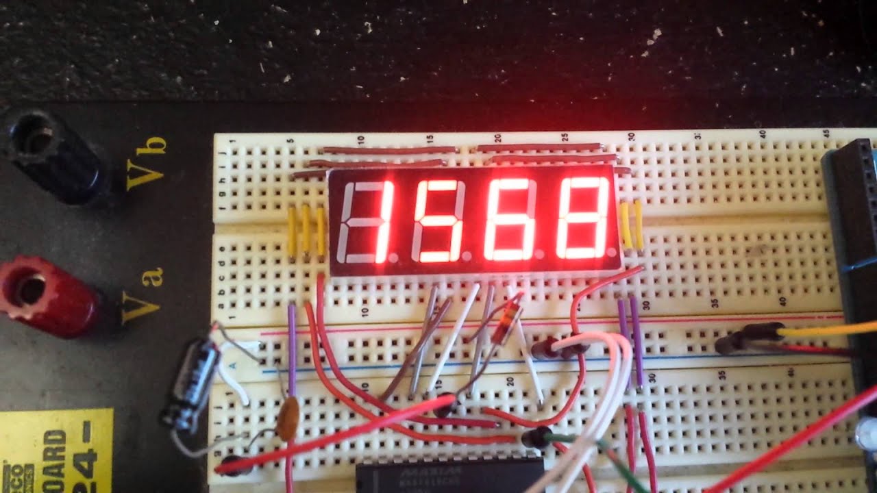

I'm creating a project using 7-segment displays and the max7219. To test the 7219, which I've never used before, I wrote a simple program to increment a number and output to the display every 20ms. My problem is that at 800 the program stops. Any ideas on why this happens? It doesn't matter if I start at zero or 500 or 750, it always stops after 800. Here's the code and a link to the video.

Sorry about that old chap, but I simply cannot replicate your problem (using a Pro Mini, which should be equivalent, and different pin connections).
Just for fun I ran it with five digits (note, actually a matrix display) and it seems to have jammed on the number "32760" which is of course, (more or less) the maximum value of a 16 bit signed integer.
But according to your video, it reaches "800" and then the display disappears.
I have to conclude that there is some glitch somewhere, but not in the code you gave.
I would suggest two experiments. Try pulling it down and re-wiring it, and/ or try my code to see where it gets to:

If it behaves differently, it may in fact be a RAM crash due to the library - it is mentioned that the library has some potential problems.
Thanks for the reply, Paul. I'd ordered a couple of the cheap fake max7219s and was using one of those in my circuit. Switched to the real $11 max and it works fine. Thanks for wiring up a circuit to test it.

And the video: 7-segment counter using max7219 - 3rd try - YouTube
Still no decimal point. Why would setting the digit2 (hundreds in my case) to true give me the dp when all the others are false? I guess my big questions is this: Why do the digits light up when I use false? I thought false was supposed to turn them off. The counter works when all were set to true. The counter also works when all are set to false. Why?
I know I'm close, and the answer is probably something obvious, but it has not revealed itself to me yet.
One other thing. Sometimes, but not always, when I load my sketch or add power to the arduino, all four digits flash 8's. I do not want this. Thanks again for your time and patience.
mauimark:
Because that parameter - if you look at the reference - is specifically to control the decimal, has nothing to do whether the digit appears or not. That would be another function in the library. Basically, the digits are all blanked when you assert "lc.clearDisplay()", and switched on the first time you invoke "lc.setDigit()".
My suspicion at this point is that the decimal does not appear because you have not wired it to the MAX7219. :astonished:
mauimark:
Ah, that's easy - though I have never bothered about it until now (but did notice it and ignored it) - and haven't seen it mentioned before either. Just put a 47k resistor from the Chip Select of the MAX7219 to Vcc. I just did this on my rig and it is a nice idea. :smiley:
Ah.
...you have not wired it to the MAX7219.
Oh.
Thanks for the tip. I still get a very dim blink on digits 0 and 1 at startup, but it's not noticeable enough for me to worry about. Good explanations and easy fixes. Thank you both for your input.
