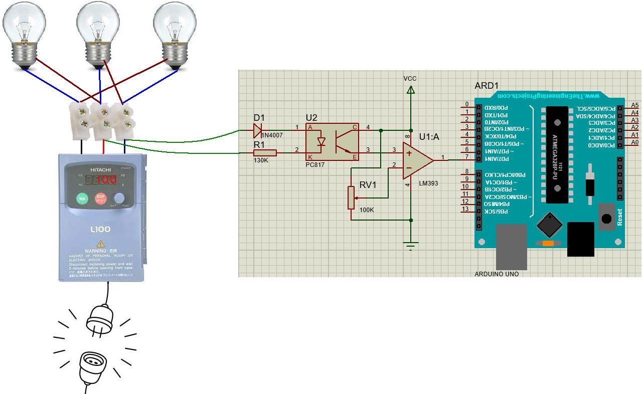

Hi!
I need to measure frequency on a power wires.
What i have: Arduino UNO, frequency converter Hitachi L100 (with 3 light bulb`s connected on a delta) and PC817 + LM358.
After LM358 signal looks like that (frequency 10 Hz):
IMG_000
I`m using standard code to function pulseIn(). (i have tried to pullup input pin. Wait LOW and HIGH signal...)
But on the serial monitor i have total garage. Random numbers, from zero to five thousand.
Question: what i`m doing wrong?

This is the code:
int pin = 7;
unsigned long duration;
  pinMode(pin, INPUT);
  duration = pulseIn(pin, HIGH);
  Serial.println(duration);
This the circuit:
Have you tried adjusting RV1? Have you scoped the Hitachi power outputs?

The 393 output is open collector, so you will need a pullup resistor.
Try an external 10K, the internal pullup may not be low enough.

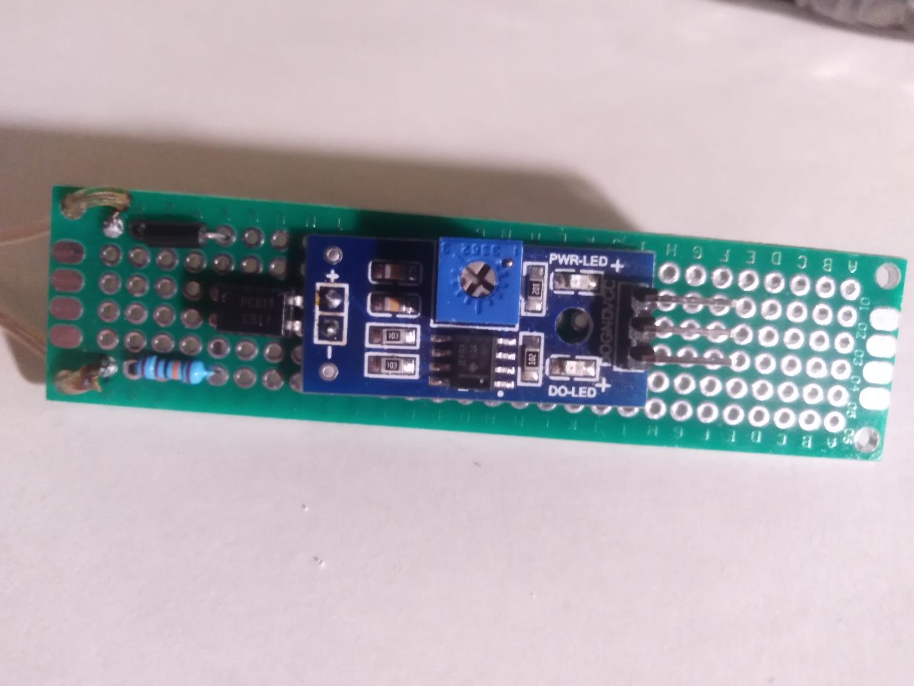

Not really. You seem to have modified an LDR sensor module. Please post all the details of the module and how you adapted it. I think we may be looking at this.
Light Sensing Module - LDR [4589] : Sunrom Electronics
Please post complete information about your project activities.
Please clear up the discrepancies. You mentioned an LM358 but the schematic you posted, and a subsequent reference to LM393.
If you are measuring frequency, wouldn't you want the time between pulses, instead of the duration of a pulse?

  3. 2 aarg: Yes. You right. But not LDR sensor module. Its NTC sensor module. And I check it on the oscilloscope. The scheme I described is the same to yours. (circuit that I draw dont have 2 LEDs, and R2 in my case is 100K. Also 2 filter capacitance).

Is there a ground connection between your modified NTC module and the Arduino?
I don't see one anywhere.
Yes.
I draw it in Proteus 8. And he doesn't draw power and ground in IC.
In real life I connected ground and VCC with Arduino.
It seems like you have done everyhing right but yet it is not working.
My guess is that here are very narrow noise spikes in the signal that won't be captured by the DSO nano scope. It only has a 200kHz bandwidth so narrow spikes that will trigger the UNO pulseIn input may not be seen on that scope.

Could be a narrow 0 to 4V pulse that your scope can't capture
