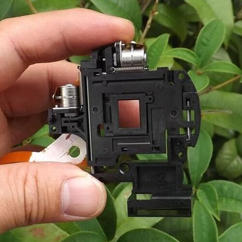

Yesterday I leaned that microstepping is easy to program, but equal sized steps are hard to do with two-axis microscope sliding-table 5V bipolar stepper motors. I looked at scene with high precision microscope for that:
https://forum.arduino.cc/index.php?topic=691123.msg4673372#msg4673372
I used L293D driver for the stepper motor. I read a lot that there are better drivers like A4988, and today I used that with my only NEMA 17 stepper motor:
Reason is that minimal voltage of A4988 is 8V, and I am not sure what the tiny stepper of sliding-table rated 5V does when powered with 8V. I will do that experiment later (I have three 1.60$/pc sliding tables already, and did order 10 more some time ago).

But I want to add micro-stepping to the tiny stepper motors of my 1.60$/pc two-axis sliding table that provide 5µm steps per half-step. They are rated 5V and "current about 100mA" (my constant voltage power supply did measure 84mA). The question is, can I power these tiny steppers with A4988 with 8V (or more)?

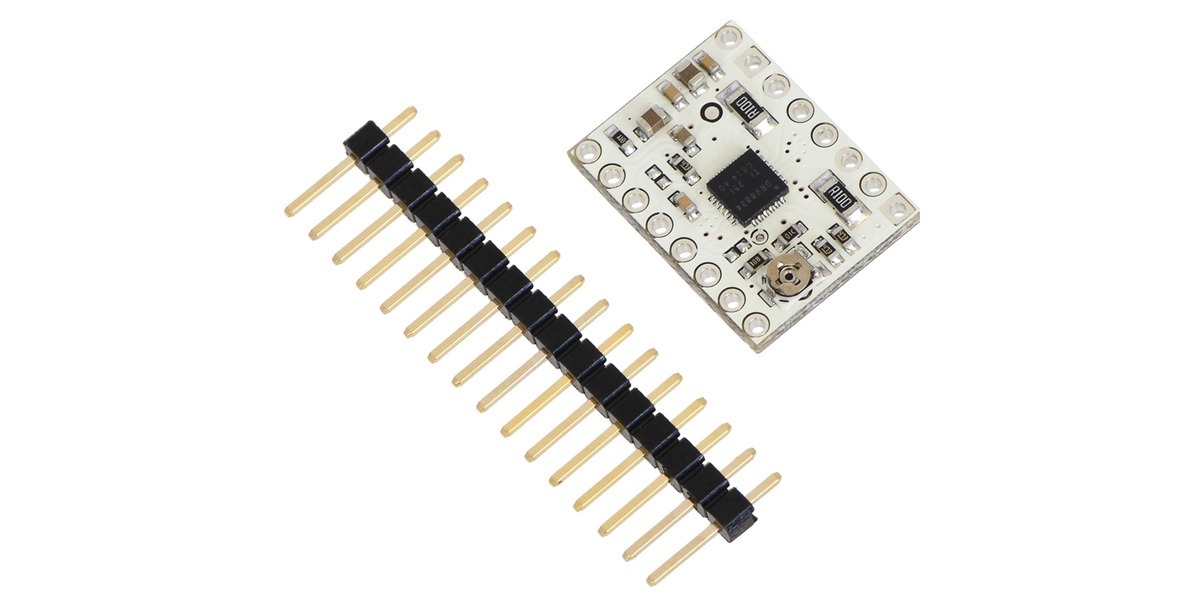

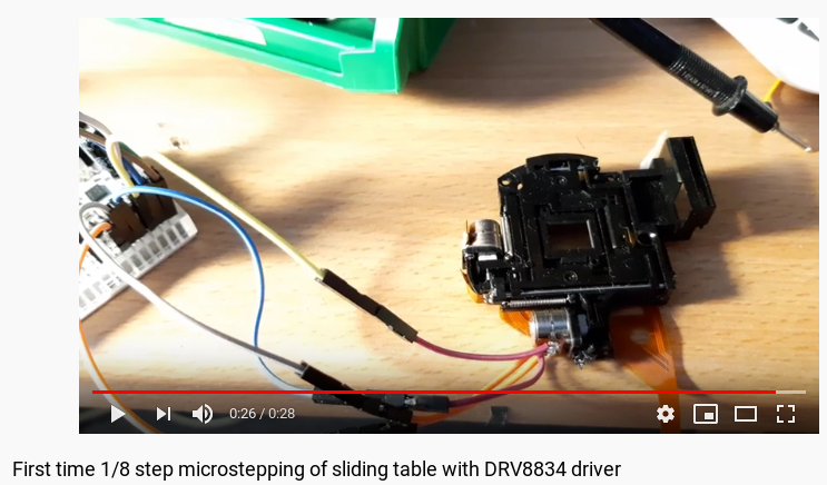

I received Pololu DRV8834 low voltage stepper driver yesterday:
Since output range is 2.5..10.8V, I just did use Arduino Uno 5V as VMOT.
I did set VREF=50mV for current limit of 100mA.
And it really worked, I used 1/8 step and sliding table did move from left to right, and then from right to left with 8*250=2000 1/8 microsteps:
Tomorrow I will connect DRV8834 driver to the x direction stepper motor of existing sliding-table with micrometer on top. Under microscope (with 0.21µm/pixel resolution) I will see whether the spacing for single 1/8 microsteps is uniformly or not (1/2 microstepping had 5µm wide steps, so expected step width for 1/8 is 1.25µm(!)).
Even better, DRV8834 allows for 1/16 and 1/32 as well ...
