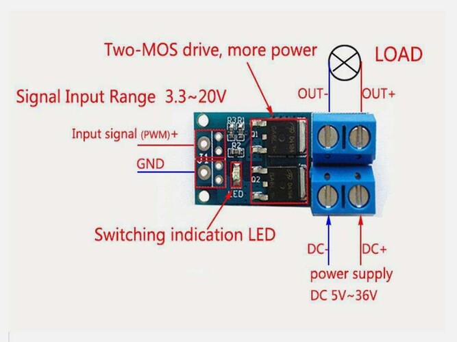

I am looking at using a MOSFET Module to switch a load from a Radio controller; transmitter. The signal from the Transmitter is PWM, Can I connect the signal pin directly to the Receiver or do I need to use an Arduino. Any help would be much appreciated.
The module is shown below:
What type of PWM? Radio controllers often output a particular type of PWM intended to control servo motors. This will work with MOSFET modules, but will only give a small range of control, like 10% to 20%. You may need the full 0% to 100% for your MOSFET module.

Yes, you will need an Arduino to do what you want.
An UNO or Nano would do

Many thanks for your speedy reply, not sure what type of PWM signal, and I have tried to find out but no joy as yet. All I know is that the pulse has a minimum of 1000 microseconds and a maximum of 2000 microseconds. My initial thought was to use an ATTiny 85 to process the PWM pulse and dependant on the length of the signal, switch on or switch of the load, but when I saw that the module could handle a PWM signal, I thought I could do away with the ATTiny 85.
No you still need the ATTiny85

That is easy to do.
  • read the pulse width.
  • if the pulse width is less than some value turn the load off.
  • if the pulse width is higher that some value turn the load on.
I think you knew that from the very beginning.
