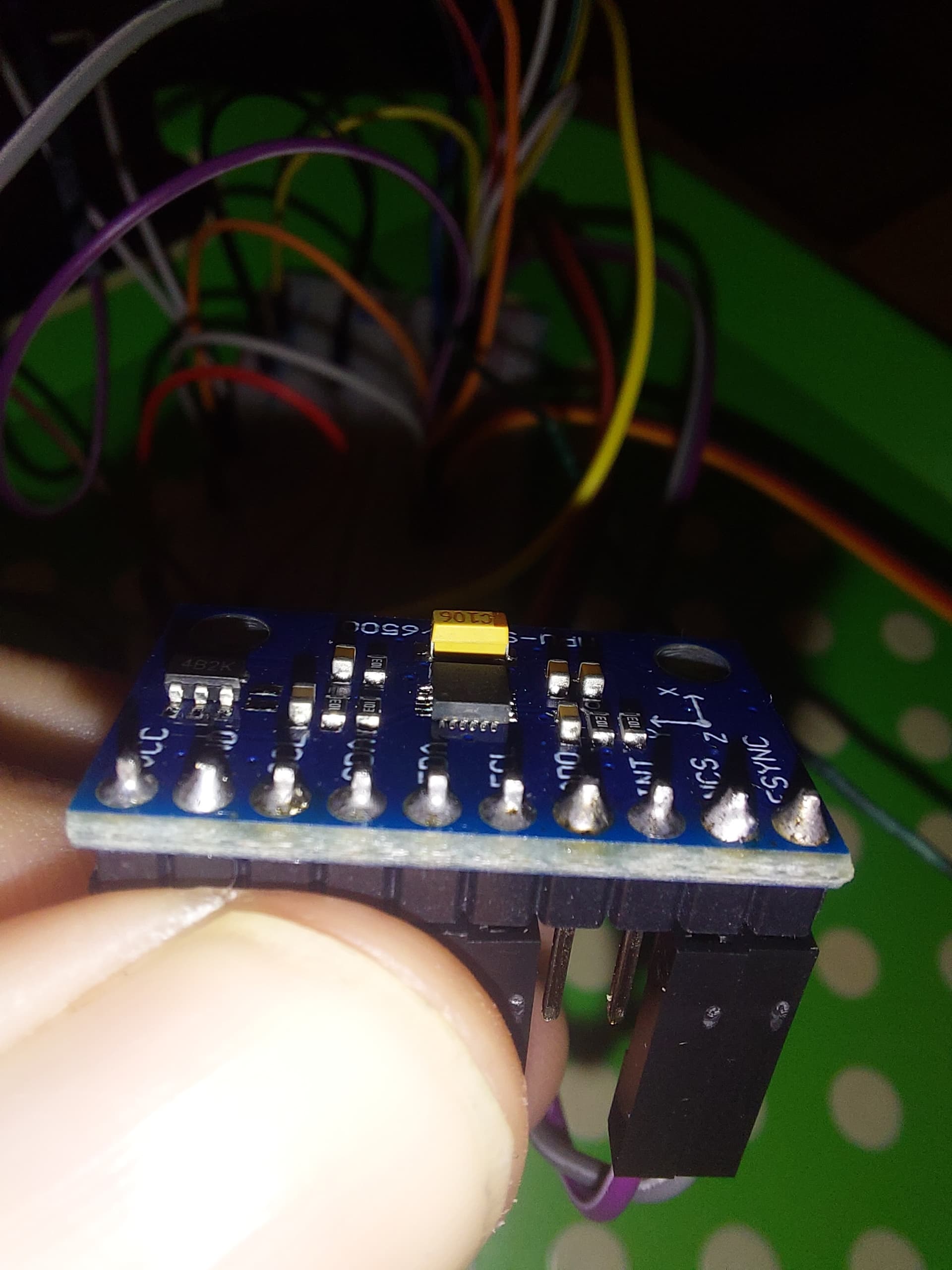

. Did I solder it badly or it is a bad wiring, it is supposed to light up a red led when it works no ?
Well, more problems.

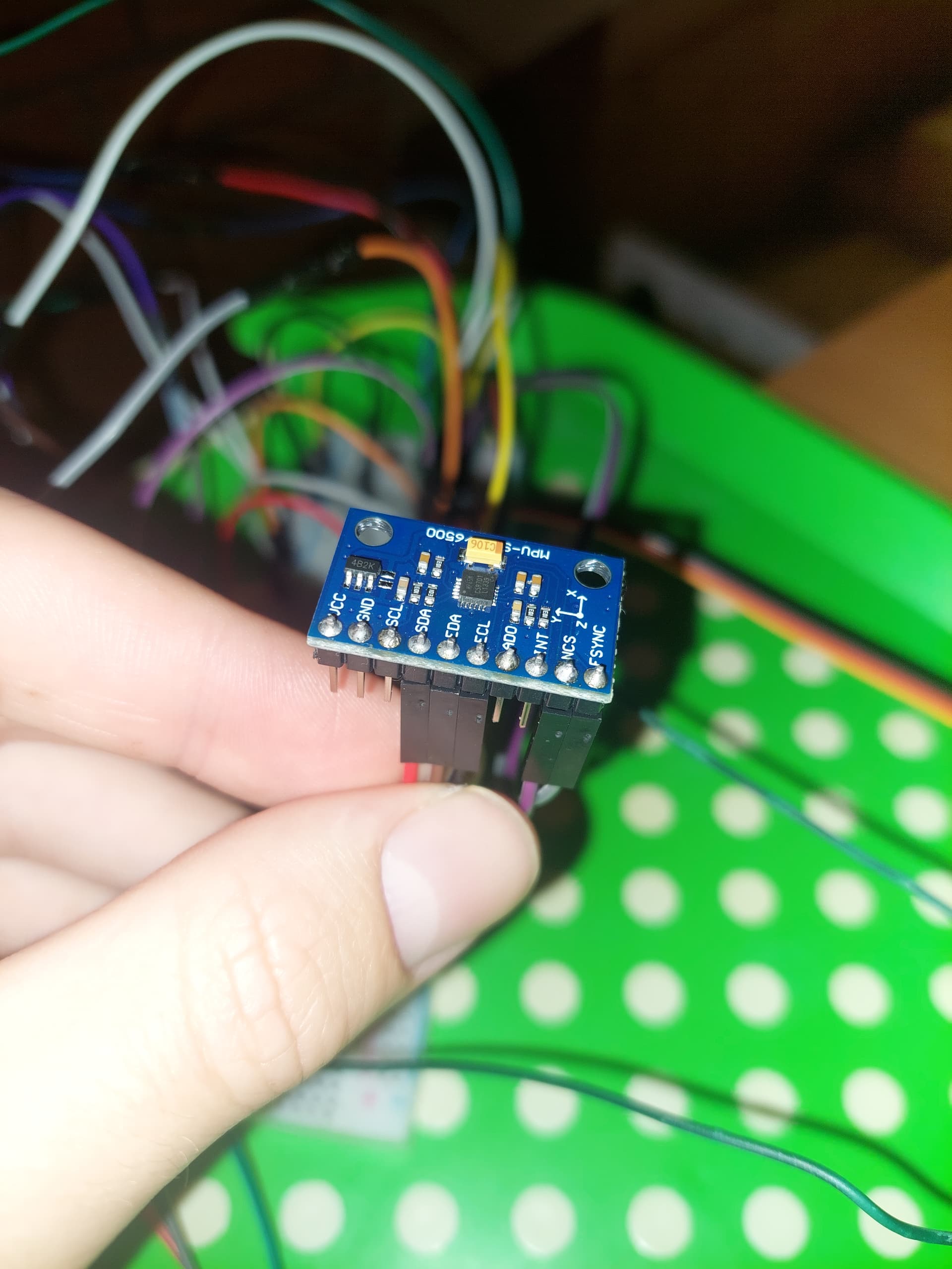

  1. Looks like the code is written for the older MPU6050 and not the MPU9250 that you have.
  2. The I2C interface is 3.3V. Normally that would not be a problem but you already have the LCD connected to the I2C and it uses a 5V interface.

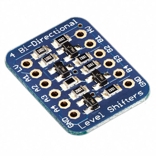

You could buy a 3.3V to 5V voltage tanslator to fix the voltage difference problem but I don't know anything about code for the MPU9250
Ah I see, thankfully I also have this version, I just need to solder it:
When I solder it, what pins should I connect besides GND and VCC ?
The code may work but we still have the 3.3V and 5V problem.

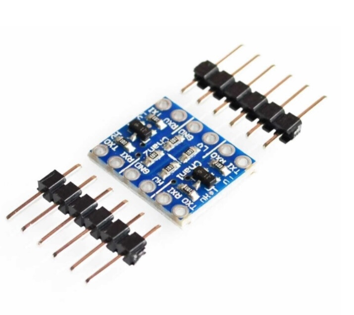

Ok could you provide me a image of what voltage translator best fitting for my situation ?
I found this:
this one is 2 channel is it enough ?
Be careful!
There are some fake ones on the internet and I think that is one of them
Here are three good ones
You may find them on Amazon and other places
Also don't buy this type

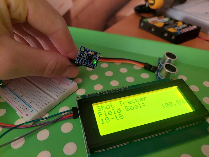

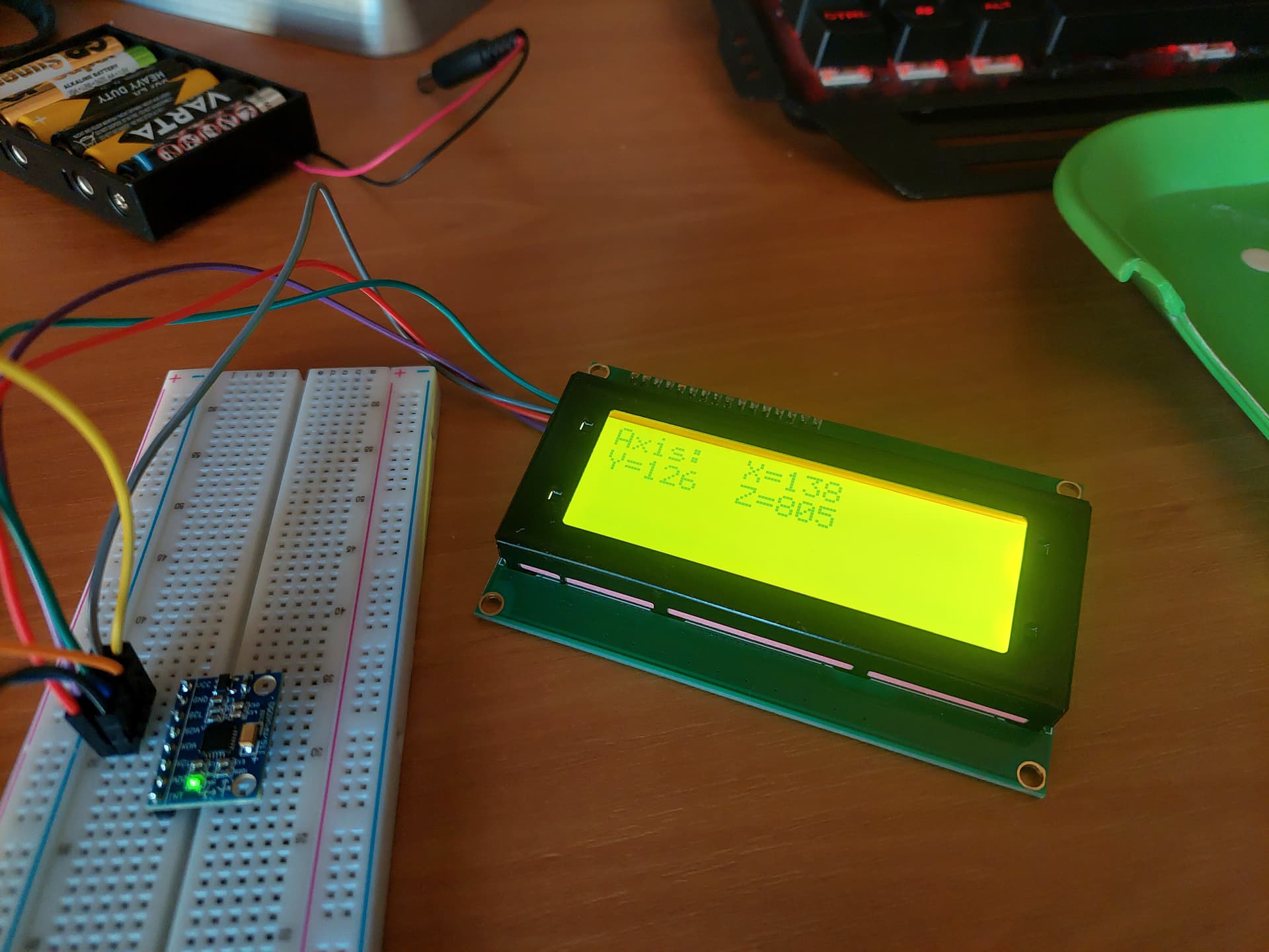

I also tested the mpu6050 sensor and its working :

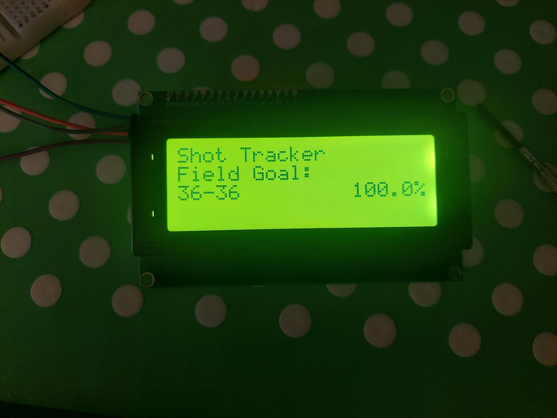

The problem now is hc-sr04 sensor is counting a scored hoop almost every second without movement(its too sensitive?) and a mpu6050 sensor is doing nothing.
How did you conect the MPU6050 wihout a voltage translator?
Which Liquid Crystal library are you using?
  1. I connected MPU6050 like this : VCC to 3.3V
    GND to GND
    SCL/SDA with LCD display to A4 and A5
    ADO pin to breadboard VCC MPU6050 pin
    It lights up a green light.
2.I use this library:
NewLiquidCrystal-master.zip (2,2 MB)
Leave that disconnected, see if it works.
Still the same thing mpu6050 is on, but it dosent do anything and the hc-sr04 sensor is counting without movement. I think there is a problem in code that makes mpu not active.

  float ac_y = float(AcY/16384);
  float ac_z = float(AcZ/16384);
  double duration, distance;
  digitalWrite(trigPin, HIGH);
  delayMicroseconds(12);
  digitalWrite(trigPin, LOW);          //Inputs on Ultrasonic distance sensor
  duration=pulseIn(echoPin, HIGH);
  double dist = (duration/2.0/29.1);         //Calculation for distance
  if (dist < 22 or ac_z < (normal_z - toll) or ac_z > (normal_z + toll)) {
    count_shot += 1;
    if (dist < 22) {
      made_shot += 1;
      delay(2000);
      bool flag = 0;
      double time1 = millis();
      double time_diff = 0;
      while (flag == 0 and time_diff <= 2000) {
        if (dist < 22) {
          made_shot += 1;            //Calculation for whether shot actually went into hoop
          flag = 1;
          delay(2000 - time_diff);
        double time2 = millis();
        time_diff = time2 - time1;
//      int extra_time = 2000 - time_diff;
//      delay(extra_time);
//    Serial.print("Field Goal: ");
//    Serial.print(made_shot);
//    Serial.print(" / ");
//    Serial.println(count_shot);
//    delay(1000);
    if(count_shot > 0) {
      field_pct = made_shot / count_shot * 100;      //Field Goal % Calculation
      field_pct = 0;
    lcd.clear();
    lcd.setCursor(0,0);
    lcd.print("Shot Tracker");        //LCD display intially
    lcd.setCursor(0, 1);
    lcd.print("Field Goal:");
    if(made_shot < 10) {
      lcd.setCursor(0, 2);
      lcd.print(made_shot, 0);
      lcd.setCursor(1, 2);
      lcd.print("-");
      lcd.setCursor(2, 2);
      lcd.print(count_shot, 0);
    } else if(made_shot < 100 and made_shot >= 10) {
      lcd.print("-");
      lcd.setCursor(3, 2);                                       //LCD Print field goals made / attempted
      lcd.print("-");
      lcd.setCursor(4, 2);
    lcd.setCursor(19, 2);
    lcd.print("%");                                    //LCD print % sign for field goal percentage
    lcd.setCursor(14, 2);
    lcd.print(field_pct, 1);
  //field goal percentage logic
//  Serial.println(field_pct);
  //lcd code
//  LiquidCrystal_I2C lcd(0x27, 2, 1, 0, 4, 5, 6, 7, 3, POSITIVE);
  //reset button code
  button_pos = digitalRead(button);
  if(button_pos == 1) {
    lcd.clear();
    lcd.setCursor(0, 0);
    lcd.print("RESET");
    made_shot = 0;
    count_shot = 0;
    field_pct = 0;
    delay(2000);
    lcd.clear();
    lcd.setCursor(0,0);
    lcd.print("Shot Tracker");                //LCD print for if reset button is pressed
    lcd.print("-");
Wow Jim, the hc-sr04 sensor works perfectly now. Only problem now is that the mpu6050 dosent count misses but acts as a second sensor (it counts makes not misses when I touch it). Is there a fix for that ?
