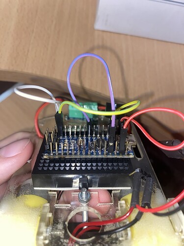

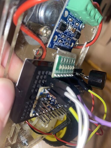

I am very very new to this, but I want to learn using Arduino, and I had a Chinese Arduino at home, so I tried to use it. Everything went good, I could use the "speaker", and I could use the Built-In LED on the board, but when I tried to use the not Built-In LED it went wrong. At first(pic1,2,3)
when I uploaded my program to the board it worked kinda..,the speaker worked and the LED worked, but not the way I liked it. This LED has 6 LED in it, the 6th LED worked the way I programmed it, but somehow the 1st and the 2nd LED lighted up, but I only programmed the 6th to light up. I thought thats beacuse it's to close to the board so I moved the board a little bit further back.(pic,4,5,6).

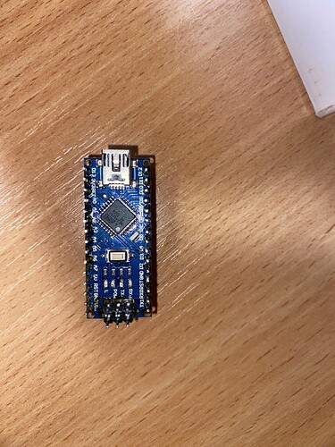

It went wrong when I plugged it in a little bit of smoke come from it, so I immediately unpluged it. Now I stripped all of it and I tried to use just the board, but my PC can't recognize it. I tried to use different cables, but nothing, the power LED is glowing just a little bit. I know it's my fault, but I am trying to understand what did I did wrong. I think I can't use this board anymore. I will buy another board someday, because I liked doing it, but I will read more about it so this will never happen again. So can somebody tell me what did I did wrong(I did everything wrong), so it can never happen again.

It would be unusual, but does the arduino have long enough pins on the bottom to actually plug into the breadboard (usually the pins are only long enough on one side of the board, but your board may have "stacking" headers with long pins on both sides). If so, then you are connecting pins of the arduino together with those jumpers.
What @david_2018 said. Could be that the board is just resting on the breadboard.
Being curious, what is the purpose of the white jumper?

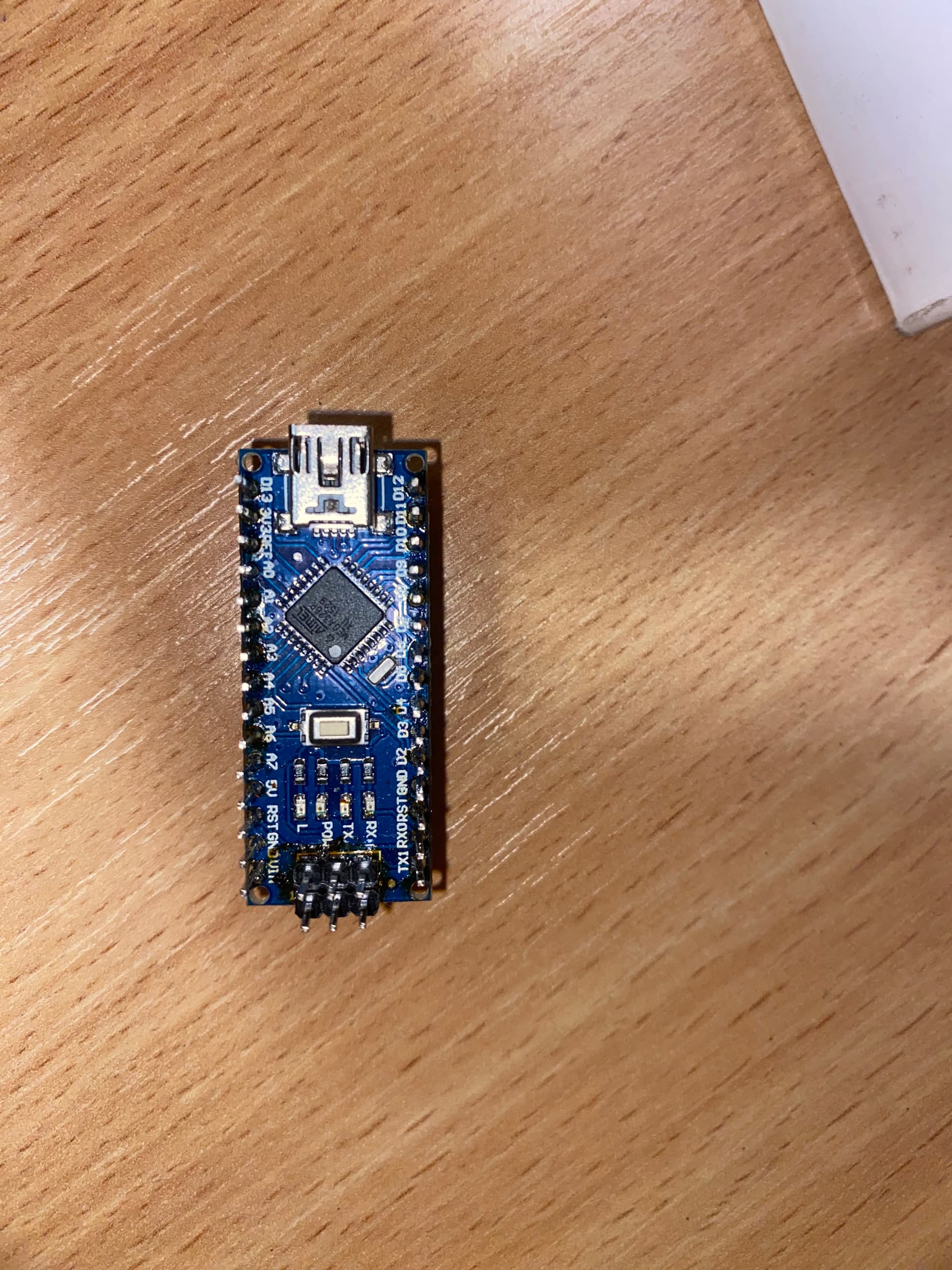

My Arduino looks like this:
and my jumper is a Male to Male jumper and because my ground was taken by the speakers jumper, I tried to ground my led as well so I sticked my male to male jumper in front of the ground. As I said I am very beginner in this topic.

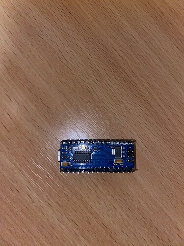

you probably drew to much power from it and fried the voltage regulator under the board.
Can you shear a picture of the under side of the board?

The wiring around the "speaker" is likely a problem.
In case you don't understand how the breadboard works, each row of 5 holes is wired together, so when you insert the arduino, the pin connections extend outward to the edge of the breadboard throughout each row. As an example, in the pictures your yellow wire is connecting GND to the REF pin as well as the speaker ground.
I can’t take a good photo of it, but nothing looks burned or fried.
Oh, thank you, I didn’t knew that!
sorry can you take one of the top
try to connect it to your pc again because nothing is fried at all
