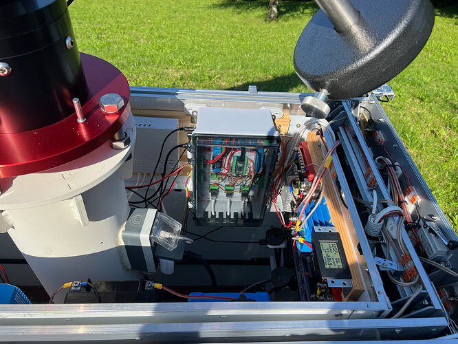

Built the controller for my self-built telescoping telescope shell ("Observatory") with Arduino Micro from the scratch :wink:
Arduino closes observatory when it rains, when it's windy, when power fails, when computer crashes (watchdog) and communicates with (a) telescope mount hardware and (b) computer ASCOM drivers via serial ports

I at first assumed that the enclosure was for a remote observation setup, but the (presumably) electrically heated coffee cup calls that assumption into question.
eventually, everything turns out to be a cup holder :grin:

this is a 10" Newton telescope - quite a "standard" for serious amateur astrophotography. Not really practical for visual observation with the eyes (you would have to make serious yoga on a ladder to look through), it's optimised for photography, the red thing is the astrocamera cooled to -10 °C
