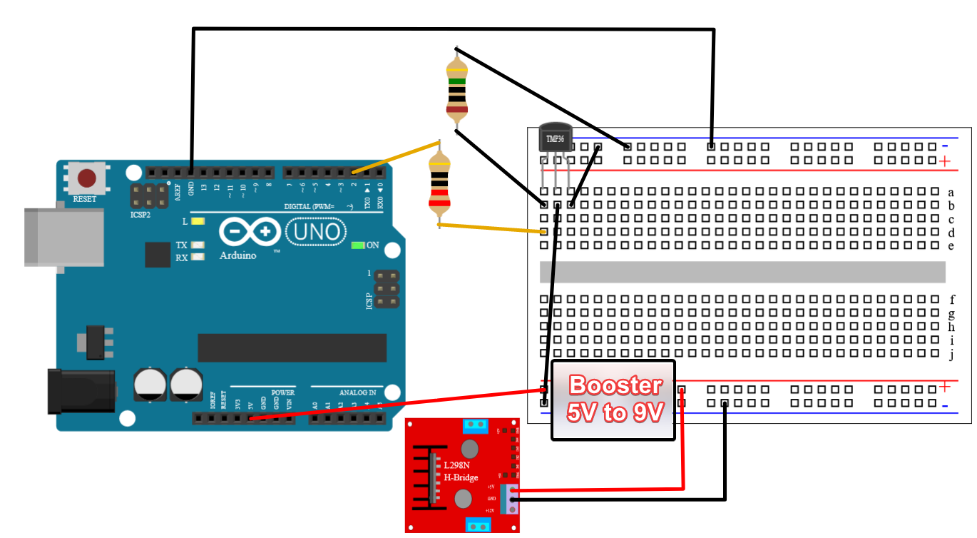

I wanted to control a solenoid (the M) using the 3.7V battery but with this configuration I get a voltage drop of about 2 volts between D and S even if the load is not connected.
Using an external battery the circuit works and I don't have any voltage drop. I don't understand why using the same battery to power up the esp and the solenoid this isn't working out the same.
EDIT: I found the problem and it was the wiring of post #13: I plugged the load to source instead of drain.

When I'm replacing the LED with a Mini-L298N (h-bridge motor driver) the MOSFET stays always on. Between the L298N and the MOSFET there is a voltage booster 5 to 9V.
Ignore the 5V input of the motor driver, the Mini-L298N is a little bit different:
As for N channel MOSFET the Source should be tied to GND.
See first picture here: Resistor configuration on MOSFET high side/low side switches
Although the used FDD8447L is a logic level MOSFET, 3V3 coming from ESP32 might be not enough. If you look at the datasheet the Vgs threshold voltage can be as high as 3.0V. That is where only 250uA Ids can flow!
Moreover with 3V3 Vgs voltage the MOSFET is below it's ZTC point, thermal instability can occur!
You should really reconsider your circuit!

Do you see the voltage divider that reduces the gate voltage?
The pull down resistor should sit on the output pin, not at the gate.
The voltage reduction would be small but you're right

Just tested it out with an Arduino Uno connected via USB. The 5V out drops about 2.2 volts from drain to source in this configuration. (the mosfet is GSD, not GDS)
Instead of the motor I placed the multimeter.

Now, can you please post a copy of your circuit, in CAD or a picture of a hand drawn circuit in jpg, png?
In particular, label the gate, drain and source pins, cut and paste images do not show everything.

I'm not powering any motor that was just an example to monitor the voltage drop I'm experiencing. You can replace the motor with an LED.
By the way I found the problem and it was the wiring of post #13: I plugged the load to source instead of drain.
This is the correct and finally working wiring (ignore the lack of resistor to the LED):
I'm now experiencing another problem though.
When I'm plugging an LED it works fine with a simple blink sketch to pin 2.
You seem to heave a very jumpy target :wink:
What's the purpose of the MOSFET now?
The MOSFET enables power to the H-bridge. I need this on/off configuration because the H-bridge dissipates power when powered and of course this is not acceptable in a future battery powered configuration.
