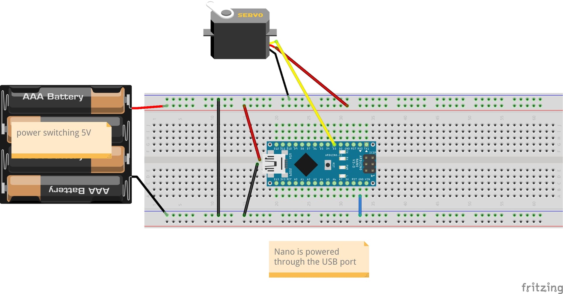

Hello. I have 12 nanos each one drive a servo (SG996) with basically sweep's example. They are powered all together with 5V 5A power switch. Sometimes one or two servos stop working. If I turn off and on again, they will start. What's the problem?
The servo power supply should be rated for 1 Ampere per (small) SG90 servo, 2.5 Ampere per (large) MG996R servo, minimum.
So the power supply should be rated for 12 to 30 Amperes, minimum, for 12 servos.

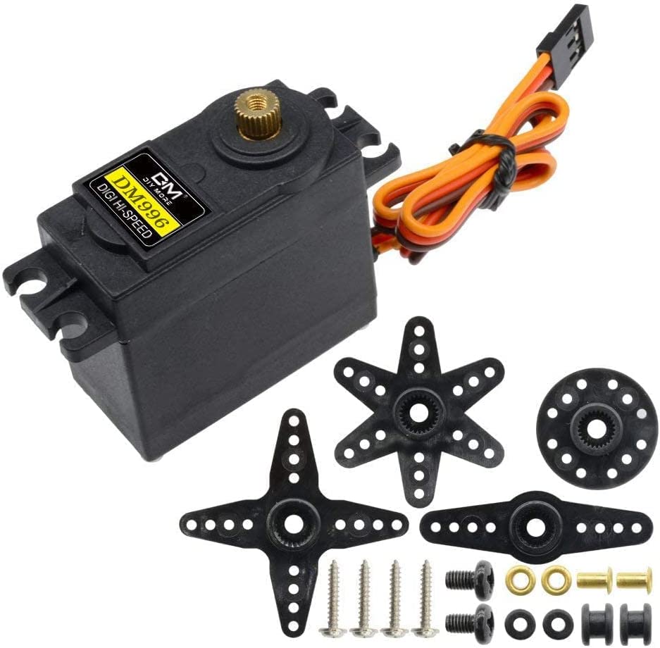

Please post a link to the data sheet or product page for servo you actually have.

Can we please have a circuit diagram?
An image of a hand drawn schematic will be fine, include ALL power supplies, component names and pin labels.
My nano are some simple animatronics. They are some birds made with umbrella parts. Servo will fold and unfold while they are powered. I need a random begin delay and a random delay into for loop for create diversity betwwen each birds.

Servos are diymore MG996. I didn't find official datasheet but I think are equal to DM996R.
Into the shop page I can read:
  • Operating Voltage 4.8V-6.0V
  • No Load Speed 0.18sec/60°(4.8V),0.15sec/60°(6V)
  • Running Current 160mA(4.8V),170mA(6V)
  • Peak Stall Torque 9kg.cm(4.8V),13kg.cm(6V)
  • Stall Current 1100mA±10%(4.8V),1300mA±10%(6V)
  • Command Signal Pulse Width Modification
  • Amplifier Type Analog Controller
  • Pulse Width Range 500~2500usec
  • Neutral Position 1500usec
  • Running Degree 180°±3°(when 500~2500usec)
  • Dead Band Width 8 usec
  • Rotating Direction Counterclockwise (when 1000 ~ 2000usec)
That being said, I would say you're right :no_mouth:

If you power all 12 Nanos at the same time and they all attach their servo at the same time, what will the current draw be? 12 times 1.1 Amps = 13.2.

You are right! Why it "works" with 5V 5A...?

I solved using a 5V 40A switching power supply.
You will need to fit fuses to each Nano circuit and a main fuse to the output of the 40A power supply.
If you have a short anywhere in your project, the power supply will try to put 40A through it.
This is enough to basically blow your Nano's, or servo's and or wiring to the gods.
