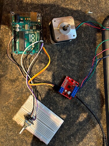

Nema 17 with Big easy driver, jittering
Hi, I have a encoder and stepper motor set up to control the rotation of the stepper motor. But it only jitters and doesn't move in any directions. Any idea?
Im using Nema 17
Im using 12V 2A power supply
Im using Sparkfun Big easy driver!
https://learn.sparkfun.com/tutorials/big-easy-driver-hookup-guide/all#introduction

Likely wiring or software, but as you have not provided clear details of either it is hard to tell.
While long shot pictures of the kit give a general overview, it's basically a mess-o-wires and not very useful to identify missed connections.
Three of many possible mistakes are that you forgot to set the motor driver current limit correctly, the driver cannot handle the required current, or the power supply cannot provide the required current.
Post a link to the stepper motor product page, or the exact model number.
The driver looks like an L293 and might the wrong kind. The stepper datasheet will tell necessary data.

Did you already try to swap one of the motor coils (! remove power before doing that).

I dont have it unfortunately... Is there a way to check using a meter?
The picture tells a different story in my eyes.
You don't have what?
Yes, you can check motor coil resistance with a DMM.
Motor coils should only be a few ohms if you want to use that supply and driver.
A 30 ohm stepper motor is no good.
Report back.
Leo..
You can measure the stepper coil resistance. That might give us an indication.
The link in the first post shows the sparkfun big easy driver, and that is definitely what is shown in the picture.
What is missing are the specs of the motor and and a schematic how everything is wired.
Even though it says "BigEasyDriver" on the PCB?
Isn't that just another board version of the A4988 (1Amp without heatsink).
Leo..
That sounds like a selling name, not a technical description. Look a the circuitry!
Of course, but you can compare the picture in the link with the picture of the OP to confirm it is the same board. Only because it is red and has blue screw terminals it doesn't have to be a L298 board. The L298 chip is much bigger than the chip on this board. As @Wawa already suggested its simply another A4988 board.
