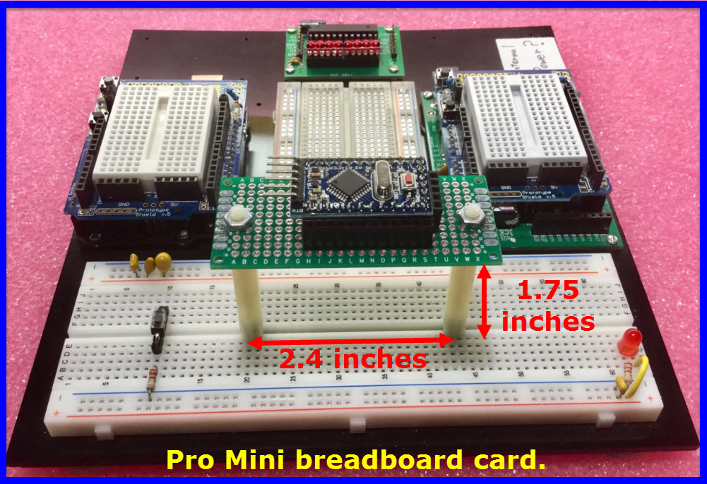

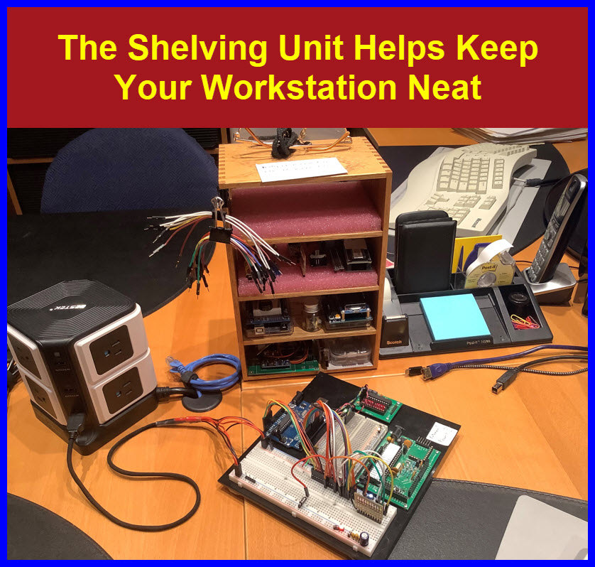

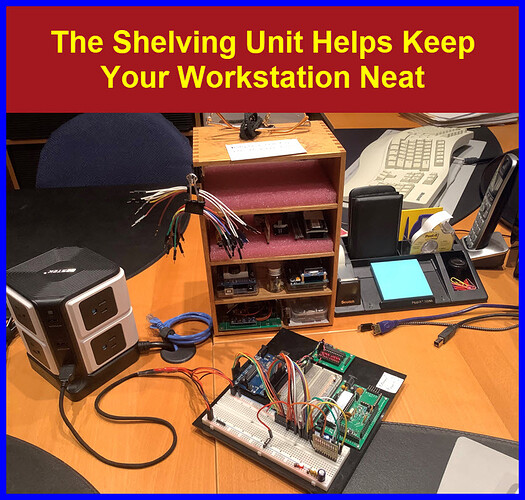

So now, on to my first question for these forums, and I imagine it should be a simple one for you guys: There doesn't seem to be a whole lot of options for mounting the UNO or Mega 2560, along with a small breadboard. I'd like a stable, but small platform that would make transport easy. The ones I've found on Amazon are for combo Arduino/Pi, with a larger breadboard, and are more bulky than I'd like. Any ideas? What solutions have you come up with?
What I use.

I usually take a piece of plywood, paint it white then mount the hardware generally with SS #2 sheet metal screws. Works OK and stays together. Sometimes I have to add the plug board to it. I purchased a bunch of Dupont connectors and make my cables, not singles going every which place. I cheat and Purchased a bunch of them that come on a piece of ribbon cable. I remove the singles and put them together as I need.

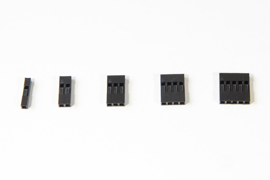

More importantly, swap the single shells for an appropriate multi-way shell.
@Railroader Why do you say drop the breadboards? I'm not building permanent circuits at this point. I just want to build a testing platform. There may eventually come a time when I want more permanent circuits.
@LarryD Wow, that looks like a fairly advanced setup! Maybe I'll be in the market for something like that at some point. Yours looks nice.

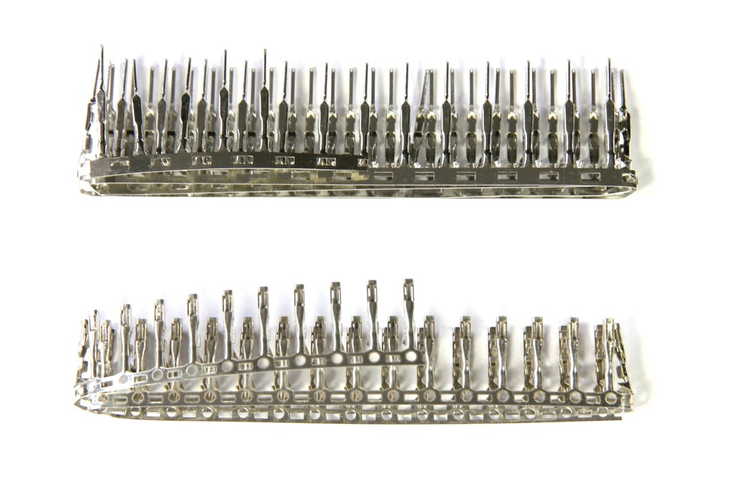

I don't mind building my own dupont cables. Is there a good, reliable source for the parts?
From #3: They quickly introduce intermittent contact when being moved. As You ask like below...
If any motors will be used breadboards are not designed for such currents.
Do you have an alternative solution that doesn't require soldering?
Options:
get a good crimping set to crimp power carrying wires;
similarly, crimp your own smaller, signal wires to the metal connectors and insert them into multi-way shells. Caveat: fiddly work.
Crimping done well is quite reliable.
Otherwise, if just prototyping, use the breadboard for non-power connections, and connect power wires to screw terminals if available on the device needing power. As long as the Arduino board is not the source of that power.

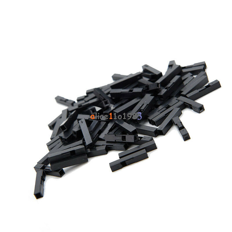

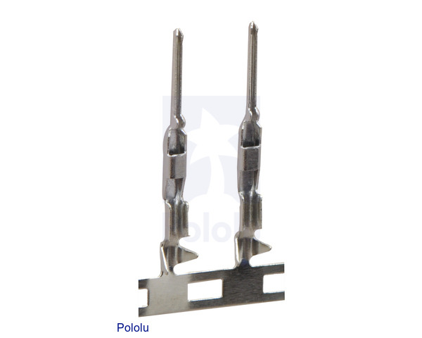

You can get 1000 male/female Dupont pins on eBay for about $7.00.
Also the plastic shrouds/housings are there too.
Pololu sells this stuff too.

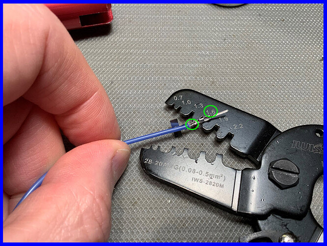

My favourite is:
Platinum Tools 16801C Open Barrel Contact Crimp Tool Clamshell
These are what I use with percentage of times I use them:
First crimp the conductor
Finally crimp the insulation
Might have to tune remove some insulation with flush nippy cutters and tune with needle nose.
The Platinum Tools 16801C Open Barrel Contact Crimp Tool Clamshell IMO is the best.
Thanks for sharing :slight_smile:
When using the 16801C, after crimping the "insulation" on the largest size, I finish with a very light final crimp on the smallest size.
Double over the conductors on 26 and 28 AWG wires.
I mostly use silicone insulation wire with high strand count; 28 AWG has sixteen 40AWG strands.

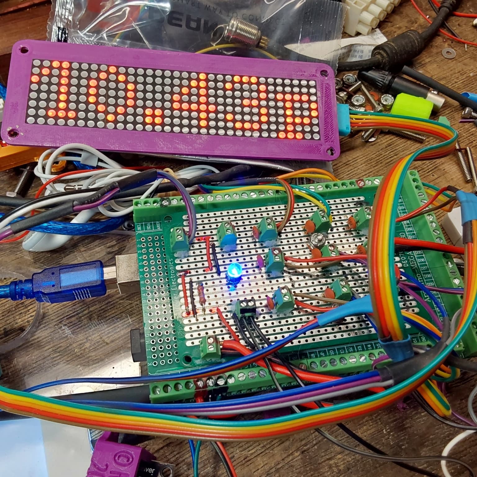

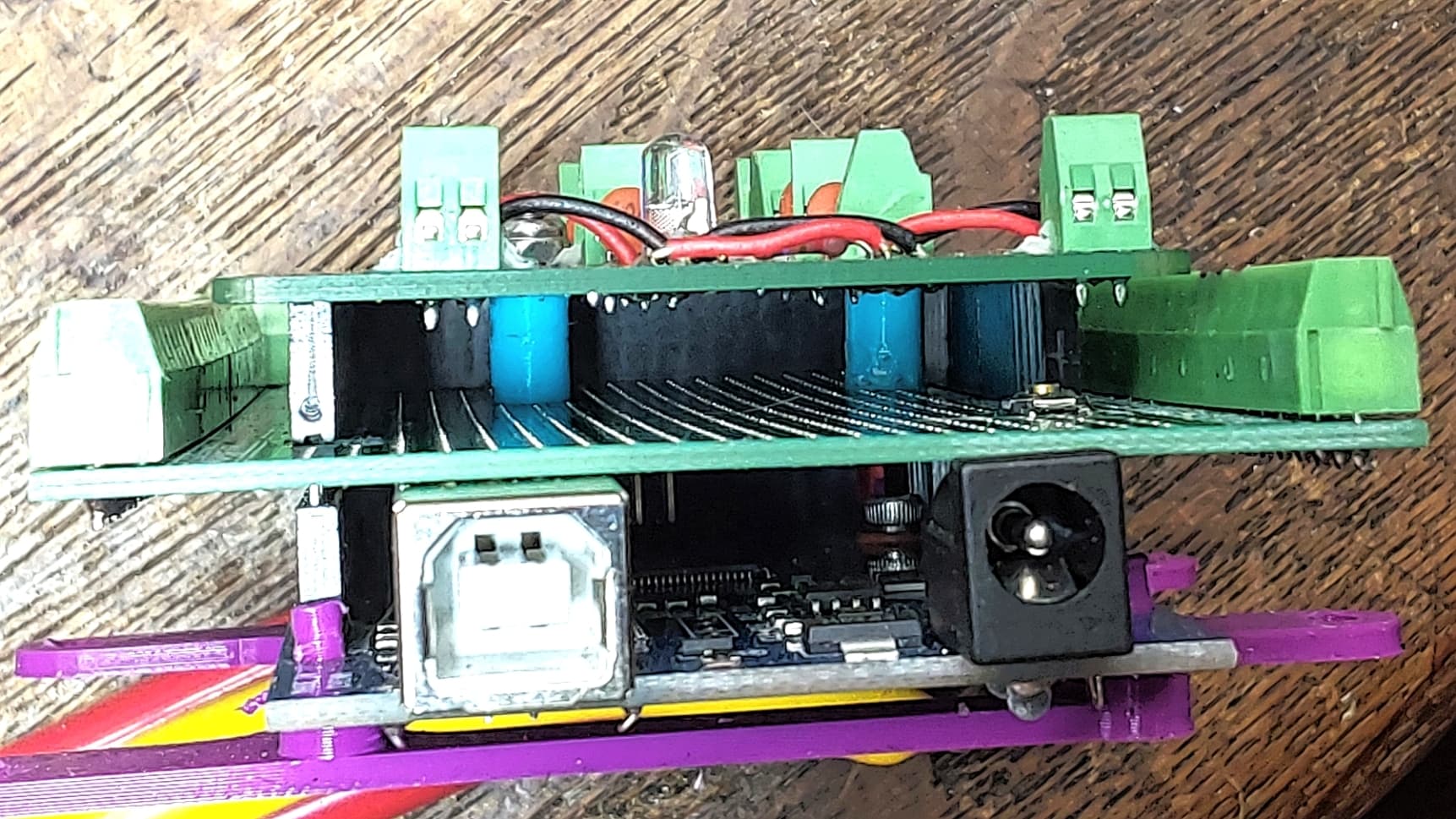

You want solid interconnects? Then you need a screw terminal shield. For the mega, they're under $20, assembled.
To that add a screw terminal power distro board like this:
https://create.arduino.cc/projecthub/madmark2150/perf-panel-paired-power-plug-piggyback-for-mega-2560-uno-67d604
Once the PDB is made, no soldering is needed to make essentially permanent connections. The wires can be simply be stripped and twisted prior to insertion. No special tools, pins, or forms.
The connector shrouds group & solidify the individual DuPont pins without having to resort to crimping. The shrouds slip on or can be fed over a cut end. The far end of the cables are all DuPont F's that plug directly into whatever modules you use.
The final "sandwich" looks like this:
  • PDB
  • Terminal Shield
  • Mega
  • 3D printed mounting base (wide to clear edges of terminal shield)
The entire unit panel mounts as an assembly with four #6 screw holes.
Here you can see the mega, terminal shield and PDB form a solid, reliably connected stack.
Assembled project is cat proof. Note that its still running after being shoved 1/2 off the table by the cat. None of the connections came loose. Note that the DuPont connectors have retention shrouds that give a place to label, id pin #1, color code to match, group for easier insertion and less susceptible to vibration.

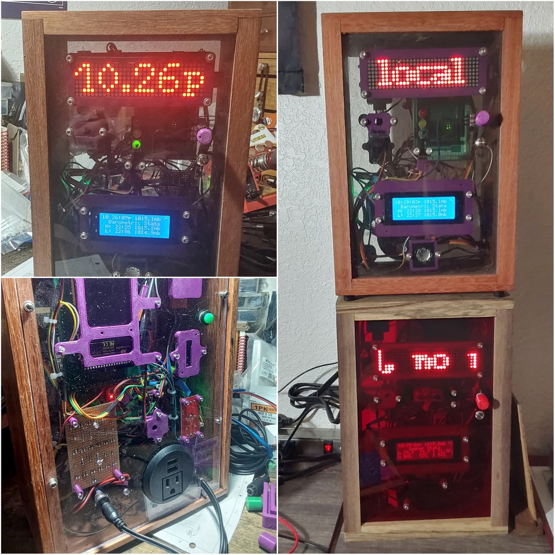

I've built & sold a couple of gadgets built this way:
I use a $150 3D printer to make all the mounts and shrouds and standoffs and such.
