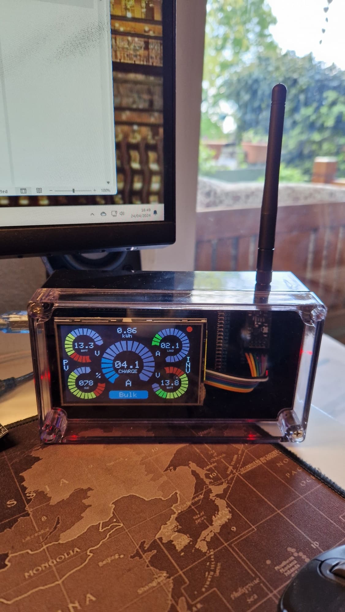

The hardware are two units consisting of Mega boards (Elegoo Mega R3 clones) with 3.5" TFTs, connected by NRF24L01+ PN & LNA radios. The NRF24's are connected via the usual module that provides a 3.3v power supply just for the radio, and this is powered from the 5v pin on the Mega. The "sender" unit reads the serial data output from the Victron charge controller, does some formatting, changes a few units and outputs some pretty gauges on the local display. It also sends the data to the "receiver" unit which just displays it nicely on my desk. Nothing too complicated or groundbreaking.

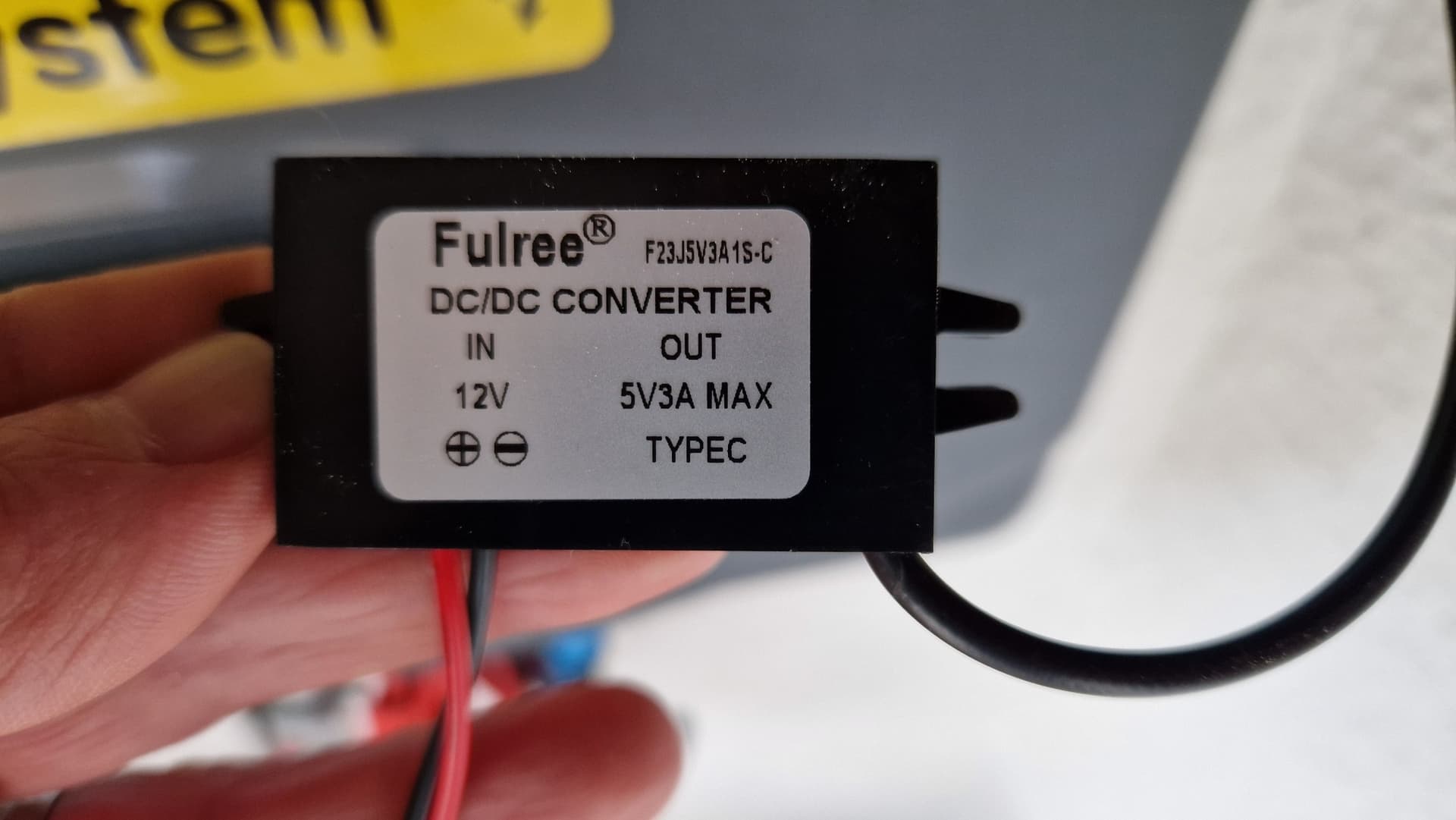

  2. 12v to 5v 3A DC-DC Step Down Adapter, giving 5v into a USB plug straight into the Mega's USB port (see here)
The USB power supply worked slightly better than the other, but still I guess 90% of transmissions didn't make it through. I added an output of the auto retry count to the sender unit to give an idea of connection quality, and this normally sat at the maximum value. So then I've spent hours reading this forums and others learning about adding capacitors and/or LC filters to the power supply.

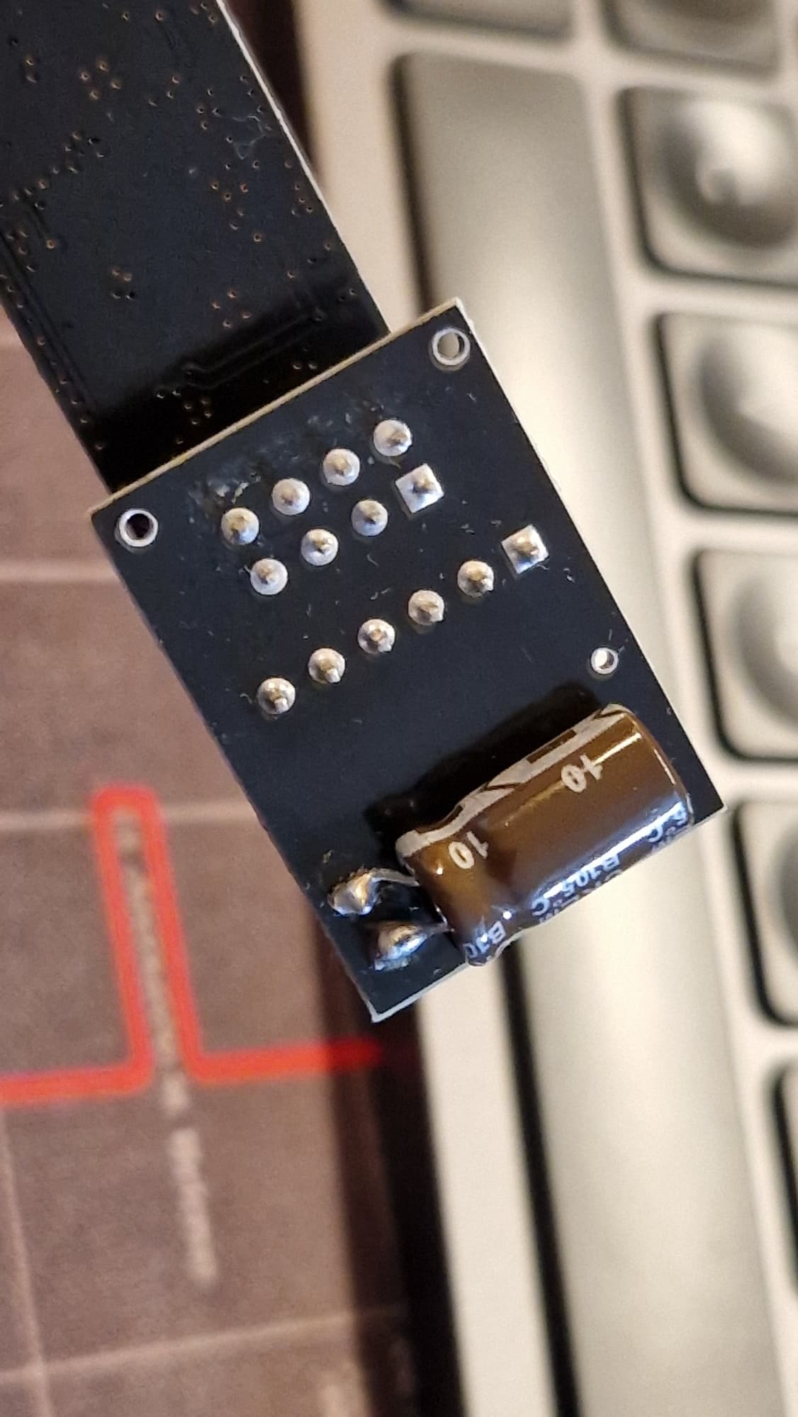

To cut to the chase, I tried adding a 10uF 50v electrolytic capacitor across the power in terminals on the NRF24 connector board (i.e. before the 3.3v local regulator). It made no difference that I could tell.
Than I tried a 100uF 50v in the same place, and it worked! The ARC counter now sits at 0 or 1 and virtually every single transmission gets through. Great - so I have a solution! I think...
But, from my reading, I understood that large electrolytic capacitors are used to prevent voltage dips when the radios transmit. And it is the smaller (0.1uF ?) SMD cap's that are already on the NRF connection module that are there for the noise filtering.
So I would like to understand why adding the 100uF cap seems to have solved the "noise" problem from the MPPT supply when I don't think there was ever a voltage dip issue because of the 3.3v reg on the module.

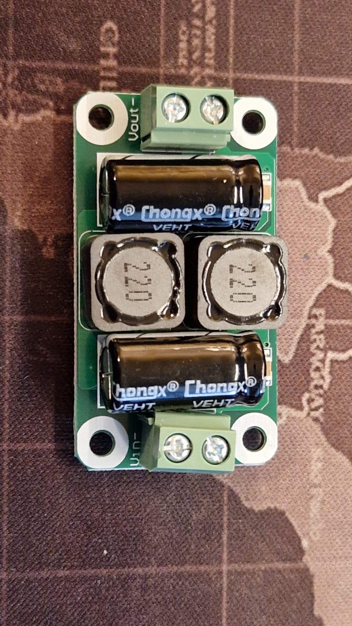

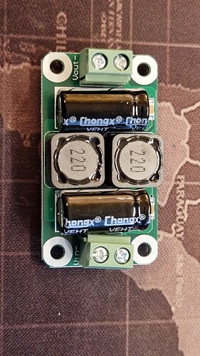

I had also ordered a " 0-50V 4A DC Power Supply Filter Board Class D EMI Suppression Amplifier for Car" (see here) before I found the solution with the 100uF cap, so I tried this today to see if it worked or was even better. It has two 470uF caps and two 220 inductors across both positive and negative lines. The result was back to having almost no transmissions making it through. It was still ok with the 100uF cap on teh radio connector module, but just the LC filter alone (added before the 12v-5v regulator) had no effect by itself.

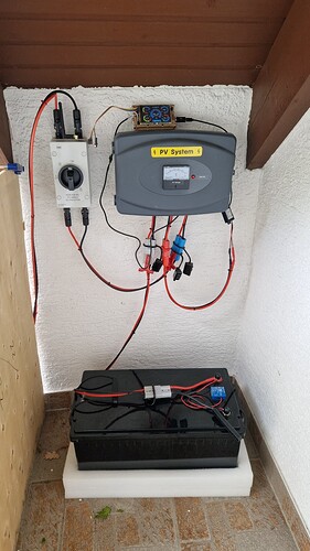

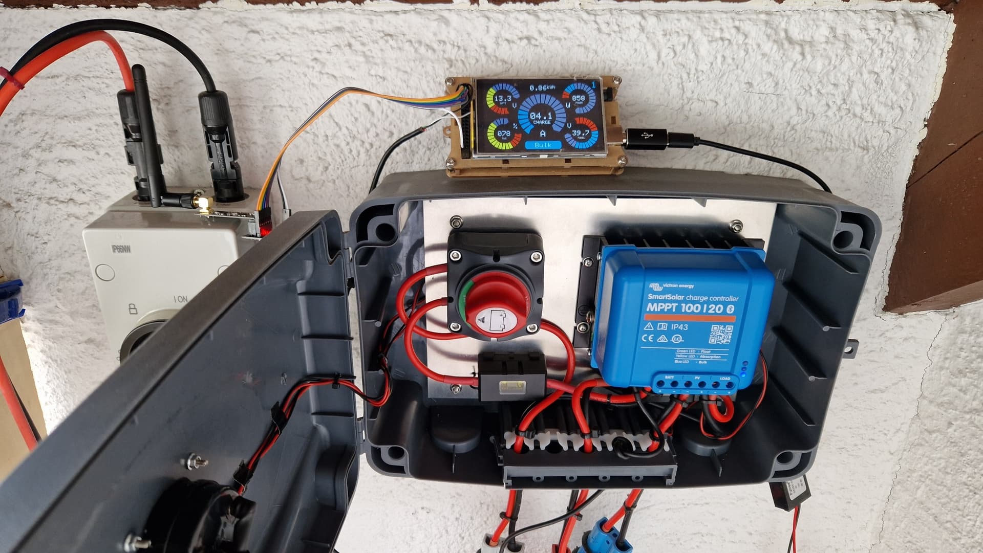

Main part of PV system on balcony:

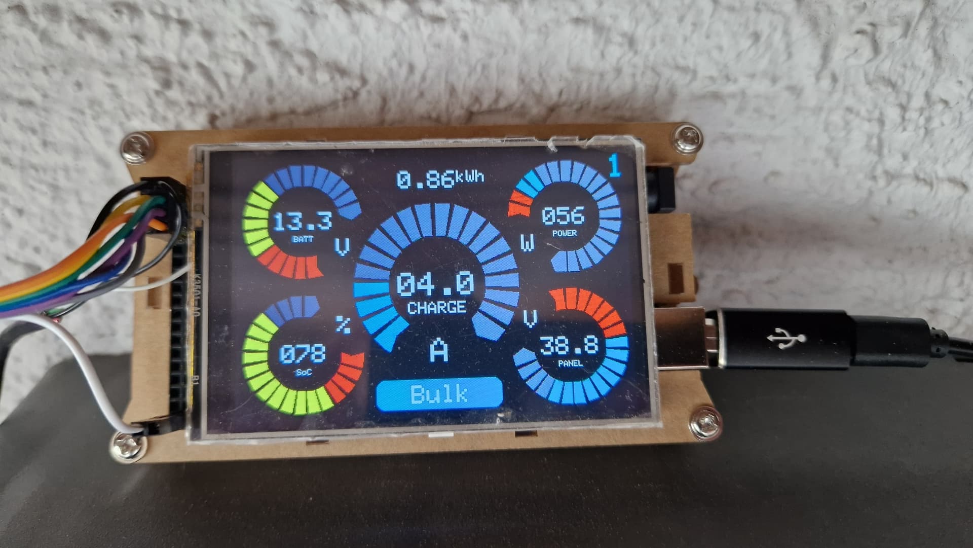

The "sender" unit which connects to the Victron charge controller via serial
The USB power supply, powered from the ~14v from the battery via the load output on the charge controller (a USB plug on the black output plugs into the USB socket on the Mega):

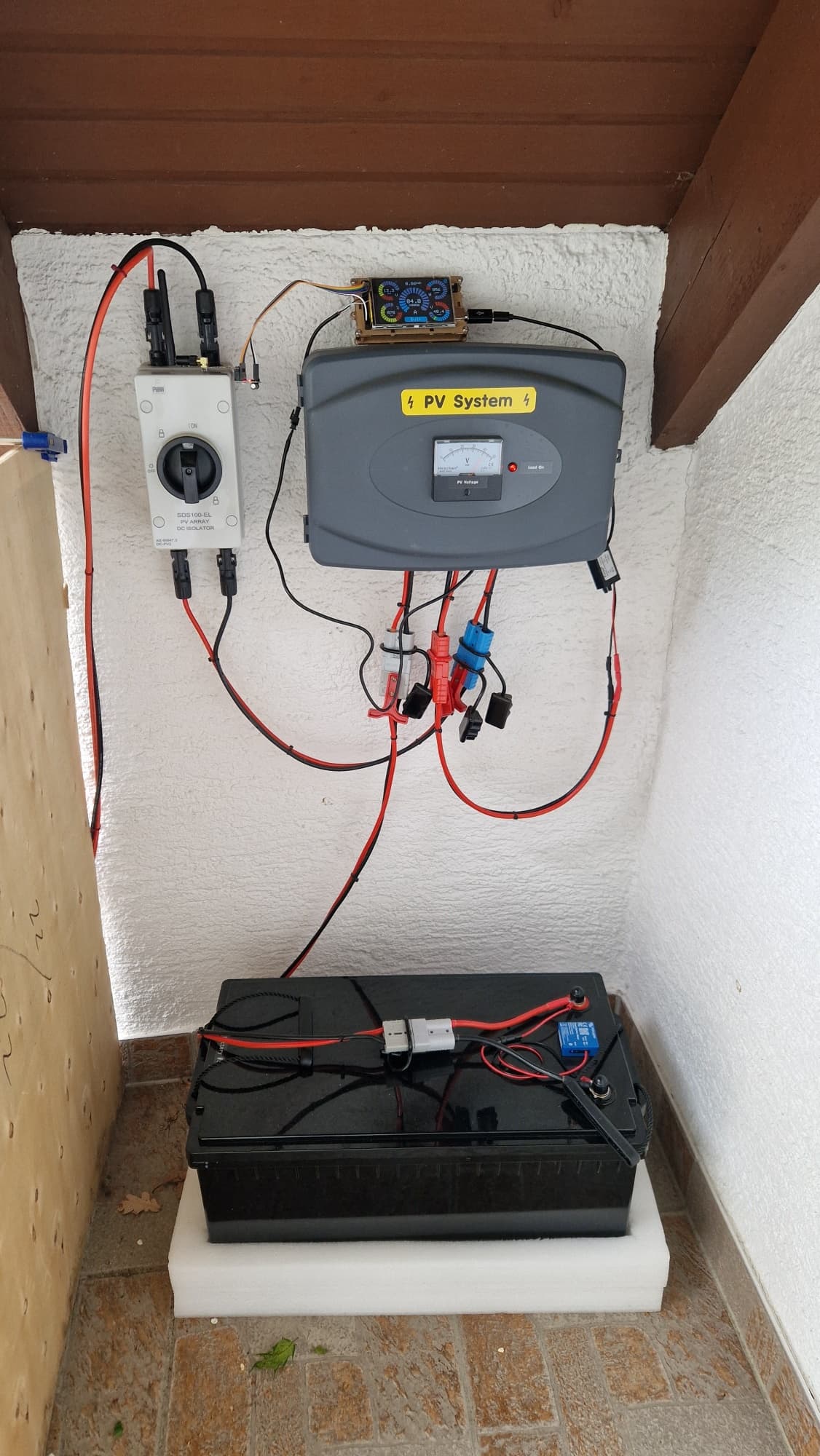

The PV system overview:
The "Receiver" unit on my desk downstairs (the INV gauges on the right side are dummy data, intended to display data from a seperate Victron inverter via a third Mega+NRF24 unit, but only once I have the current setup working reliably):
This LC filter unit from Amazon didn't seem to help (added before the 12-5v regular, the caps are 470uF):
But this 100uF cap soldered onto the 5v input to the NRF24 connection module seems to fix the problem(s) as far I can tell:

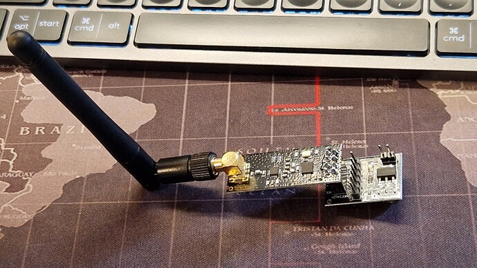

These are the radios and connection modules that I am using:
WayinTop 2pcs NRF24L01+PA+LNA Transmitter Receiver Wireless Transceiver RF Transceiver Module with SMA Antenna 2.4GHz 1100m + Breadboard Breakout Adapter Board Compatible with NRF24L01 Module
There is no inverter connected. The PV system is completely off-grid and not connected to the house. It charges the battery which I then manually move downstairs and hook up to an inverter which powers our fridge for a few days. Meanwhile a second identical battery is charging on the balcony, and I swap them back and forth. Hence the need to keep an eye on when the battery is charged so I can swap them over. Long sorry, but basically rented house and needed to keep the PV system completely separate to the house wiring.

The connections to the Mega are:
(1) The Victron MPPT PV charge controller connects via serial to the Mega via GND and pin 19 (TX1)
(2) The NRF24L01+ radio connects to the Mega (via the connector board with 3.3v reg) via the standard pins:
Radio > Mega
VCC > 5v
GND > GND
CE > pin 48
CSN > pin 53
SCK > pin 52
MO > pin 51
MI > pin 50
IRQ > pin 49 (not needed, but plugged in to spare pin to stop it floating)
It's a simple setup, nothing else connected, and whats connected uses the standard pins.
