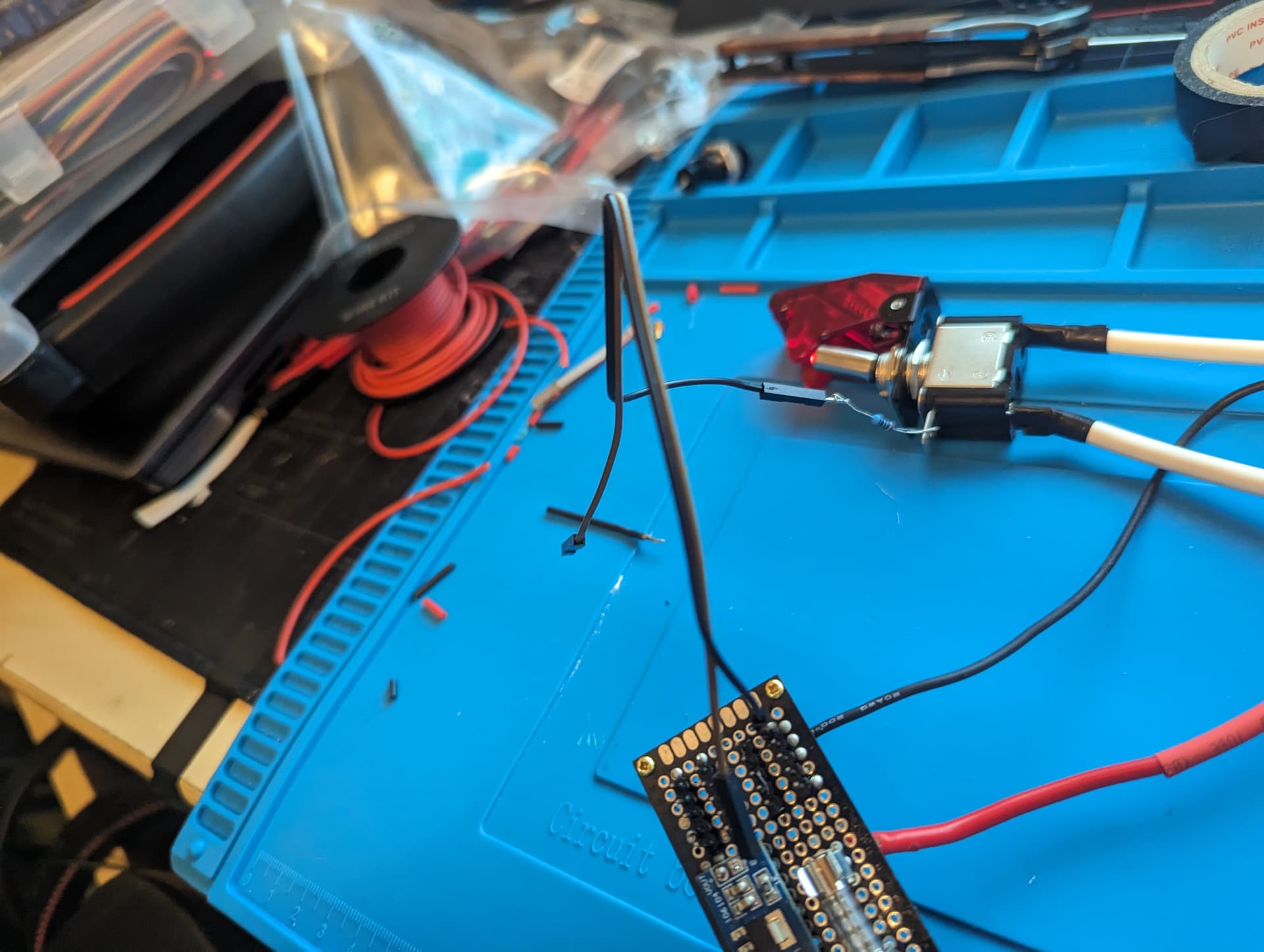

So, first of all, I'll be powering each of the three matrices indepentantly- This will make sure that all those 6A (Or the worst case 30..) doesn't go down one wire to all matrices. Then, I will be soldering together the 3 5V injectors spread out across the matrix- one at start, middle, end. So the hopefully ~2A going to each panel will actually be split across 3 power delivery wires- 22AWG cable should be fine. I've attached a photo to show the back of my matrix- matrices horizontal here, so I will be connecting the top row of 5V's, the middle, and the bottom, and each of those will independantly go to the power board.

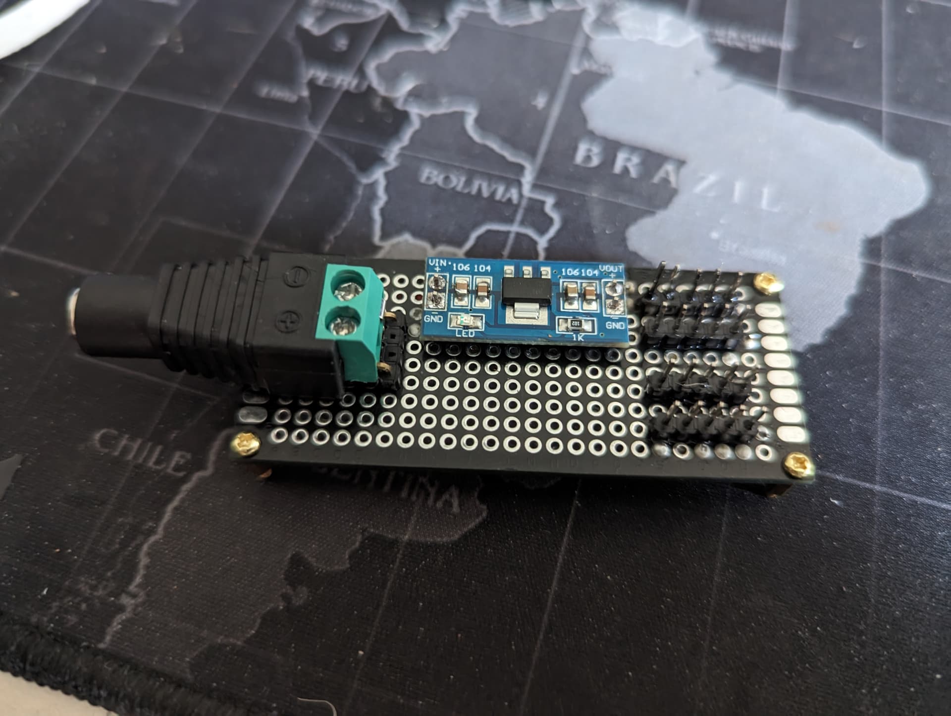

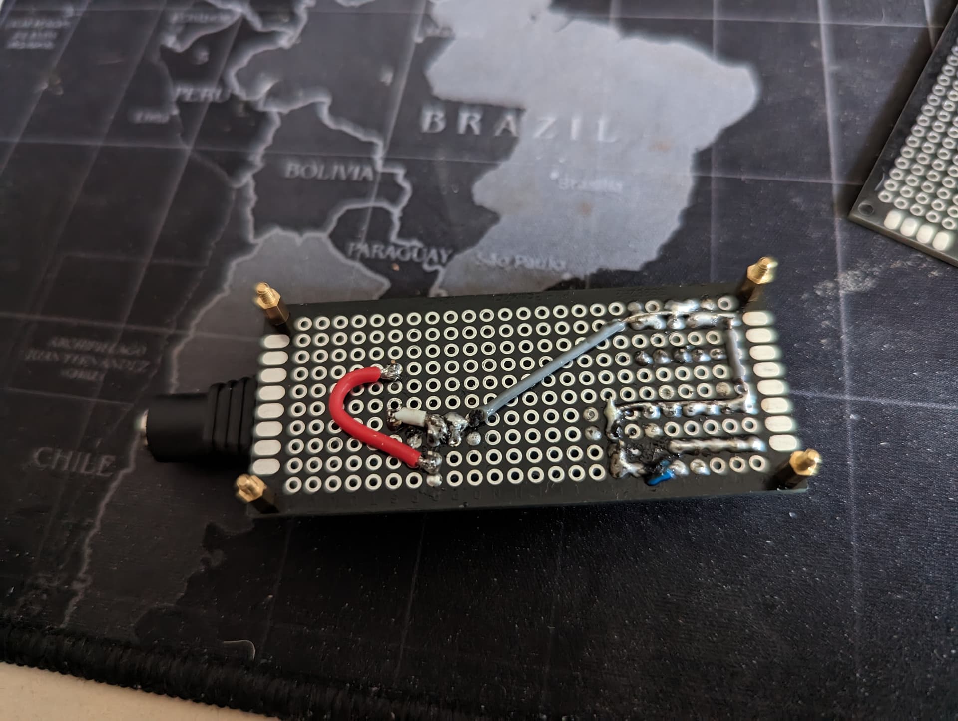

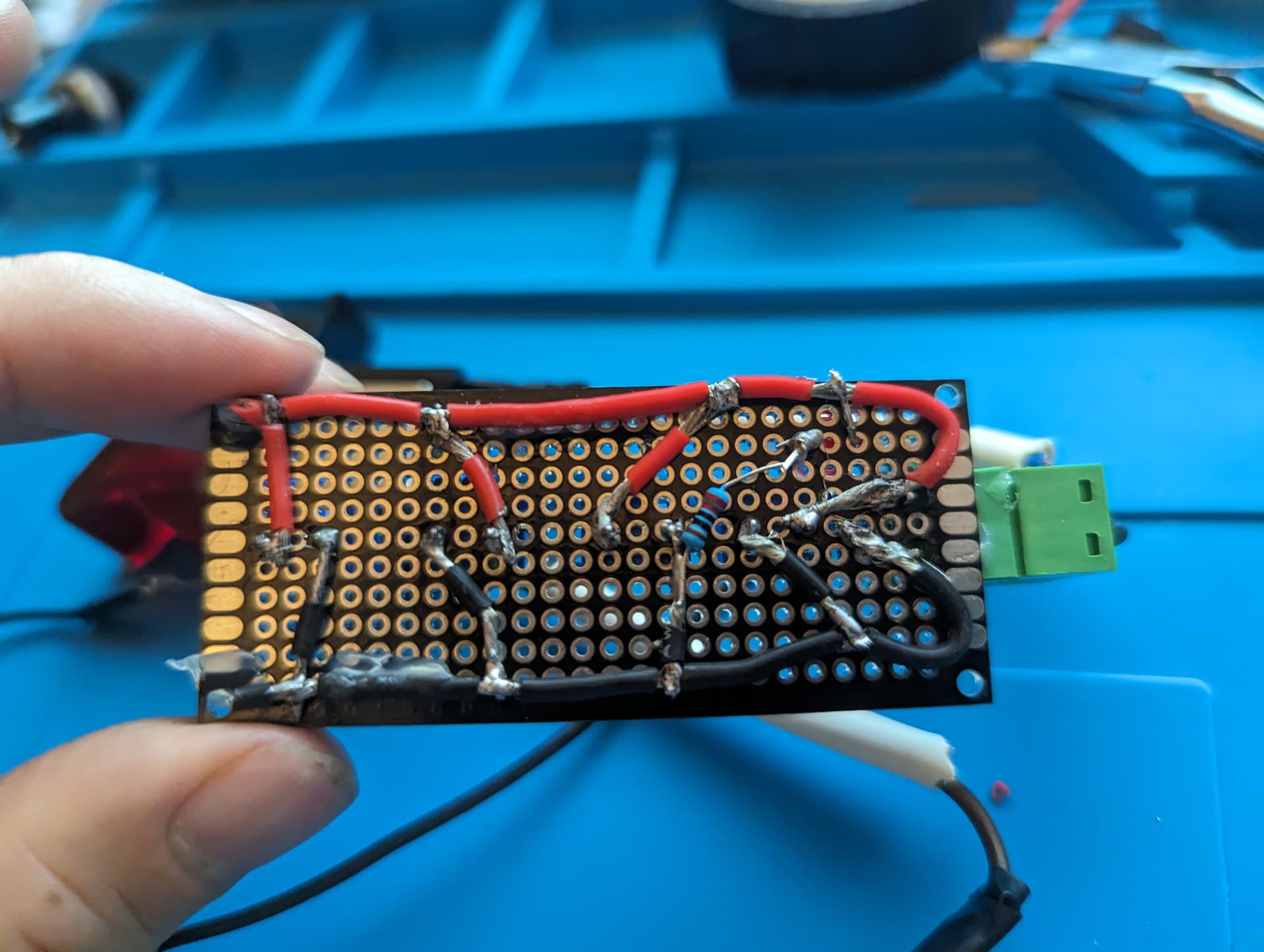

Each matrix 5V line will plug into a pin on my power distribution board (Pictured). Simple layout, 5V barell plug in, using a DC PSU rated for 5V@10A. Top is a 5V to 3.3V voltage regulator, to directly feed the ESP32, other 3.3V peripherals, into a 3.3V and ground pin rail. Despite my care to make sure the toal current is split for entry to the matrices, you can see that ultimately this is still all going through relatively small 22AWG cable on the protoboard, and into a line of pins.. It's a single point of failure though...
Bottom, is so far just grounded bottom line of pins (also linked to the 3.3V ground line for common ground), and you'll see I've left a space where i haven't linked up the 5V heyween the barrel and the 5V pin rail, where I had intended to wire in a toggle switch.
I think now though that in that space I will put some overcurrent and short circuit protection.
