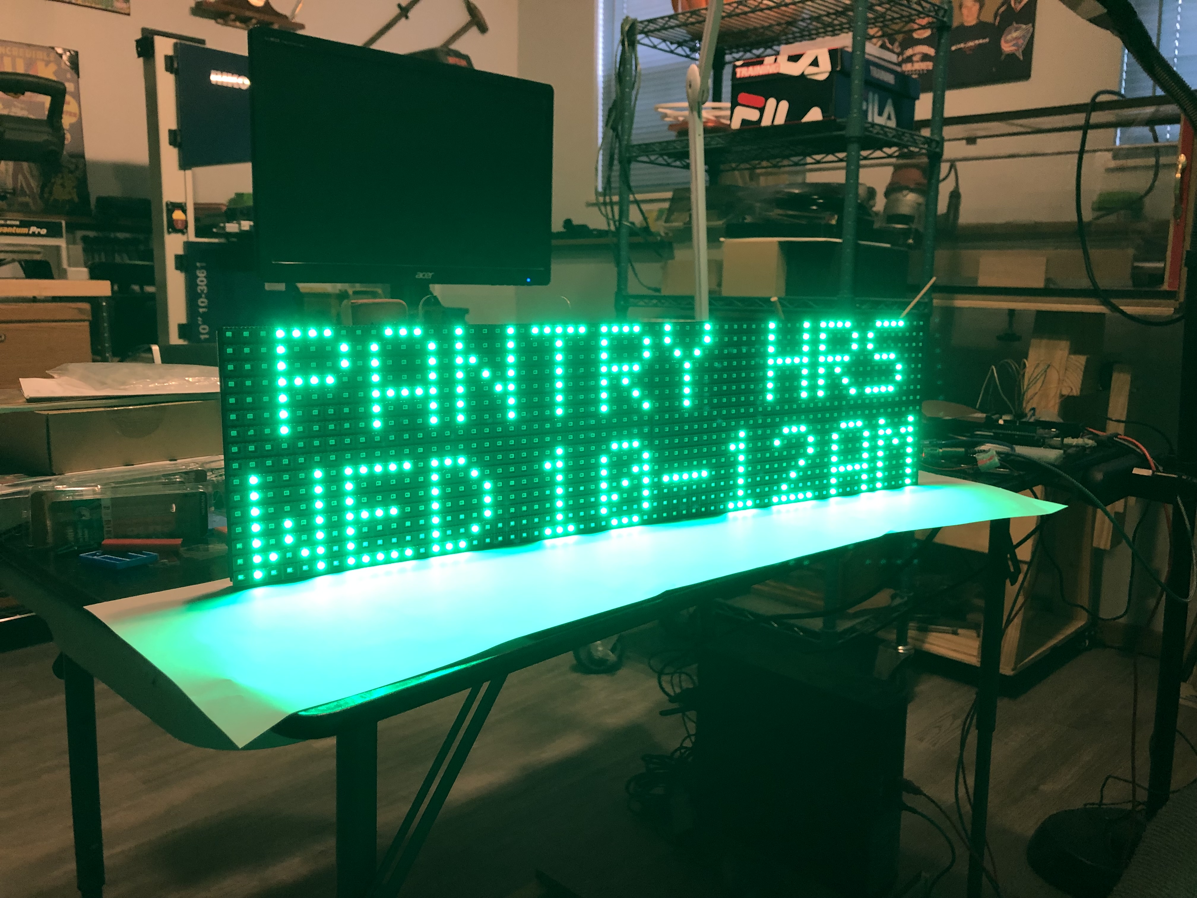

P10 display brightness control using DMD library
Using a P10 single color display, currently with UNO, eventually nano.
Is it possible to change / control the brightness of the display using the DMD library or do I need to use the DMD2 library?
All the code works fine for a sign for the Food Pantry I volunteer at, but they now tell me they want to be able to dim the display.
From DMD.h...
#define PIN_DMD_nOE 9 // D9 active low Output Enable, setting this low lights all the LEDs in the selected rows. Can pwm it at very high frequency for brightness control.

I tried a sketch to dim the display but no results. The text scrolls fine, but no dimming.

My photos aren’t the best, but:
Image of sign

I am able to dim the display by adding a 15 ohm resistor to the 5V line but I would like to do it via program. I want to use DMD vs. DMD2 although DMD2 dims it successfully.
I'm sorry, but judging by the code, the DMD library does not support brightness control. Working with OE pin inside the library only includes turning on and off and does not support PWM.
Adding a setBrightness() method to your sketch is not enough. To add brightness control, you need to change the library code. It might be easier to switch to DMD2.

I am not advanced enough to understand much about the code, but I noticed in the DMD code there is a line that says:
#define PIN_DMD_nOE 9 // D9 active low Output Enable, setting this low lights all the LEDs in the selected rows. Can pwm it at very high frequency for brightness control.”
I though perhaps experts who understand such things could help me out.
This is only a possibility; there is no support for this in the library code.
To do that, you need to add a PWM control yourself. The next issue that the Arduino has default PWM frequency about 500-1000 hz, but the DMD brightness control needs 10-20 KHz or above.
All these fixes are not too complicated, but why do this if there is already a DMD2 library if you want to run it on Arduino.
But in principle, I advise you to consider more powerful controllers, such as esp32, stm32 and rp2040. These controllers can control hundreds of panels.
