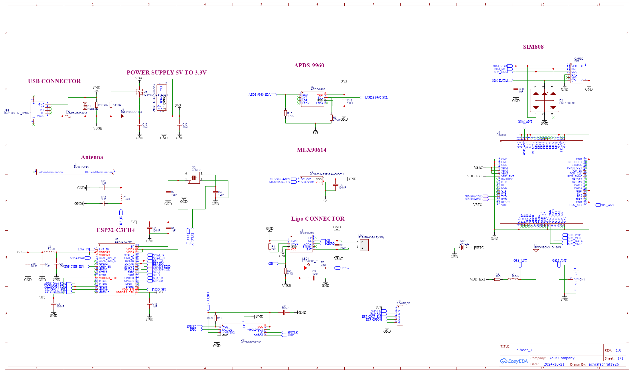

Hello everyone,
I'm working on a 4-layer PCB design and would appreciate any feedback or recommendations you might have. Here are some key details of the design:
:heavy_check_mark: Microcontroller: ESP32-C3FH4 for control and communication
:heavy_check_mark: GPS/GPRS Module: SIM808, with SIM card support
:heavy_check_mark: Sensors:
MLX90614 for temperature measurement
MPU-9250 for acceleration sensing
APDS-9960 for proximity detection
:heavy_check_mark: Power Management: TP4056 module for LiPo battery charging and seamless switching between USB, battery, and external power
:heavy_check_mark: Antenna Connections: Separate GSM and GPS antennas for the SIM808
:heavy_check_mark: Layer Configuration:
:heavy_check_mark: 4-Layer Stack:
Top Layer: Signal
Inner Layer 1 : Power
Inner Layer 2 : Ground
Bottom Layer : Signal
:heavy_check_mark: Design Goals and Specific Areas for Feedback:
1. Power Supply Stability: I'm particularly concerned about ensuring stable power to the SIM808 module. The power circuit includes components for USB/battery power switching. Any suggestions on component selection, layout, or decoupling for power stability?
2. Power Consumption Optimization: I'm exploring power-saving features such as ESP32 deep sleep. Would love advice on component adjustments or layout techniques to reduce overall consumption.
3. I2C Communication Reliability: This design involves multiple I2C devices connected to the ESP32-C3. Feedback on pull-up resistor values or tips for improving I2C communication stability would be very helpful.
4. Antenna Placement and Routing: Since I have GSM and GPS antennas for the SIM808, I want to ensure optimal placement and minimal interference. Any best practices on antenna layout, ground plane isolation, or signal routing?
I've attached the schematic and PCB layout below. Looking forward to any insights you can provide to help make this design more robust and efficient.
Thanks in advance for your help!

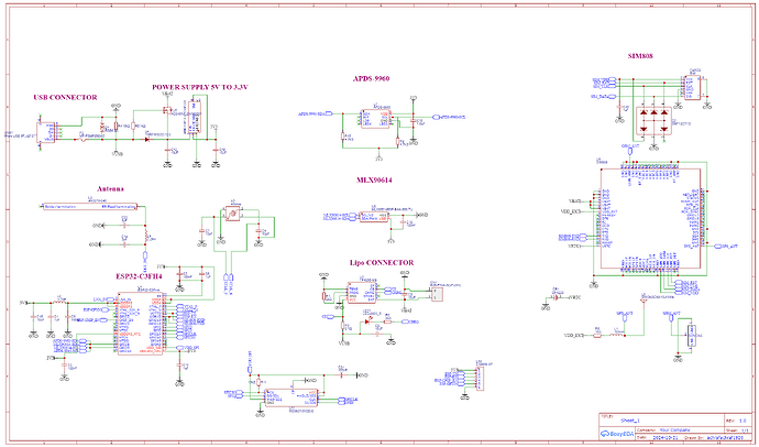

schematic
Top Layer and Bottom Layer
inner 1 and inner 2
Why are there component pads on the inner layers?
The component pads on the inner layers are used for via stitching and thermal management.
Component pads are not used for via stitching or thermal managemrnt, besides they are causing short circuits with traces on the innerlayers.
Maybe you should first spend some time learning how to use EasyEDA.
Whats the difference with your previous design?
Don't use net ports to connect nets on a single page, they are intended for Hierarchical designs. Direct connections with wires are prefered with limited use of net labels.
As @maikarg pointed I see I just wasted my time replying as you already have an identical topic already open. You are not supposed to have two identical topics open.
Please read this
In the previous design, all four layers were combined in a single image, which made the information dense and potentially harder to interpret. In the new design, we separated these layers into two images, with each image containing two layers. This allows for a clearer segmentation of information and visually guides users through each level of analysis or interaction, making it easier to understand.
