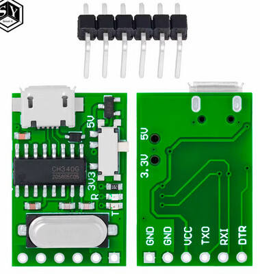

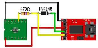

You just need a normal USB serial adapter, a diode and a 470Ω resistor.

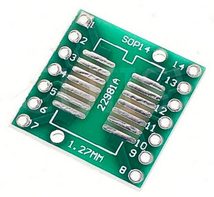

And first of all, I would strongly recommend to put one Attiny MCU in a SOP adapter and mount it in a breadboard:

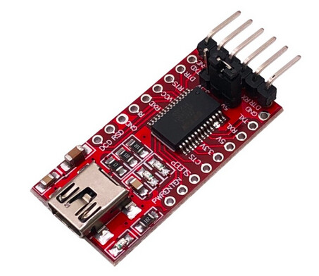

For the programmer, this one works very well and is very cheap:
But anyone that you already have should also work, like this one:
You have to connect it this way.
Better put the adapter, the diode and the resistor in a separated small breadboard.
This will work. Make sure that you can program the MCU alone with a blinky led. And then build the rest, before ordering the PCB.

To make an UPDI programmer from a USB-UART bridge, I use this arrangement:
UART RX and TX on the left, UPDI on the right. The resistor is 1k, the diode is a generic Schottky. The TX and RX in this case are on a CH340, but I assume it'll work just as well with a CP210x, FTDI232 etc. You could of course also put this arrangement on the target board so you can plug in any old USB-UART device.
UPDI is in-system programming (ISP). It does not use SPI evidently and I'm not sure you can program these devices with SPI like you do with the old-style ATtiny's and ATmega's.
Not sure what you mean with TTL; maybe USB-UART?
Anyway, UPDI works perfectly fine and is very convenient, so I wouldn't bother with anything else. You can use UART for Serial monitor debugging of course.

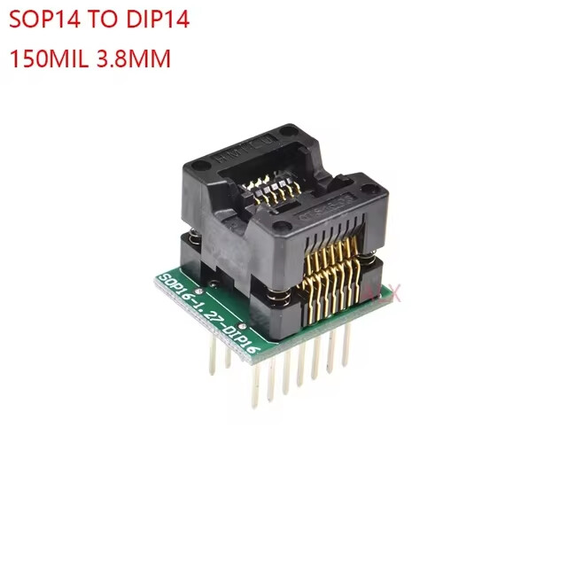

To program the Attiny my plan was to put it in one of those sop14 to dip14 adapters
and place it on a breadboard with other components, but I could also solder in on the PCB and leave the UPDI pad and then program it while soldered on the PCB. What solution would be better?

Whichever you prefer. I just include a single-row pin header on the project PCB that has power and UPDI for programming, that's all.
