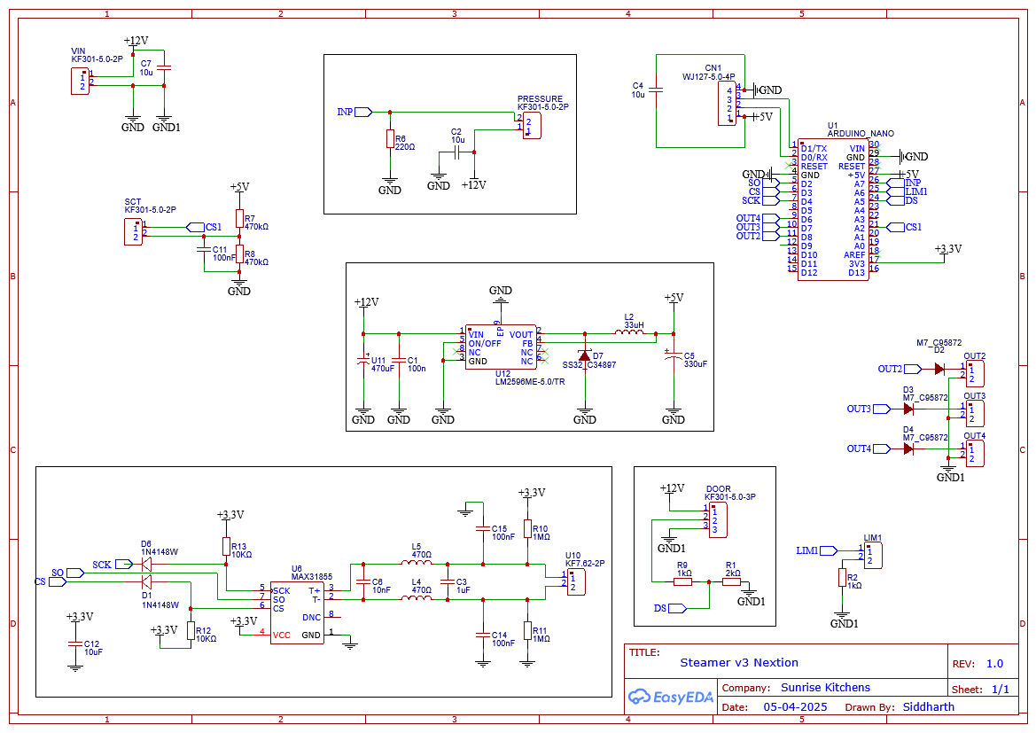

Hi Everyone,
I always use this forum to get a peer review. I am slowly expanding my expertise in PCB design. And have tested each component piece by piece. However, I would still appreciate it if you could review the schematic and highlight any shortfalls or issues with the design.
@jim-p @6v6gt - you guys have helped me in the past. A big shoutout to you for helping again.
VIN - used to connect the output from a 12V DC SMPS
SCT is used to connect to SCT-013-030 Non-invasive AC Current Sensor Clamp Sensor
U10 - connect to a K-type thermocouple
Pressure - connect to a pressure transducer 0.2mpa (link below) https://robu.in/product/pro-range-pr18-a002-pressure-sensors-00-2mpa-420ma-g1-4/
CN1 - Connect a Nextion display
OUT2, OUT3, OUT4 - connect solid state relays
LIM1 - connect a float sensor (link below)
https://robu.in/product/anti-corrosion-type-ball-float-liquid-water-level-sensor
DOOR - connect a proximity sensor (link below)
https://robu.in/product/inductive-proximity-sensor-lj18a3-8-z-ax-npn-non-shieldedsetting-distance-6-4-mm/

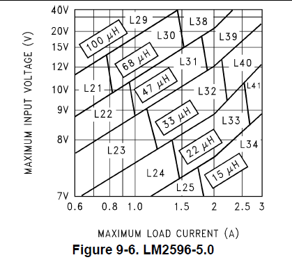

What was the idea behind the use of R10, R11, C14, C15 and C3 ?
How did you come to choose 33uH for the inductor?
I don't think the door sensor interface is correct.
The voltage divider at DS looks inverted. Anyway, ensure it delivers no more than 5v to pin A5.
Try to keep pins A4 and A5 free in case you want later to add an I2C device.
Use Schottky diodes for D1 and D6 instead of the 1N4148 to ensure that the voltage on CS is always in the defined range.

33uH Inductor is suggested in the datasheet. Attached herewith.
"In the majority of designs, a 33-μH, 3.5-A inductor is the best choice."
lm2596.pdf (4.8 MB)
For MAX31855 -
C6 is recommended in the manual.
R10, R11, C14, C15 and C3 - these were not recommended in the manual. After your post, I believe I may have overevaluated it. Pull-up resistors are added to reduce noise and improve accuracy.
Door Sensor - Re-evaluating it. Let me come back to this.
One question: Am I right in connecting the 3.3V output from the Arduino to power the MAX31855?
Schottky dioides in place of 1N4148 - duly noted. Thanks
Corrected voltage divider. Thanks for pointing it out.
What does "majority" mean?
Do you consider your design to be in the majority?
What is the minimum and maximum current your system will need?
Looking at the most recent datasheet, I see no mention of putting a 0.1uF cap across the thermocouple lines.
I suggest you download the latest datasheet and carefully read the application information section. Do as they recommend.
They could damage the IC, will probably add noise and will certainly keep the automatic fault detection from working. Remove R10, R11, C14, C15 and C3.

I would make C11 10uF.
What is the purpose of D2, D23 and D4?
That could be worse.
Explain to me how the limit switch circuit is supposed to work.

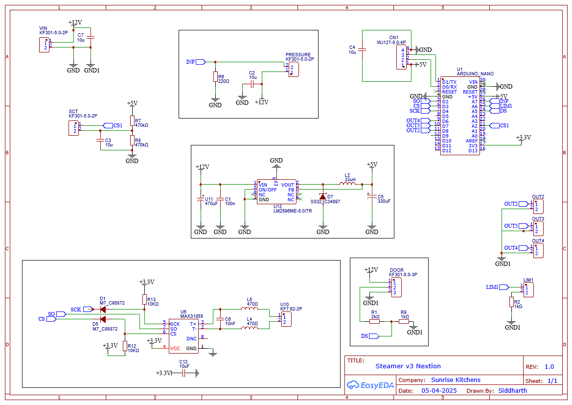

Removed R10, R11, C14, C15 and C3

D2, D3 and D4
The idea was to suppress inductive kickback. However, SSR does not do kickbacks. :sweat_smile:
Revised schematic
You actually made this measurement or are you guessing what it should be?
I made this measurement on a small prototype board.
The SMPS is adjustable in the range of 10V to 13V. In both extreme cases, digitalRead() throws the result HIGH.
It's an NPN output. Some have a 10K pull-up inside to V+ so don't. In either case your interface circuit would be wrong
Does it go low when an object is detected?
Does it go low when an object is detected? Yes. Correct
You have not made any of the changes recommended in the MAX31855 datasheet. Do you understand what they are saying?
I also see that you have not made any changes to the Buck or Limit switch circuit.

Understood. I went through the datasheet again and found my mistake.
The 5V current consumption is in the range of 200-300mA, not including the components running at 12V.
Qty Min (mA) Max (mA)
Arduino nano 1 20 30
MAX31855 1 1.5 1.5
SCT 013 Sensor 1 1 1
SSR (3nos) 3 3.5 13
Nextion 4.8inch 1 170 220
203 292
As per the graph above, I should be using a 100uH inductor.
On the other hand, this post (link below) recommends having an inductor less than 15uH. I am confused again.
https://e2e.ti.com/support/power-management-group/power-management/f/power-management-forum/875782/lm2596-output-capacitor-and-inductance-determination
