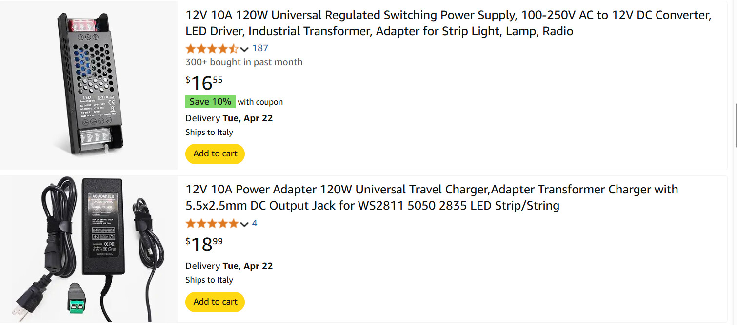

You don't want 6A power supply for 6A peltier, you want >6A supply.
Something like these:
Battery would be silly choice if you have mains available.
Thank you for your answer, indeed I had gone too fast and more than 6A are required.
In the second power source of the picture you've sent, there is a green connector. Can I buy this, plug the green connector to the peltier without risk ? Is it suited for such use ?
Thanks a lot for your help,
Best^^
Yes, as long as you respect the polarity..
And it doesn't burn even if you reverse it.
No
I think the screw terminal adaptors are only rated for 2A.
So not suitable for 6A.
I would buy a connector rated for at least 10A.
Something like this would be better
I have found some rated for 10A and 20A, but I wouldn't trust the adapter that comes with the power supply to be rated for more than 2-3A.
