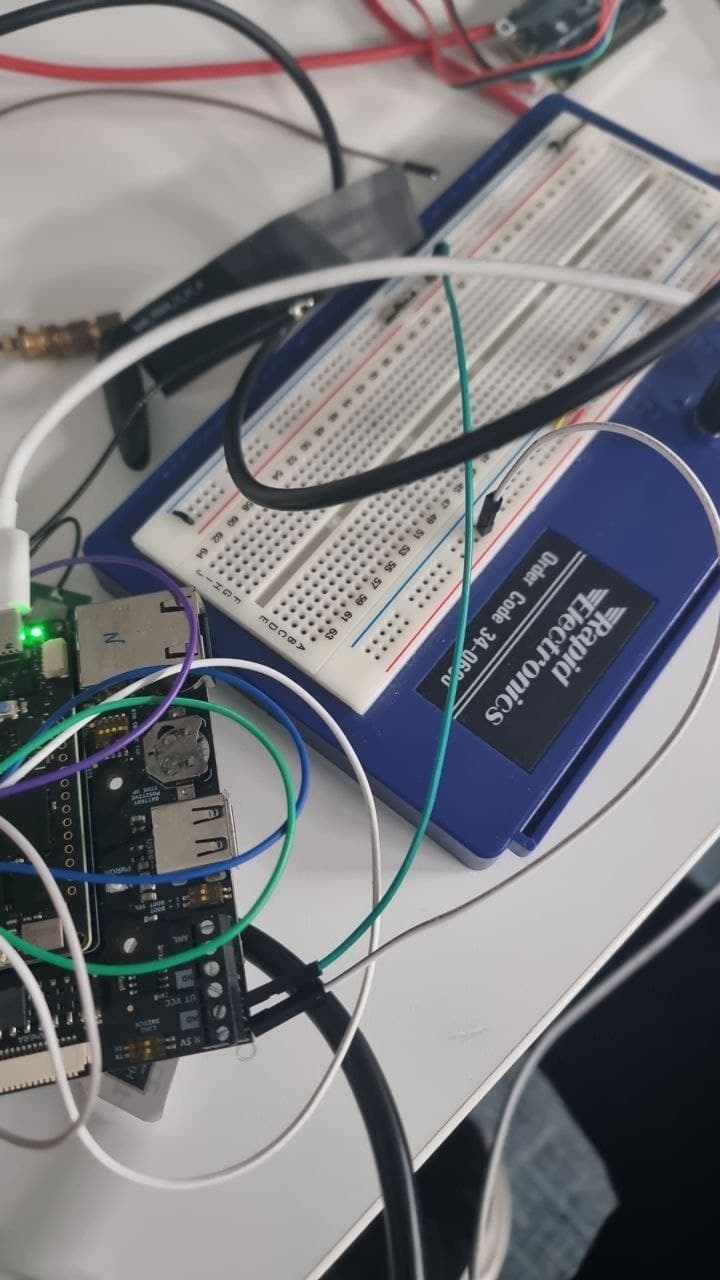

@alfmich1 are you using the Portenta Mid Carrier? Are you providing the 5V power supply from J4 Screw terminal block ?
hello, yes. I am using the portenta mid carrier and i use a 5v power supply connected to the gpio 5V i and gnd.
picture of the connections.
@alfmich1 from the image seems that you are not using J4 to provide the power supply to the MidCarrier. Please follow this link for the MidCarrier hardware setup.
Thanks pennam, i will do it right away.
After you have completed the hardware setup and before loading an IoT sketch, you can try some examples from the ArduinoCellular library to test that everything works correctly.
hi, i have done that and i tried the modem terminal as well as the sendsms. They both work well.
Good, you can also try HTTPClient.ino to test internet connectivity :slightly_smiling_face:
