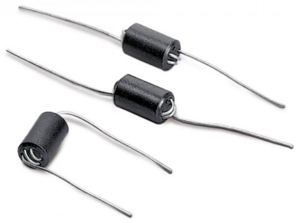

Hi!
I want to create my controller, with a base of CPU Atmega328P (Use for Arduino UNO).
I had a few questions:
  1. Power Capacitors. My circuit capacitors on the power supply (smd capacitors, 4 normal, 1 polar):
Is this combination correct? Or should I change the capacitance the number of capacitors?
  1. Ferrite interference protection. I learned Atmel tips on circuit board design with their controllers. There it was stated about the use of ferrite, as protection against interference:
Will it be suitable if I put such a thing on the + 5V line? Or does it not do any good?
  1. Antistatic protection. Should I use a diode for this?
I will appreciate the advice!

Certainly, the UNO is not appropriate for a practical design. If you do not require USB connectivity, then a Pro Mini is what you want, all the necessary parts ready-assembled for your use. If you are using your own custom PCB, you just mount it as a "daughter-board". You probably do not need the regulator and the pilot LED is generally either unnecessary or even a nuisance; these can simply be removed.
If you have a concern about RF radiation you can add a ferrite choke, but the Pro Mini as supplied will probably be as good or better in this regard than any other design.

Ferrite beads only useful if the 5V supply is badly noisy - if direct from a 5V regulator there no
need.
