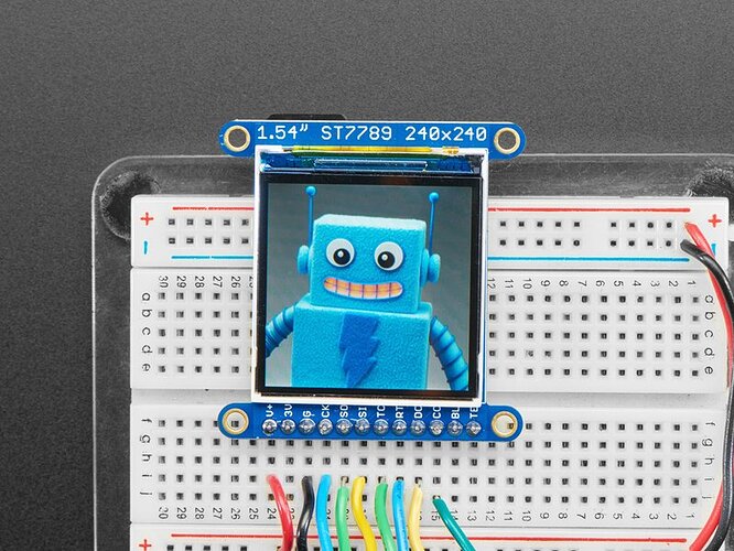

I'm looking for a small form way of powering it to fit inside the camera case. Something of note is that the 5v pin is already in use to power the display so I guess I can't power the nano through it. There's also no space to use the usb port.
I've got space for triple As or a 9v square battery or a lithium ion.
Both Adafruit displays should work with the 5V Nano.
If you have a different ST7789 display, please post a link to the actual item that you bought.
You can power display and Nano from the same 5V.
David.
I've got the 1.3" display linked.
I think I'm confused as to connecting power to the 5v pin. Would I have two cables going to one pin?
E.g. battery to nano 5v and nano 5v to display?
