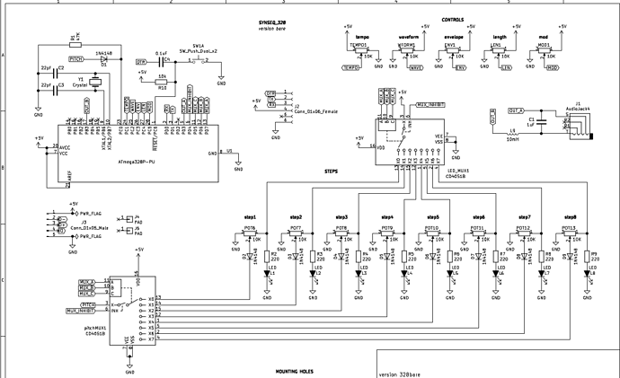

I have a circuit on a breadboard with a standalone atmega328 that works fine. I can upload sketches via FTDI and then I can disconnect the FTDI and just power the circuit with a 5V regulated supply.
I have the same circuit on a PCB and I can upload sketches via FTDI when I connect it and if I leave it on to power the at mega, everything works as it should.
If I disconnect the FTDI and try powering it via a micro USB, the sketch doesn’t run.
If I plug the FTDI (no power, just plug the FTDI in its socket) while leaving the microUSB to power the circuit, the sketch works. If I take the FTDI out of the socket, the sketch stops working.
Does anyone have an idea as to why this could be happening?
Thanks in advance for any ideas

Hi, thanks for the replies, here are the schematics

Why have you connected AREF to VCC? :astonished:
And what are all those 1N4148s supposed to be doing?
And why have you specified antique CD4051s instead of the proper 74HC4051?
You should use 1k for the LED resistors, not 220 Ohms.

I connected vcc to aref because i had no idea if i could just leave it unconnected. Didnt make any difference when i tried and using the code i have. Do you think this is the reason of the problem?
The diodes solve some weird note lingering i was having when the sequencer was going from one step to the next. Do yyoyou think this is the reason?
The CD4051 work as they should. Do you think this is the reason?
The 220 ohms is from tons of examples i have seen with every arduino and raspberries. Even in official docs i have seen. It works. Do you think this is the reason?

None of my four comments is likely to stop the microcontroller as such.
The omission of bypass capacitors is serious, there should be a 100 nF ceramic directly between Vcc and ground of each logic chip. On your current PCB, you can solder them underneath the board.
AREF is internally switched to AVCC by default in the analog read code, but you can select other sources such as the internal 1.1 V reference which is generally more accurate. But if you actually did that (which of course, you wodul not :grinning: ), you would be shorting that reference to the 5 V supply. For this reason, AREF is not connected to anything other than the appropriate board pin on the Arduino design.
The CD4051 has a switching resistance of nominal 470 Ohms, nearly six times the switching resistance of the 74HC4051. This means that you are putting this resistance in series with the 220 Ohms to the LEDs and substantially dropping the voltage you apply to the potentiometers. I should be somewhat surprised if you were getting analog readings greater than 700 from those potentiometers or in fact, greater than 500 if that, with the diodes in series. I would expect the diodes to make the readings more unstable.
When you switch from one multiplexer input to the next, it may be a good idea to do one analog reading and ignore it, read a second time for the stable reading.
Using a 74HC4051, the switch resistance is only about 80 Ohms, but even that will mean the voltage to the potentiometer is pulled down by the 220 Ohm LED resistor, so increasing that to 1k reduces the effect. Given the switch resistance of the CD4051 is already limiting the LED current substantially, I suspect you would notice no difference in brightness changing both IC and resistors, but you should get vastly better responses from the potentiometers. :sunglasses:

Try connecting some capacitor between Vcc and GND of the FTDI. Try what you have (if any) and see if it helps. You probably need a large "bulk" capacitor (i.e. 100 uF aluminium electrolyte) or "high speed" ceramic cap (at least 100 nF).

Smajdalf! That did it!
I put a 100nf cap between vcc and ground in the ftdi socket and it works.
Same was happening on the proto but I hadn't noticed because I was always leaving the ftdi connected to the wires and was disconnecting just the mini USB.
What would be the way of having this circuit work without plugging the cap when I don't have the ftdi? Is it OK to HAVE the cap AND also connect the ftdi?

Update on the caps in the ftdi socket:
If I leave only a 100nf it works for a while and then freezes... I added another 47nf and it doesn't have the issue
