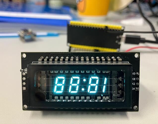

Hi, I am seeking for help related to data communication with a uart module. The module was connected via RX0 and TX1 pins, however when I am trying to send data with Serial.write(...), the program just cannot upload to the board at all. Was it because of code uploading also need to use Serial via USB? Or something else?

On the Classic Nano, RX0 and TX1 are reserved for program upload and output on the serial monitor. You should not connect anything to those pins.
SoftwareSerial (or AltSoftSerial or NeoSoftwareSerial) are options that allow you to use other pins, with some limitations.

SoftwareSerial only supports 8N1. There are no constructors or methods to use 5E1.
So you will need a board with a processor that gives additional UARTs. With (kind of) the same form factor as the classic Nano, you can use the Arduino Micro, Arduino Nano Every or SparkFun Pro Micro.
If form factor is not important, you can use an Arduino Mega.
There are more boards but they are 3.3V boards instead of 5V boards.
Alternatively you can check the other libraries mentioned by @jremington and check if they support the needed serial format.

Got it, I will try to find the right config info from the manufacturer. And I think another problem is I did not give enough power to the module (in which case I connect the vcc directly to arduino board)

I use ESP32 Dev Board instead as it has second UART ports.
