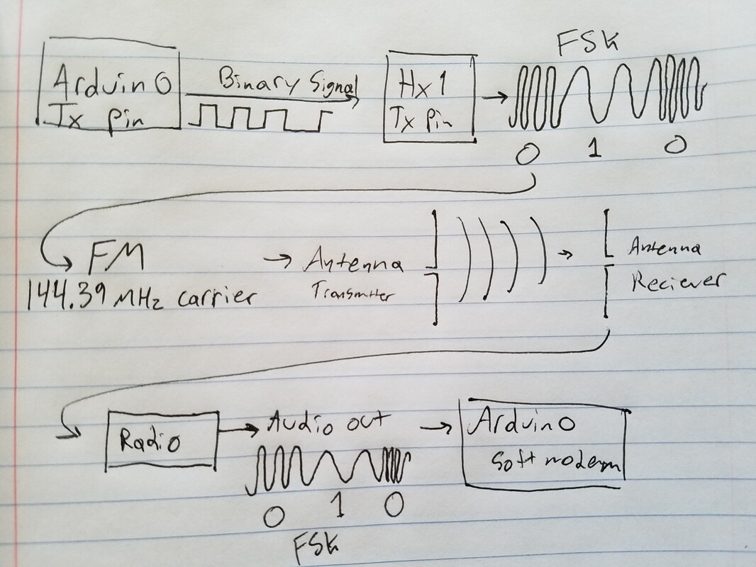

There is no schematic attached to your first post. Later you posted this:
I don't see anything here that indicates an AUDIO =>TTL or TTL => AUDIO interface in your system.
Audio signals must be capacitively coupled and voltage biased to 2.5V to interface to an analog input.
I don't see any oscilloscope screenshots for inputs or outputs. (until later in your most recent posts)
You certainly get an "A" for AMBITION, but I would give lower marks for planning and execution because you are interfacing very different types of circuit blocks.

The diagram wasn't meant to include everything, it was just to show where I think the two different types of signal modulation are happening, FM and FSK, to make sure I wasn't mixing them up. I do have a capacitively coupled receiver. The schematic was available in the link to the micromedem I said my circuit was based on, but it probably would have been better to post it here too.

Update: I looked through the code and schematics of the APRS Trackuino project, which uses the HX1 as the transmitter. Trackuino: Trackuino Shield
As you will see, the TX input on the HX1 is analog 0-5V, and the 1200/2200 Hz AFSK modulation of the HX1 carrier is generated by the Arduino using fast (62.5 kHz) PWM. I'm surprised that no low-pass filter is used between the MCU and the HX1 input. The Trackuino software is quite a sophisticated package.
The microModem TX output isn't directly compatible with the HX1. With an amplification stage, the combination might be made to work.

In order to use this transmitter for APRS, one would normally need quite a bit more information than is given in the HX1 data sheet. I'm certainly puzzled about how it is supposed to work!
I was a bit confused by the lack of information on the datasheet as well. I didn't even know it would produce the two tones on it's own until you pointed that out. That's why I was trying to feed it an already modulated signal. Modulation is probably the wrong word for using tones to represent bites, but i think you get what I mean. I saw that comment before you edited it, I'm not that dumb, but it might appear that way because I'm pretty bad at communicating my thoughts. English is not my strongest subject but I'm only 19, so I have time to work on it.
I'm just going to think out loud about this for a bit. The HX1 is available in multiple frequencies, so the list of other applications may be referring to other frequency models. Since 144.39MHz is reserved for APRS in the US it shouldn't be used for other things. If it's producing the two tones on its own, it must be the standard 1200 and 2200 then. It did mention in the datasheet that it can send data up to 10kbps [Edit: 3kbps]. That tells me the baud is variable, so either data in is limiting the baud, or there's a way to tell the transmitter what baud I want to use. If there's a set of commands I can send to it, it certainly did a bad job of informing me on the datasheet. My impression is that this is a dumb transmitter. It's just going to take a signal in, and emit FM. Unlike what I would call a smart transmitter, that I can send commands to set baud/tone frequencies. I'm going to do some experiments. Write a byte to the transmitter, and see what it looks like on the receiver. I'll look for the two tones and the baud rate on the receiver and compare it to the signal going into the transmitter.
