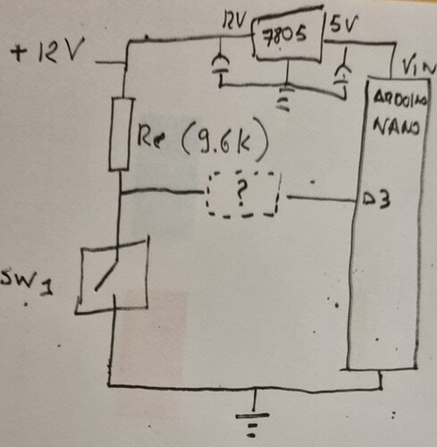

I need to "read" the state of a push button connected between +12V and GND using an arduino.
I made a simplyfied scheme. I can access switch terminals only (and the arduino side as well). As I can see, is a Pullup configurations and i'm not sure i can connect it directly to arduino digital pin.
I'm not much into electronics and i really need your help.
Thank you in advance
G.

Yes I can but i don't know how if it would change in any way the pushbutton logic (i mean, the button is somewhere connected to the car "computer" and is used by the car to select one of the gears (DNR).
I dont have any other info.
The oly thing i know is that Voltage between the pin and ground is 12V and current is 1.25mA (thus the 9,6KOhm equivalent resistor). The pushbutton simply shortcircuits pin to ground (so the scheme i posted).
I would use 18K for the upper resistor and 10k for the lower, the junction voltage will be about 4.3V and the 18k will protect the input pin from 12V in case of a circuit fault, the 12V - (ground) must be connected to Arduino - (GND).
The upper Resistor is not under my control
If you add a 2.2k resistor in parallel with the switch, what voltage appears across the switch ?
with a resistor as partitor, I would close the circuit and it would act as closing the switch, isn't it?
have to test, tomorrow (now is 1am here) :slight_smile:
Make the lower R 4.7k, the junction voltage will be about 3.9V.
4.7 / (4.7 + 9.6) * 12 = 3.94V.
R3 and R1 in series protects input pin from 12V in case of circuit fault (loss of ground connection).

The question mark in post#1 could be a (1N4148/1N4004) diode, with cathode (ring) connected to the switch. With internal pull up of the pin enabled with pinMode(pin, INPUT_PULLUP);
Leo..
I was thinking analog input, so like this?
New-Project(2)
Yes.
The switch can pull the pin to ground,
but the diode prevents 12volt to flow into the pin.
Leo..
Thank you all. I did not consider the diode but is the solution. Now i go with the second part of my problem and a thought about voltage regulators
