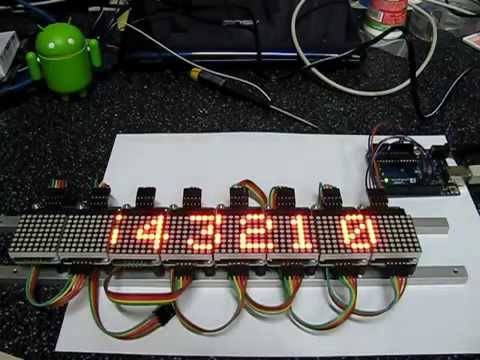

Sorry, this YouTube shows six modules being run off a Uno's (?) VCC. No indication of the current drawn but, by popular reckoning, this SHOULD be drawing 6 X 170ma OR 6 X 200ma judging from some of the patterns drawn. 1.02A to 1.20A?
Can you draw that much off a Uno's VCC? OR is it drawing MUCH less? 8)
No.
Given the above then probable yes.
