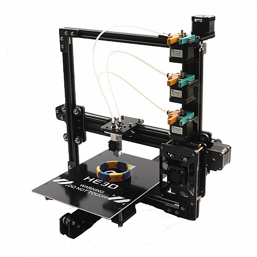

Whilst dual extruder is not a must for me it would certainly be nice to have to be able to swap filament colours.

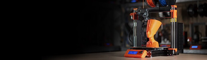

My son bought 2 genuine Prusa I3 printers for the library that he works for. They were kits, but easily assembled with good instructions. They have auto bed level and many modern features that make them easy to use. A bit on the expensive side (my opinion) but in the end worth it.

I would suggest the prussa i3 for a starter printer.
It comes standard with the most common upgrades you’ll want to make from the cheap kits so why not skip all the upgrading and get a printer that is already upgraded.

i don’t think dual extrusion is worth the headache honestly, though my printer is set up for dual extrusion...
