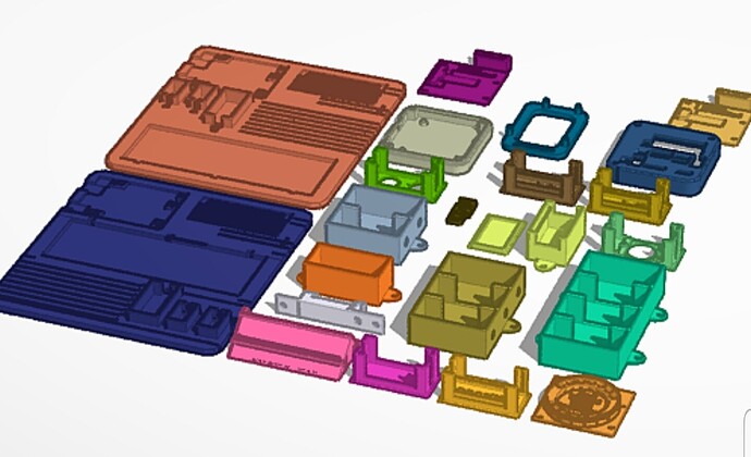

For now the printer is more of a why pay for a print if i can buy a entry level one to make these pcb enclosures that store wont budge off the 450 quote.

I cant wait till i have all my issues figured out in terms of storing these parts with no risk of esd or rattling about when on the bus or being pulled by my bike wagon. So i can start asking less situational questions and just post why my sensor wont work lol.
