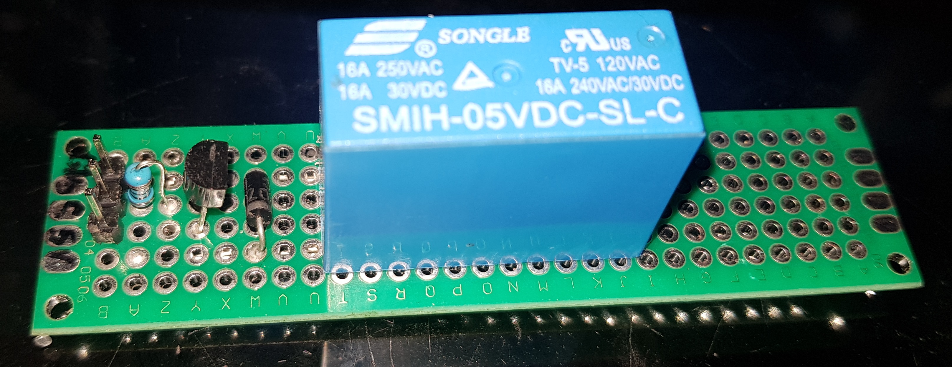

I've made a relay board to switch a relay using this simple diagram I found on circuitdigest.com
On startup it briefly triggers on off, after that it works fine. How can I prevent the relay from doing that?
Parts I used
Relay 5v SMIH-05VDC-SL-C 8Pin
BC547 transistor
1k resistor
1n4007 diode
Diagram

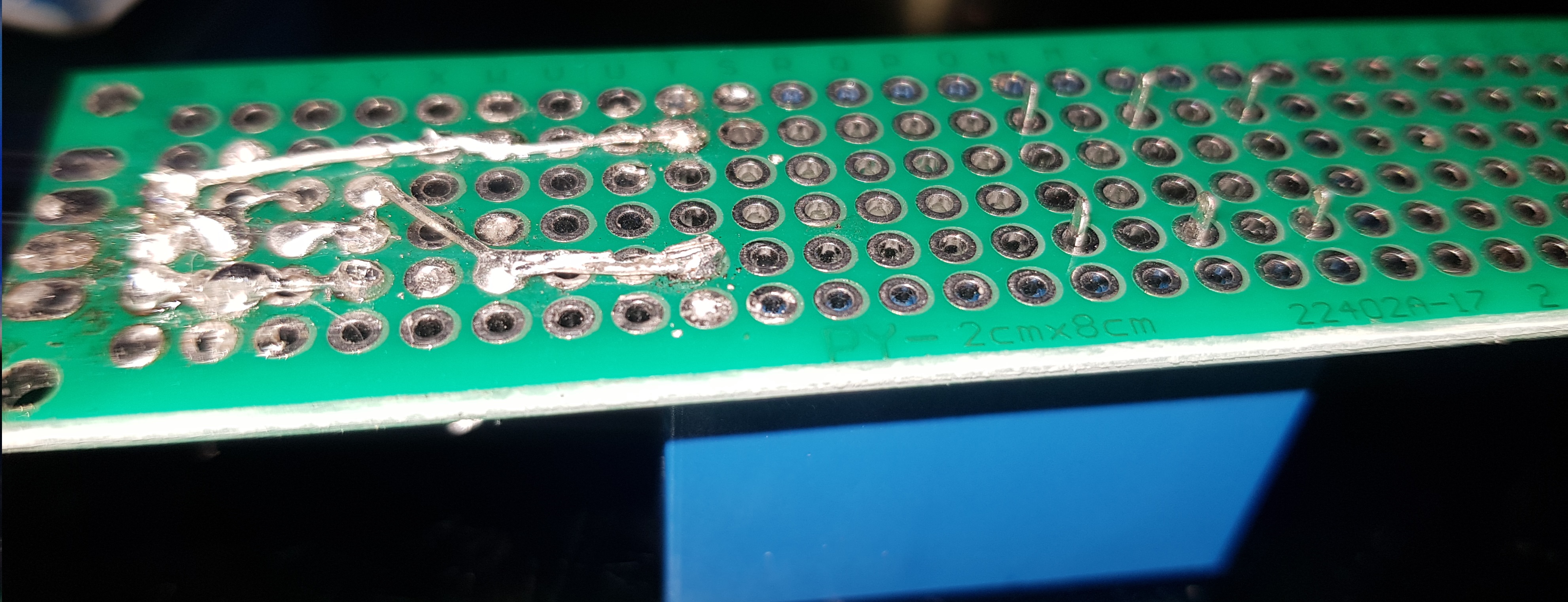

Sounds like you might have the load connected to the NC relay terminal and turning the relay OFF to turn the load ON, post a clear picture.
sure
topside
