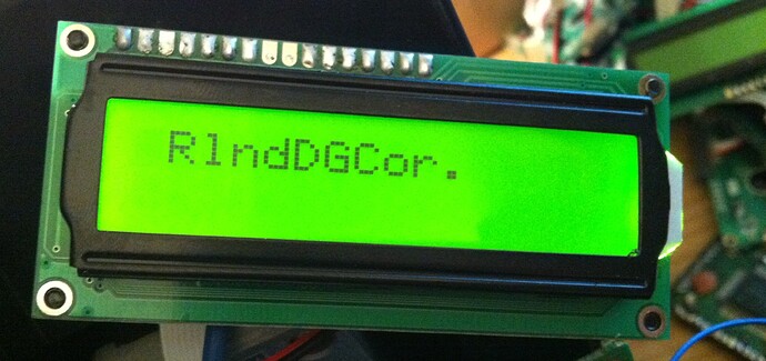

Now i got thinking, there is something weird regarding the HD44780 regarding the memory mapping over different sizes of displays. I tried attaching a modern 16x2 display and it's the new type with a black "blob" on the back - i guess the controller is the KS0066 or a similar clone.
Now the unit powers up like this:
Hmm, "RlndDGCor." - Now display addressing is working correct, but characters is dropped during transfer.

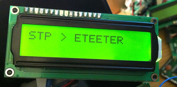

The setup menu which should say "SETUP > ENTER" now says "STP > ETEETER"
For kicks i tried attaching a 1K pullup/down (both tried) on RS, RW, EN-pins in succession - it changed the written text on display a bit in some configrations, but not much.
I am going to whip out the logic analyzer next, and have a look on what's actually happening, because i can't figure it out right now.
Now, what is happening ? Any good ideas for stuff to try ?

Here are some observations, in no specific order, that may help.
I found this on another ROHM datasheet - I'm not sure what significance it has:
RCD: Liquid crystal display element
RCM: Liquid crystal display module
Your RCM2122 data sheet is very similar to that of the Hitachi HD44780U. The big difference is in the DDRAM Address section where, with this device, the addressing mode can apparently be changed.
If you follow the LCD Addressing link at http://web.alfredstate.edu/weimandn and scroll down to the information about the 16x1 displays you will find some background information about these two addressing modes.
The 'old 1x16 Sharp LCD' that you tried appears to be internally configured as an 8x2 which would have a memory map identified as 'Addressing mode 2 (A=1)' on the RCM2122 data sheet. I suspect that your original (broken) display had the other memory map which is why the 16x2 display that you tried could display more than 8 characters.
Your pinout list has only 13 pins identified. I assume that D0 belongs in there above ELCD.
My guess is that ELCD corresponds to the E (Enable) pin. If not you wouldn't see any characters on the display and certainly not your almost correct 'SETUP > ENTER' display.
This leaves A2 corresponding to R/W and A1 corresponding to RS. This probably isn't exactly correct since your display is missing alternate characters.
Perhaps the ability to read from the controller has been disabled and pin 5 (A2) is being used to choose the memory map. Your logic analyzer may shed some light on this.
Don
