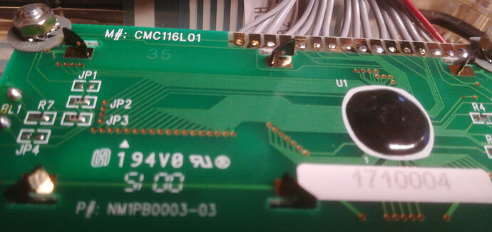

I have a farming machine where the LCD stopped working. It is a 16x1 Display and on the Backside "cmc116l01" is written on it. Can I replace it with any other LCD Display which has 16x1 and the same inputs or is this a waste of time?

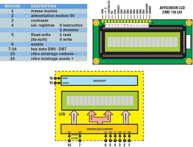

I added a Picture of the LCD Display and one of a description on a cmc116l01 Display.

It looks like it uses the typical/standard 5v hd44780 pinout.
That said, there are two types of 16x1 displays and they internally address memory/characters on the display differently so while they both work the same electrically, they don't address the characters on the display the same way.
1 type is an actual 16x1 display and the other actually a 8x2 with the 2nd line or 8 characters butted up to the first to form a single 16 character line on the LCD display.
This makes addressing the characters for the right 8 characters work differently on the two displays.
You want to wait for Don "Floresta" to chime in as he has the most knowledge on the 16x1 vs 8x2 displays and how to identify them.
You also may want to verify the voltage. Look at the voltage on pins 1 & 2 and verify that it is around 5v.

It looks like your display uses only one HD44780 chip (epoxy blob) so it is the type that performs like an 8x2.
You can replace it with another 16x1 that has only one chip but not with the kind that has two.
A 16x2 display should also function without any smoke but your messages will be split in half - with the 8 characters that should be on the right hand side positioned underneath the 8 characters on the left side.

I wouldn't use a 16x2, even if it fits in the original device, the information on the display would not be correctly formatted as it would split across the two lines rather than being all on one line.
I'd look for a 16x1 display. Depending on how fast it was needed might determine the source.
The other thing we don't know is the font size on that display.
Most of the displays I see use 5x8 dot font size vs the larger 5x10 font.
Assuming it was a 5x8 dot display and there was time, I'd just order one/some from Ebay.
Several of the vendors on Ebay show the back of the LCD module so you can verify the type of display.
