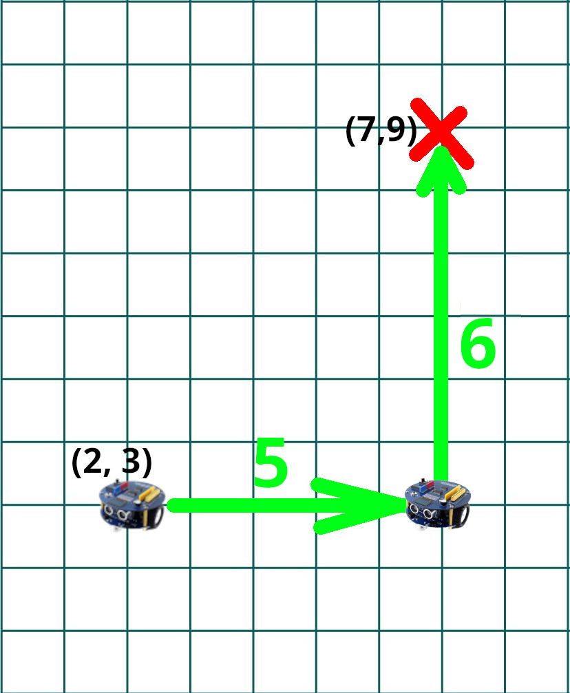

Replicating an Obstacle Avoidance + Go-to-goal Rover

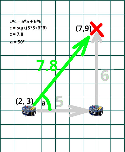

Hello, so I have a project about making a rover that goes to a certain x,y coordinate (goal) whilst also having the ability to avoid any obstacle hindering its path toward the said goal. I found an old YT video here, which is exactly what I intend to do. The only problem I have is that it's outdated as hell; it was made about nine years ago.
The owner of the project did not provide any wiring diagram for the hardware, but I got lucky because he managed to share his source code in the comments section. Here it is:

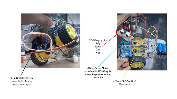

From what I've gotten in the video, he used the following materials
  • L298N motor driver, a
  • PING ultrasonic sensor (since he only had 1 pin dedicated for in the code),
  • 2 DC motors (of course),
  • A servo motor and
  • 2 pcs. of speed encoders

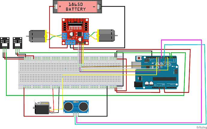

I attached an image of my hardware and a Fritzing Wiring diagram to understand my connections better. Also, I used a 7.4V, 2200mAh 18650 battery to supply the motors.
The thing I changed in the source code is within the "ultra()" function. Since I added it, I have more pins assigning the trig and echo, respectively. Also, I changed the Opto Pins from 1&0 to 2&3 instead because I thought hardware interrupts in Arduino UNO were only possible in pins 2&3. Here are some notable changes:

Thanks for the comments; I didn't know the words were even Indonesian. I am already aware of how servos and ultrasonics work. I also found possible reference source code that I could use to make an obstacle-avoiding rover
My only problem is setting a "goal" in the first place. Like how exactly can I map a specific coordinate with the use of the encoders?

I was skeptical about the sketch you found even functioning, but I put your sketch in the WOKWI.COM simulator and it "worked"... and without libraries (helper functions). I posted the sketch with my own comments (see "sketch.ino edited with comments").
The beginning of the video says the field is 180cm x 50cm, so the area is known. The "d1 - d5" and "t1 - t5" seemed to be a grid. The M1_1...M5_3 (and Mx1_1...M5_3) seemed to be a "left/center/right" vectoring from the start to the goal. The interrupt service routines seemed to be using an encoder to count (left wheel, right wheel)... and the math parts did a bunch of trigonometry. I now realize that I commented "velocity" when I should have commented "vector"...
The sound sensor was standard. It added a sweeping servo to get three distances (L/C/R) for avoiding obstacles, rather than three sensors. The motor movement was enhanced with PWM to move wheels at different rates to make subtle turns.

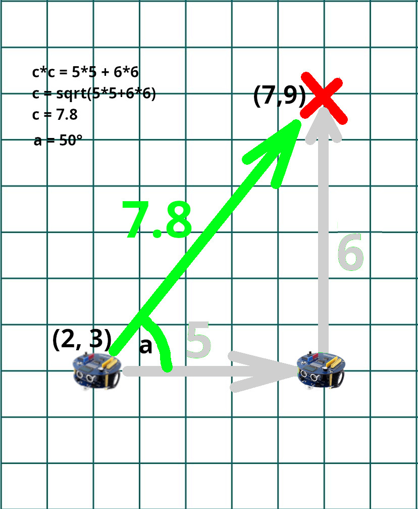

A small step in the "goal" direction would be to use vectoring. If you know you are at 2, 3 and your goal is 7, 9, you need to move 5 in the x direction and 6 in the y direction and make your motors do exactly that.
You could then learn to calculate the angle and vector connecting the two points and go straight from one point to the next.
Next, if an obstacle is in your way, count how far away from the perfect vector you wander and keep trying to return to that vector, or re-calculate a new vector.
The "goal" begins with this: c^2 = a^2 + b^2.
