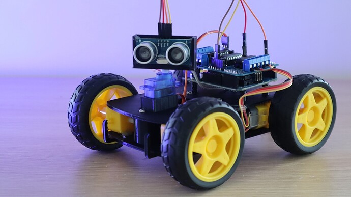

I am trying to drive an obstacle avoidance robot (using a regular ultrasonic distance sensor) using 4 continuous rotation servos.
Is this possible? and if so how?

Why four?
Those things are notoriously difficult to drive at a given speed.
Yes. You drive it like any four-wheel-drive skid-steer object-avoiding car that uses DC gear motors except you use the Servo library to drive the motors instead of four H-Bridge drivers.
https://create.arduino.cc/projecthub/jojessegaming/4-wheeled-obstacle-avoiding-car-87f494
https://create.arduino.cc/projecthub/adam/obstacle-avoiding-car-a192d9

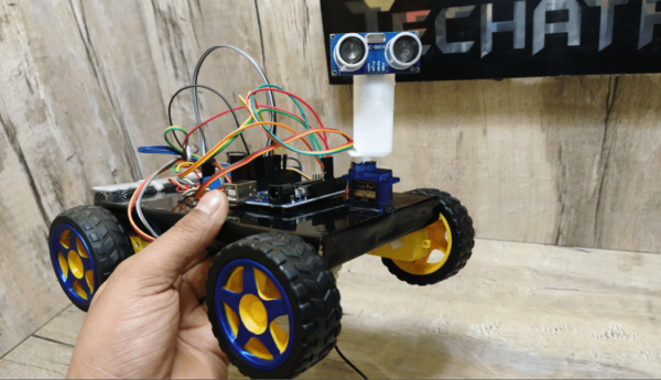

Thank you for the reply but I am a noob to Arduino so if it would be possible for you or someone to explain it briefly and what I would have to change in the regular code I will be grateful. I also do not have a motor driver and have to make the project without it.
I was thinking of making one of those skid steers with an ESP 32 too so two things in one I guess.

I see but when I modify the code to suit my needs I get an error regarding the distance sensor(I am using a grove Ultrasonic Distance Sensor.
Here is my code:

I am getting the error: no match for call to '(Ultrasonic) ()' and: 'cm' was not declared in this scope
return cm;
To figure out how to use the Ultrasonic library, look at the UltrasonicSimple example that came with the library: File > Examples -> Ultrasonic -> UltrasonicSimple
Thank you, could you please review this code?
