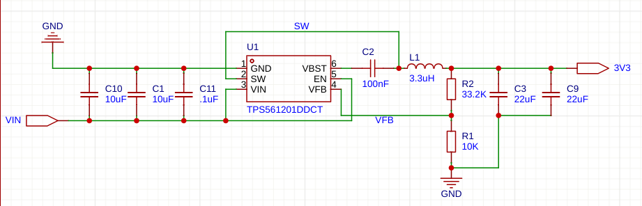

Here are the schematics:
Before I order the PCB, it's my intention to test at least the motor circuit to verify that it works as expected with my power supply and ESP32-S3 devkit. However, I do not know how I can reasonably test the rest of the circuit without ordering the PCB. For example, it is difficult to install the TPS561201DDCT on my breadboard, and I don't have all those resistors, capacitors, and inductors outside of the 0603 assortment kit I'm getting.
Therefore I come to you for advice. What do you do to pretest PCBs before you order them? Is anything obviously wrong with my schematics or the PCB I've designed? I thank you in advance for any feedback! If anyone wants to dig into the schematic on EasyEDA, please let me know and I can share a link.

Gosh darn, I can't complain; you did a fantastic job doubling the bulk capacitors and adding bypass capacitors. It's smart to have the design reviewed before building; that can save a lot of headaches later in the project.
I'm not entirely sure about the 0603 parts, though. They are quite small. I've been using 0805 for a few years, and their size can be a real pain, especially if they’re placed too close together for hand soldering. That said, there’s nothing wrong with 0603s—they’ll work great if you’re comfortable with them.
I didn’t check all the schematic connections since I’m not familiar with every part, but overall, it looks good to me!
  • Have not looked at your schematic circuit for accuracy.
  • Suggest you add a switch to the EN pin going to GND.
  • A power LED is nice to have.
  • Add mounting holes to the PCB.
  • Always nice to have a diode in series with the power jack.
  • Suggest you add the option for a few off board switches and LEDs (include GND pads) because you might need them.
    :wink:
  • Agree 0805 would be better, 1206 if your abilities are challenged.
  • Have you ever soldered an ESP32 castellated chip ?

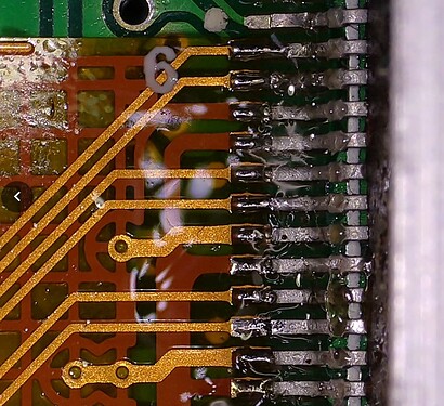

  • I have also soldered a ribbon cable to the pins of a Nintendo 64 CPU (PQFP -- not sure exactly the pitch but it's small). This is my work:
For this reason I'm hoping I'll be able to manage the ESP32's pads and 0603 components. I have also hand soldered 0201 components but it wasn't fun!

For this thing: that will cause a voltage drop, right? If so, that would imply reduced peak power for the motor. If it's a concern for me, should I then upgrade my power supply slightly to account for this? I.e. use a 6V supply rather than a 5V one?
  • A Schottky Diode will drop ≈ 0.3 volts.
  • Suggest you forget about the switching regulator and use something like the AMS1117-3.3 voltage regulator, 6-5V for Vin is fine.
  • What current is needed for the motor ?
  • A microscope makes soldering the ESP32 relatively easy.

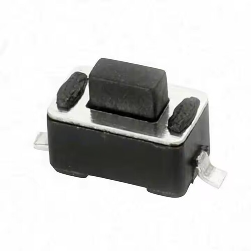

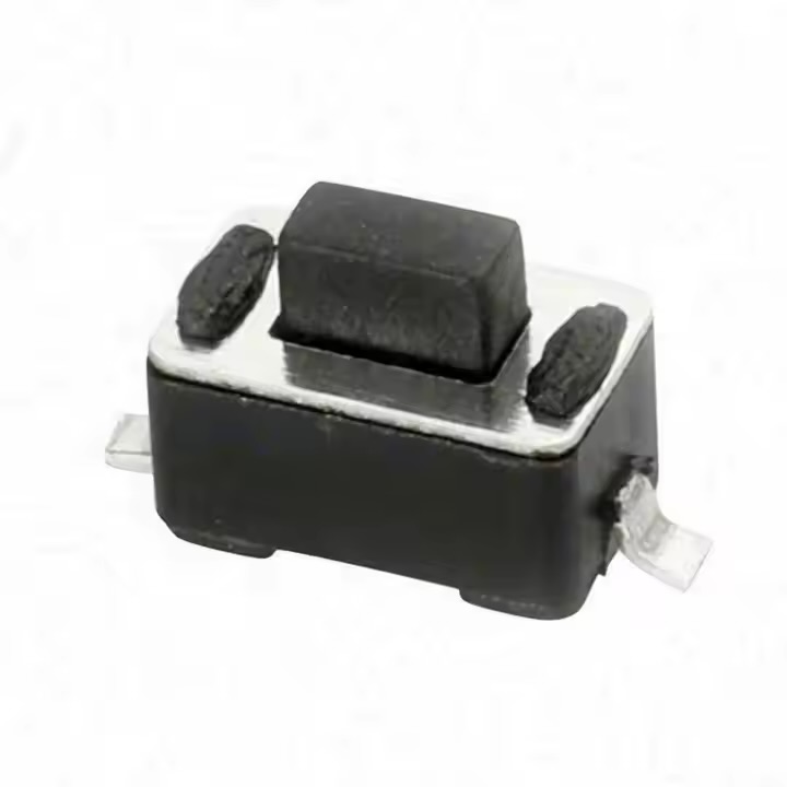

  • These switches are smaller form factor.
