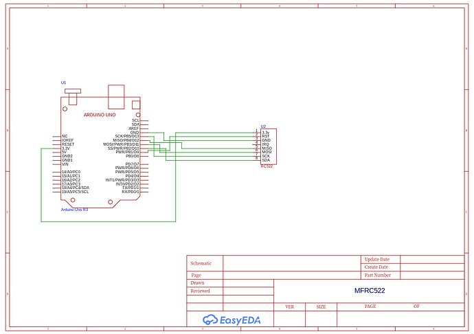

I have a MFRC522 but when I try to read the tag it does not disply anything in the serial monitor. It only displays this at the start of the program:

Sorry @ruilviana , I'm very new to this. So I have the arduino UNO R3 and I have uploaded the MFRC522 library example "DumpInfo":
And in case you need it, the code.

and I have this schematic:
Does that help?
Your Uno R3 is a 5V board. It uses 5V level signals.
The RC522 is a 3.3V board. It uses 3.3V level signals.
I don't see any level shifting between the two. That's a problem.
So if I connect it to the 3.3V pin it should work? If not how do I fix it.
You need to shift the 5V output level signals from the Uno R3 to 3.3V level signals before they get to the RC522. A 74AHC125 is suitable for the task. It ends up looking something like this:
I don't have a lot of money. Can I use something like a series of resistor or something to do the same thing?

Schematic

Does your wiring follow the schematic exactly?
Did you solder the RFID board yourself?
What kind of tag are you trying to read? One of the ones that came with the reader?

All pins connected except IRQ to my Uno R3.
+3.3V power to MFRC522 on 5V Arduino.
Scanned two different tags (clones), Serial output as follows

I DON'T HAVE THE IDE!
It follows the schematic exactly,
It came pre-soldered from the Elegoo complete starter kit for UNO,
and yes, these two came with it:
Photos
IMG_20240719_165437
IMG_20240719_165459
You could try adding this line to void setup()
mfrc522.PCD_SetAntennaGain(mfrc522.RxGain_max);
What are you using to upload code to your Arduino? And relax, ok? I'm not in customer service.
OMG!!!
I pluged it into the 5V and it worked!!!!!
Thank you all @hallowed31 , and @van_der_decken !!!!!
