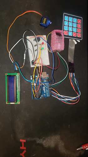

Safe using arduino with keypad and finger print reader
I am building a safe using an arduino uno with a keypad and finger print reader. The safe always opens even though no finger is placed on the reader. Any idea how to fix this?

Your correction is still opening the safe even without any finger placed. I think the main issue with the code is that the " bool validateFingerprint()" isn't correct. btw I have no coding experience.
do you have registered your fingerprints in fingerprint scanner?
upd. try now.
Yes, I have 4 different fingerprints registered.
Maybe you should test it one by one. If a fingerprint doesn't works, it means your code have problem.
wrong was this
if (fingerprintID == -1 || finger.confidence < 50)
and it is not his code, probably ChatGPT
Wow! Thanks for your info.
Thank you very much everyone. I got one of my professor to help me out. It works now. I have also attached the working code if anyone is interested.

Hi, i was wondering if you could post the schematics/wiring of your work. Coincidentally I'm making a door security system for a project with the exact same components, your work is the closest I've found ( most of don't have a fingerprint sensor combined with all the other components). I would greatly appreciate it.
Here is my exact wiring.
