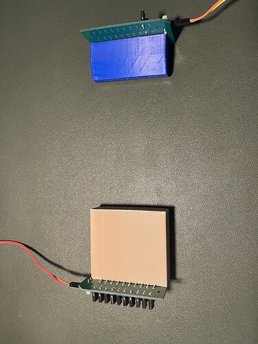

Hi everyone,
I'm designing a low-cost photodiode beam break detector grid and have run into an issue that I haven't been able to find answers for in other photodiode related posts.
My design requirements are:
  • It's a grid of paired infrared emitter diodes and receiver photodiodes, with the emitter and receiver columns aligned parallel on a plane.
  • The emitter-receiver pairs are spaced 5mm apart, and I 3D printed light baffles between adjacent pairs to avoid crosstalk.
  • Currently I'm using regular infrared emitter LEDs paired with photodiodes at a distance of 40cm. The photodiodes have a rise time of 100ns.
  • The grid needs to detect a 7mm diameter object moving at 100m/s, so the minimum trigger time is around 10us when the object is centered between two beams.
  • The photodiodes are reverse biased to 5V VCC, with a 1M pull-down resistor to GND.
The issue I'm running into:
  • At a distance of 20cm I can get a noticeable voltage change of 1V across the photodiode and resistor, sufficient for detection. But at 40cm the change is less than 0.1V.
  • Using a phototransistor instead I can get enough voltage change at 40cm, but phototransistors are too slow for the speed requirements.
  • Increasing the emitter LED current from 36mA to 70mA helps somewhat, but I'd rather avoid that (too much power draw).
  • The main problem is getting enough sensitivity at 40cm distance. The software side is not an issue.
What approaches could I try to improve this design, getting stable and fast single beam break detection on the MCU, without greatly increasing cost? Or are there other design ideas that could meet the project requirements?
Any suggestions appreciated!
A photodiode with a high value pullup resistor is a poor choice. Photodiodes are capacitors, and the resistor limits the rise time.
For fast response and high sensitivity, use a photodiode amplifier. They are simple to make but some important considerations are required, as described in this publication:
Finally, there is plenty of IR in any ordinary lighting situation. An enclosure to reduce external illumination will certainly increase the sensitivity and discrimination.

Thank you for your suggestion. I tried using the amplifier circuit and obtained very sensitive and stable voltage changes at a distance of 40cm. I observed the rising edge changes on the oscilloscope, and the fastest result I could observe was a 2V change within 20us. I may need a device that can quickly block the optical path and is easy to test, but I found this is not an easy thing to achieve.
Please post a schematic diagram (hand drawn is preferred) and identify the exact parts used. That is extremely slow, suggesting poor choice of op amp or other major design issues.

Update: I obtained a minimum rise time of 8us by changing the two resistors to 47 ohms and 1.5K.

That would be the wrong circuit, and a poor choice of op amp. The LM358, with a slew rate of 0.3 V/us, is designed for signals in the audio frequency range. People commonly use an op amp 10-100X faster.
This is a viable photodiode amplifier circuit, although it lacks a feedback capacitor. See the link in post #2 for better designs.
