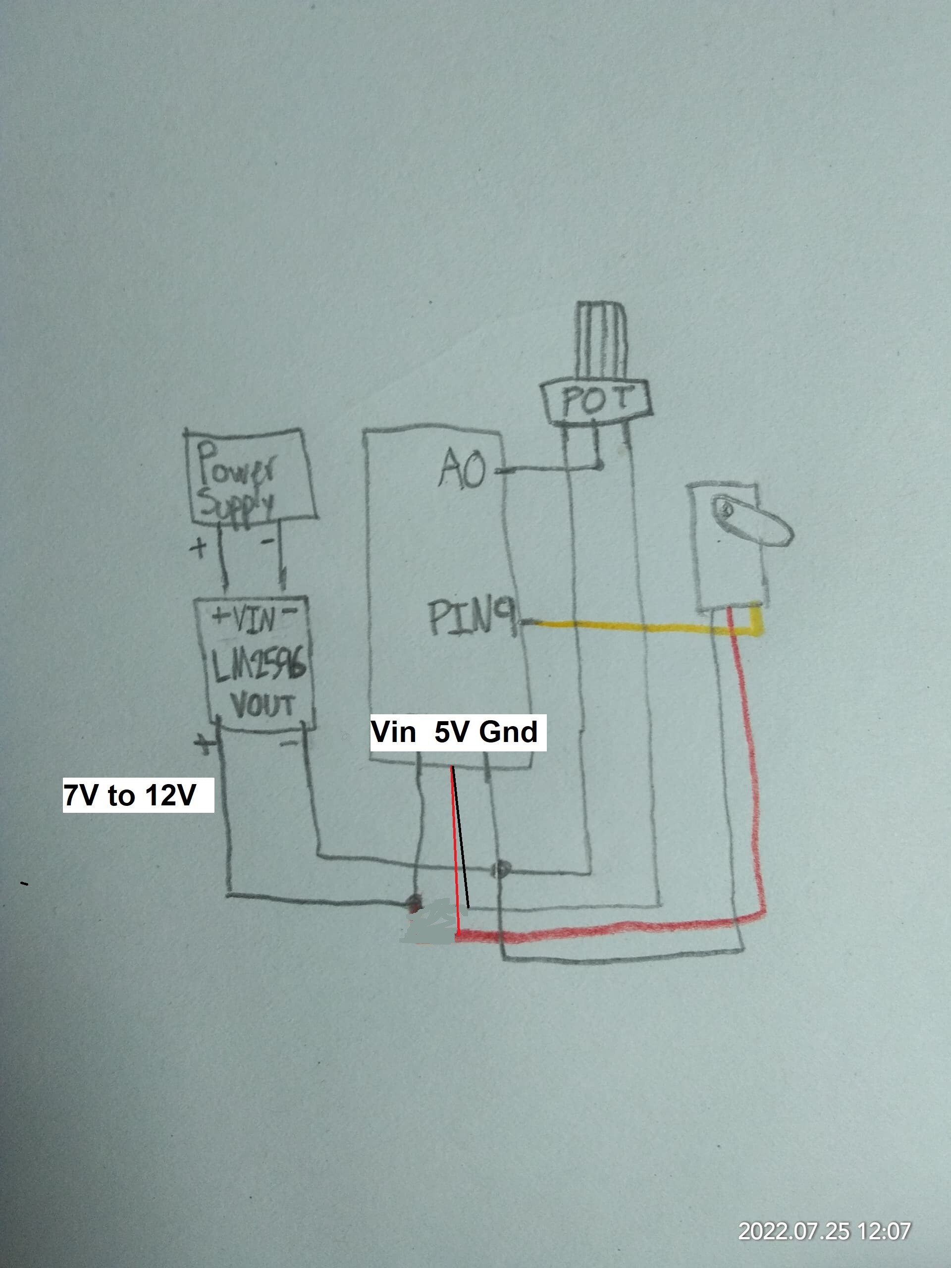

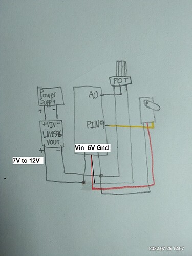

I apologize for the late reply. Here is the picture diagram for the connections.

What is the output voltage of the LM2596 regulator?

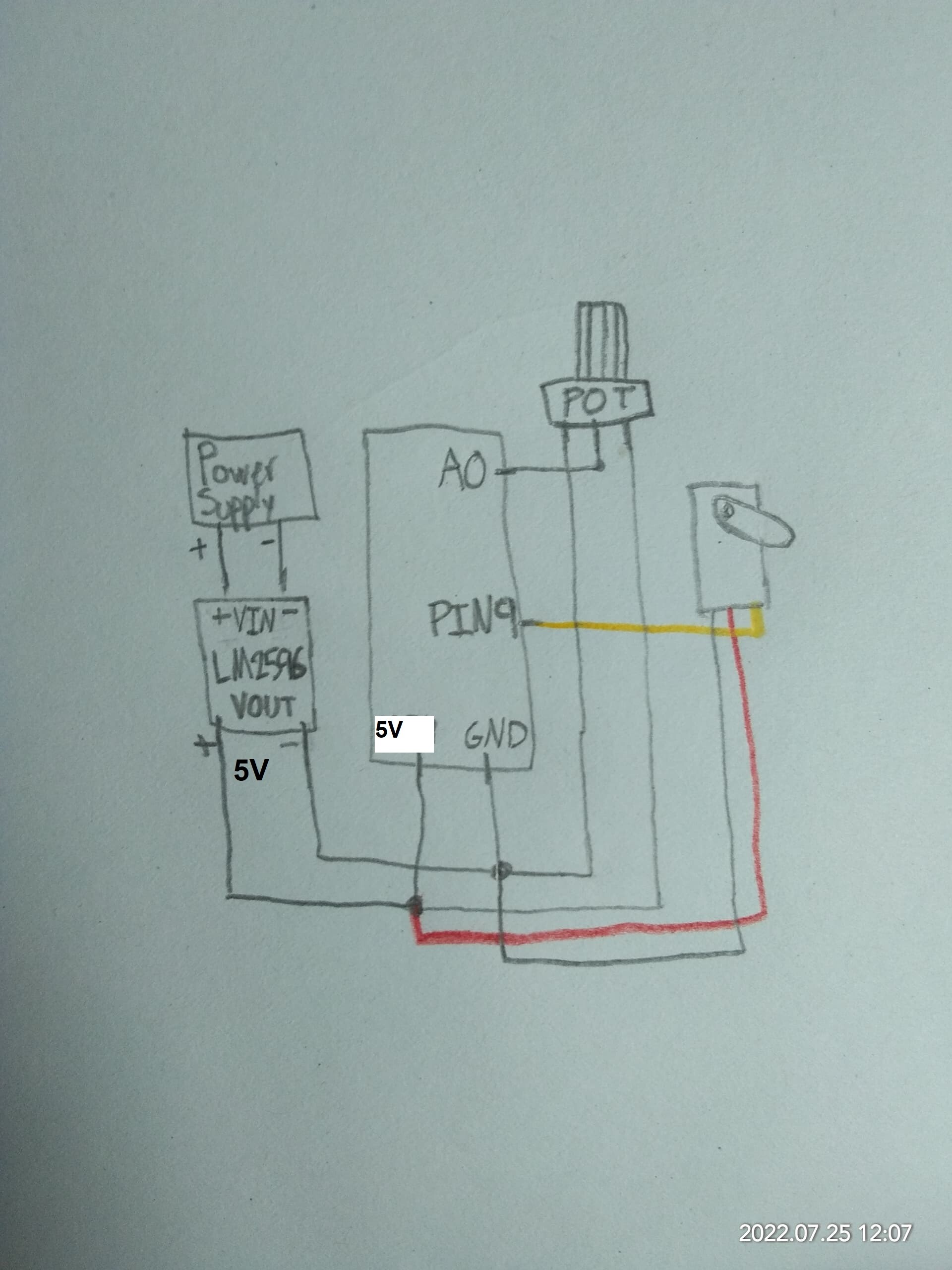

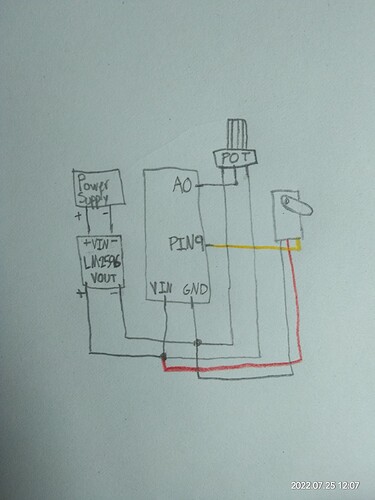

If it is 5V, do not connect it to Vin, connect 5V to the 5V pin. If it is not 5v, it must be more than 7V and connect to Vin or the onboard 5V regulator will not work. If it between 5V and 7V, you need to adjust it. Best is to set it to 5V and connect it to the 5V pin.
The pot should connect one end to ground, the other end to 5V (not Vin), and the wiper to the analog input A0.
Connect the cap to the pot wiper and to ground.
