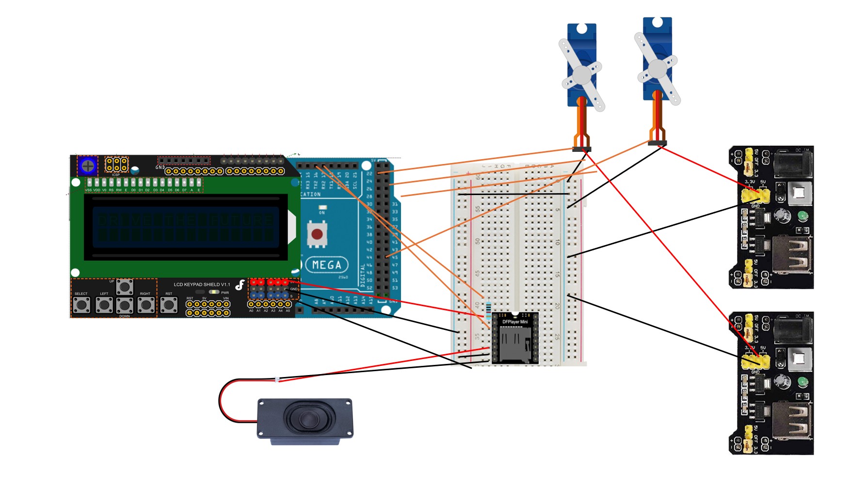

Servo twitching; arduino mega to power w/dfplayer and servos
I am trying to use an Arduino mega as a clock. When the time hits specific values, I want to either: have my dfplayer mini play an mp3 file, or actuate a servo. Right now, I am using the DFROBOT LCD Kepyad Shield for the LCD screen, plugged into the Arduino Mega. I have a 5V power supply board powering the two 5g servos, and I am using the Arguino Mega to power both the LCD, the dfplayer mini, and a small speaker. The code works for the most part: the mp3 file plays at the correct time, and the servos actuate at the correct time. However--sometimes, the servos will twitch/actuate sporadically, especially when the dfplayer mini is commanded and operating. I tried using a separate power supply for each servo, but no change/success. The servos are fairly small, and combined are pulling well under the max for the power supply board.
My initial suspicion is that perhaps I either 1) have a code issue where the servo is constantly reading off a PWM pin, and somehow in the code the arduino is using the same pin or channel for the dfplayer, or 2) I have the wiring messed up and there is a short somewhere.
I did also try (within each if loop for the servo) the sequence of: attaching the servo, writing to a position, and then detaching the servo...I thought the "detach" would fix the potential issue of a dueling pwm channel; However, when I did that, the servo did not respond/actuate at all.
Below is the code I'm using (pieced together based on various arduino forums): I would appreciate any assistance!

What do you suppose your servos are doing while all those delays are delaying in your loop() function?
Servo twitching comes up nearly every day on the forum, and it is almost always due to an inadequate servo power supply.
For two servos, the servo power supply should be rated for 4.8 to 6V at 2 Amperes. A 4XAA battery pack is OK, but a "breadboard" power supply module is not. Don't forget to connect the grounds.
The servo library has some issue with the dfplayer library. I think they use the same timers. I get twitching servos even if the dfplayer isn’t powered but I send to request to play a sound.
That is easy enough to check, which I did. The source code is here: dfPlayer/libraries/DFRobotDFPlayerMini at master · roberttidey/dfPlayer · GitHub
The only reference I could find to a "timer" is millis(), which does not interfere with the timer used in the servo library.
There may be some other problem, but the servo power supply capability should be checked.
You got some bad advice, namely this:
SoftwareSerial softwareSerial(PIN_MP3_RX, PIN_MP3_TX);
Software serial could interfere with servo timers, and there is absolutely no point in using it on a Mega, which has four hardware serial ports. Use Serial1, Serial2 or Serial3 instead.
Please provide more details on exactly what you expect your sketch to do. For example, at what times does stepper1 move its arm, to what position does it rotate, at what speed, etc? My LCDs are I2C so for now I've stripped all that code to focus on the DFR and servos, but need a fuller description.
And a schematic please, ideally after you've changed to using hw serial instead of software serial, as recommended.
Can't find this in the code. Perhaps you meant "servo1"?
Indeed I did, thanks! Actually 'Servo1' :slightly_smiling_face:
Could you investigate and post the results? After correcting the power supply situation, your observations might help the OP (and me).
Will do
Ok so, my issue is that I am using the SoftwareSerial library to communicate with the DFPlayer. I am doing this because I am using a NRF24_Nano and it only has the one UART, which I use for debugging and so I need to use the SoftwareSerial library; And as we know the SoftwareSerial and Servo library have issues with their timers. As fo the OP, he may be seeing the same thing if the code hasn't already been changed to use the other available UART ports.
Thanks everyone for all of the help and suggestions! Below is the updated code. The servos are still sporadically twitching, although they DID stop actuating each time the dfplayer mini is commanded to operate...here are the things I have done:
-- Switched from softwareserial to serial.
-- Attached each servo to their own individual power supply (power supply each rated for 3.3 and 5V outputs with <700mA, and each 5g servo operating voltage of 4.8-6V, with a 20mA standby current and no-load current of <110mA).

That is not good enough. The "5g" servos can draw up to 900 mA each, every time they start moving. Plan on 1 Ampere per servo, absolute minimum.
If you want your project to run, the very least you can do is give it an adequate power supply.
Finally, keep in mind that breadboards are intended for temporary experiments with low power logic circuits. They are not designed to handle the current required by motors and servos, and the tracks will burn.
Connections between motors or servos and the power supply should be soldered or made with suitable high current connectors, not through a breadboard.
Will try to reproduce your project later today but couple of points meanwhile.
A schematic should show what you are physically now using. Especially power supply here as that's been a major discussion topic. You shouldn't be expecting us to take account of the modification/improvements you've written about.
It's good practice to use red for +ve wires and black for 0V wires. And for critical adjacent connections (such as TX & RX here) to use different colours.
You were using Servo but I note you have changed to VarSpeedServo. Why?

No reply to questions I asked in post 7 yesterday, but I did take a look at your latest sketch.
