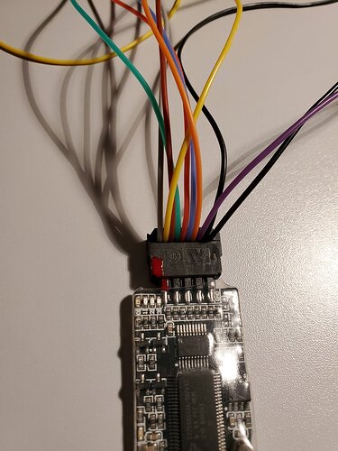

I like many have fallen in love with silicone wire.
I recently purchased a low cost Logic Analyzer (which works great). The inputs were a simple set of 10 male pins.
I wanted to make silicone leads but didn't want the difficult to insert standard duPont connectors.
So I took #28 silicone wire, laid then in what I think is a pretty standard color/channel pattern.
I taped the wires together (temporarily).
Then I inserted them into a good quality amp IDC 10 pin connector. Squeezed it shut in a vice, tested and viola I have a very flexible set of logic test leads.

What made me happy was how well they work in the IDC connector :slight_smile:
It may only be 16 strands but its as limp as cooked pasta (al dente). And its much better than the duPont jumper wires. I use the #28 for everything but power, then I go to #26 (or maybe #24). All my runs are relatively short so the wire resistance is trivial and I can leave a small PCB on the bench without the wire taking "it away".
IMHO PVC wire is so "yesterday"
UPDATE: The IDC connector I used was a TE (aka AMP) 1658620-1 (10 position)

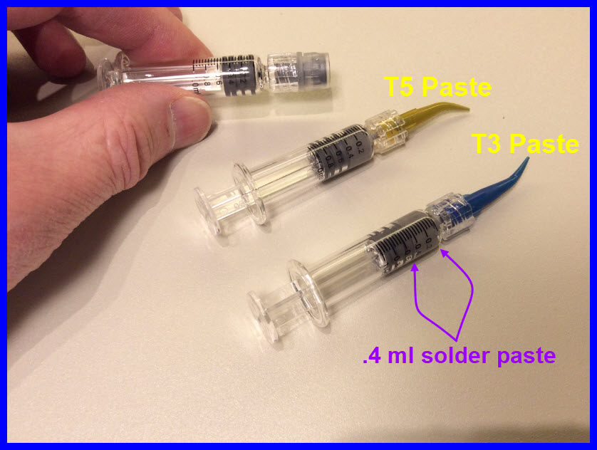

Hi, I'm looking for a suggestion on soldering 7 SOT-223 Fets. I have a "hot plate" that I've used in the past but my issue was getting the solder on the pad area. I was thinking of spreading the solder past on a flat surface at some thickness. Then using the Fet like an ink stamp to pick up some solder.
Thoughts?
Using it as a stamp kind of works but moving the package soon spreads the paste around on the pads.
I use a syringe, these are small and easy to use; I like my paste fairly thin.

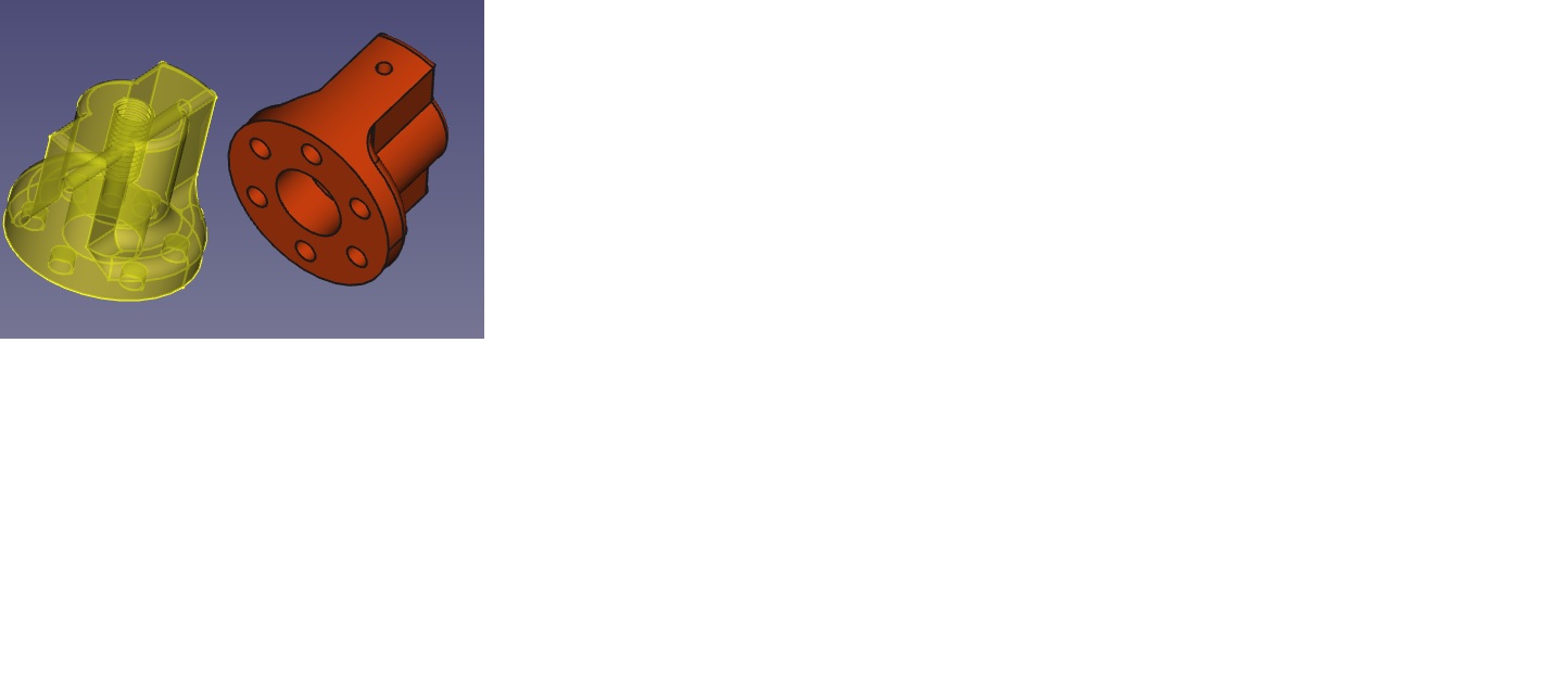

inspired by Larry's holding device but not having any big magnets on hand
i made these on the 3d printer for 10mm and or 3mm magnets
with a m5 thread up the middle and a 2mm spoke hole
pity i can't upload the stl
If the problem is the file extension name, wrap the file in a zip file to be able to upload it.
too easy, the stl zipped
larry.zip (969.1 KB)

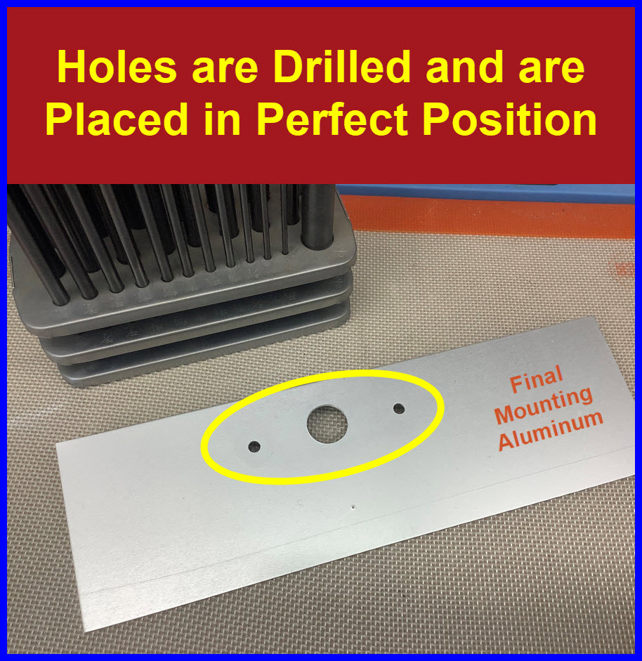

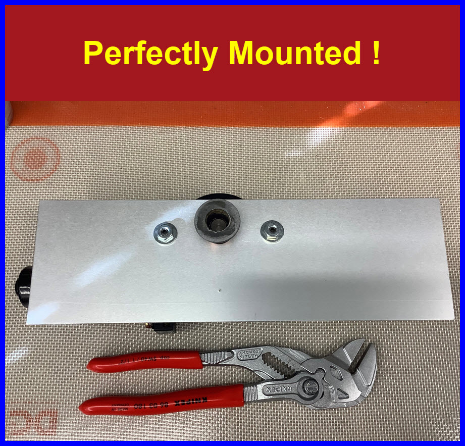

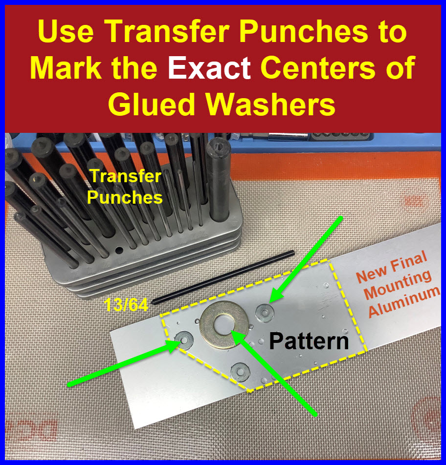

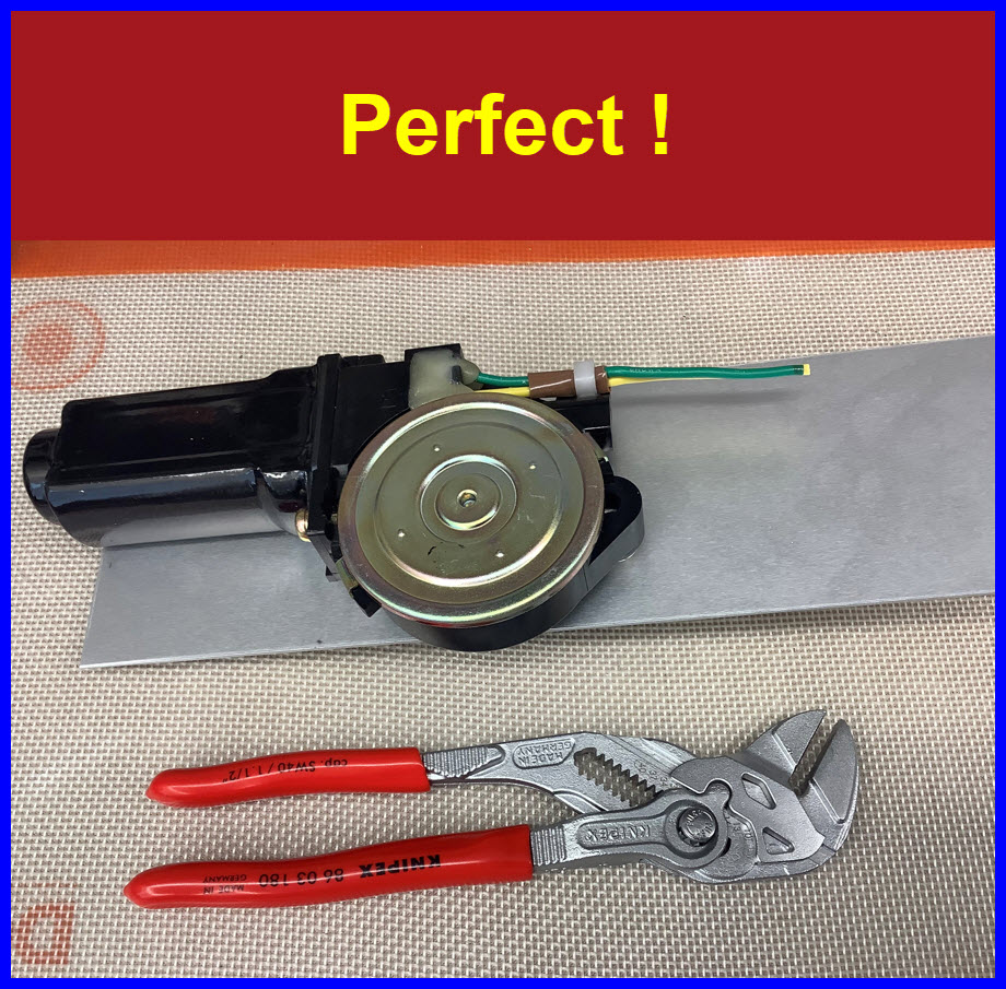

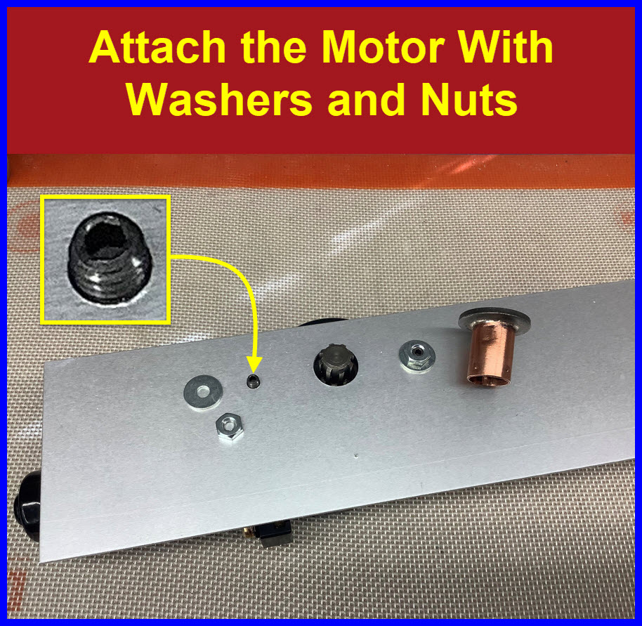

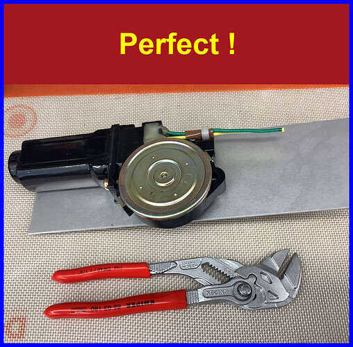

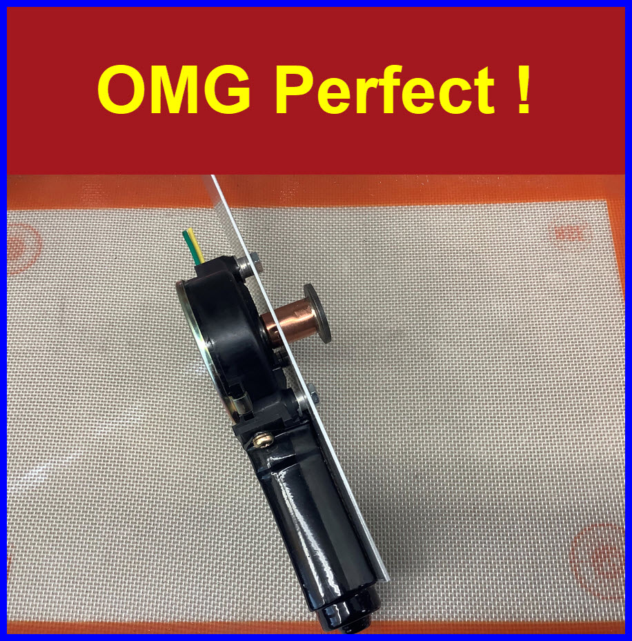

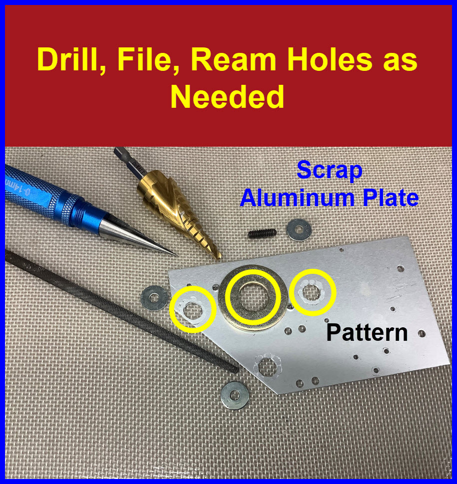

Mounting Hardware on Panels, Chassis, etc.
It is almost inevitable that when you measure and drill holes in surfaces to mount motors etc., you never get things perfect.
The following procedure should give great results to get holes in the correct position.
  • Measure the hole locations needed for your motor, transfer these to a graph paper template
  • Use this template to make a rough pattern on a piece of scrap material
  • Make the holes in this pattern oversized with the motor still being able to be positioned as needed
  • Put the best fitting washers over motor mounting setscrews
  • Glue these washers in place with CA glue, use accelerator
  • Place the pattern on the final surface which the motor is to be mounted
  • Use transfer punches to mark the perfect centers of the washers
  • Drill holes in the final mounting surface
  • Attach the motor with washer and nuts
Edit: you can also use UV glue to temporarily attach the washers.
Collect washers of different dimensions to be used in situations like this to aid in component mounting.
