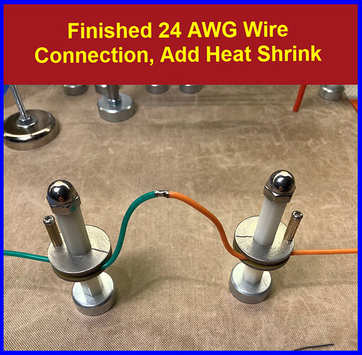

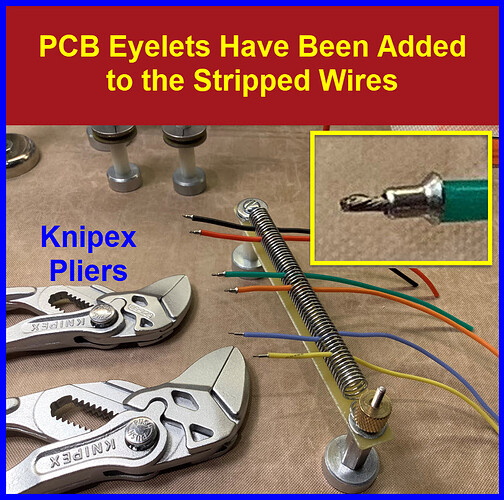

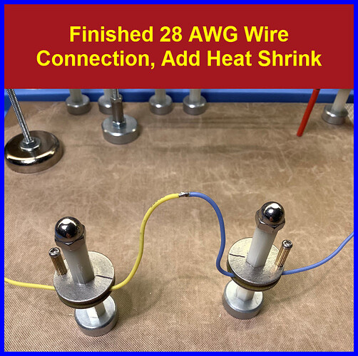

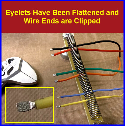

PCB Eyelets Used as Wire Ferrules
PCB eyelets crimped on stranded wires keeps those strands under control.
This process makes wire connections easier and less likely to result in fabrication problems.
The Following images show the technique:
EDIT

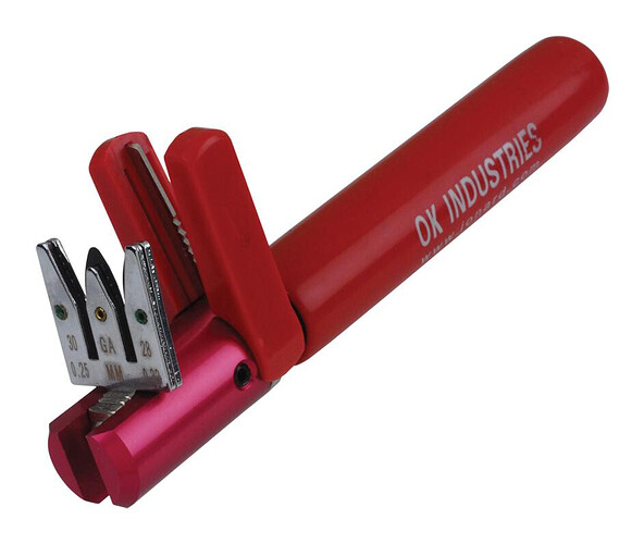

When stripping insulation from wires, highly recommend using an insulation displacement type wire stripper:

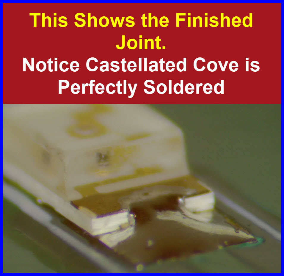

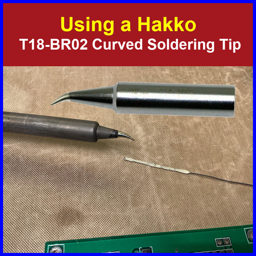

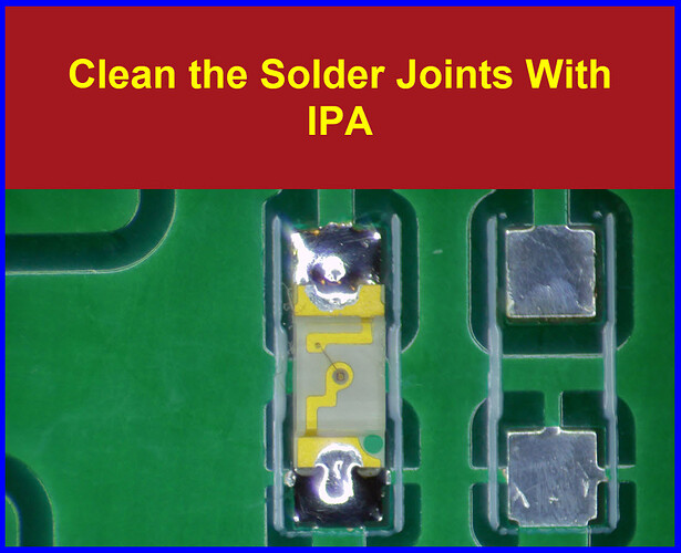

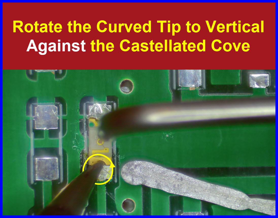

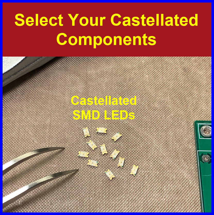

Hand Soldering Castellated Components
It can be difficult to solder castellated components as the area to the left and right of the cove is, usually, glass epoxy.
If you follow the images below, you should achieve good results when hand soldering these devices.

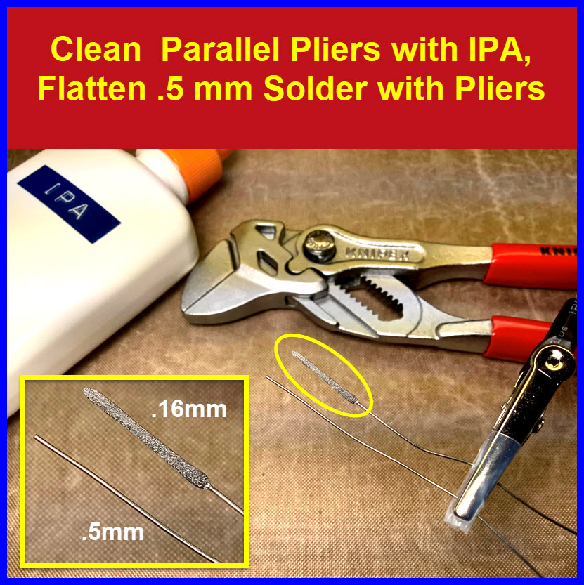

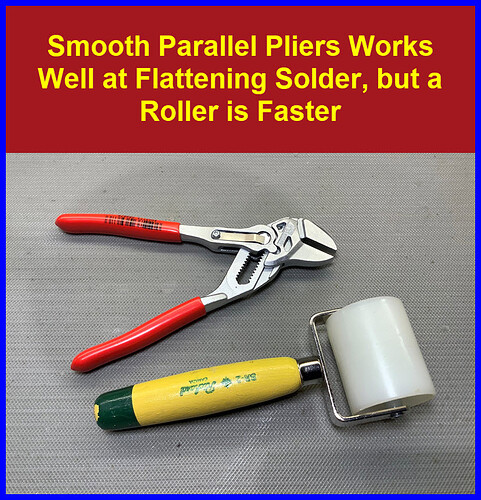

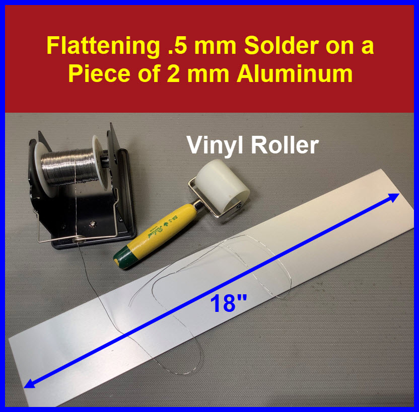

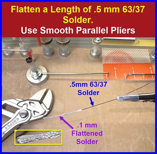

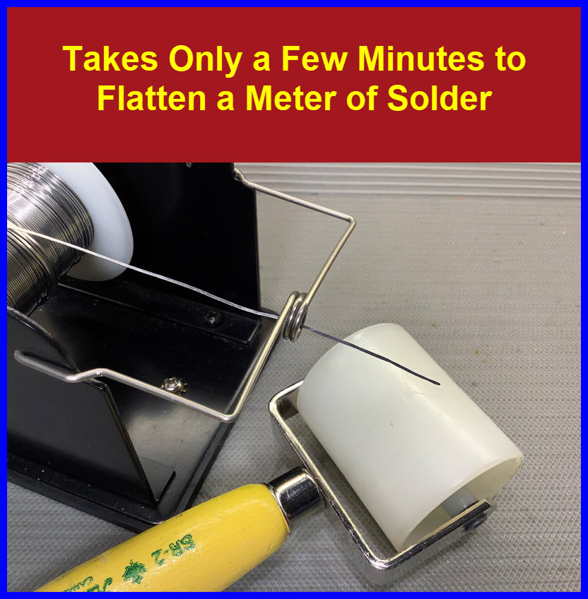

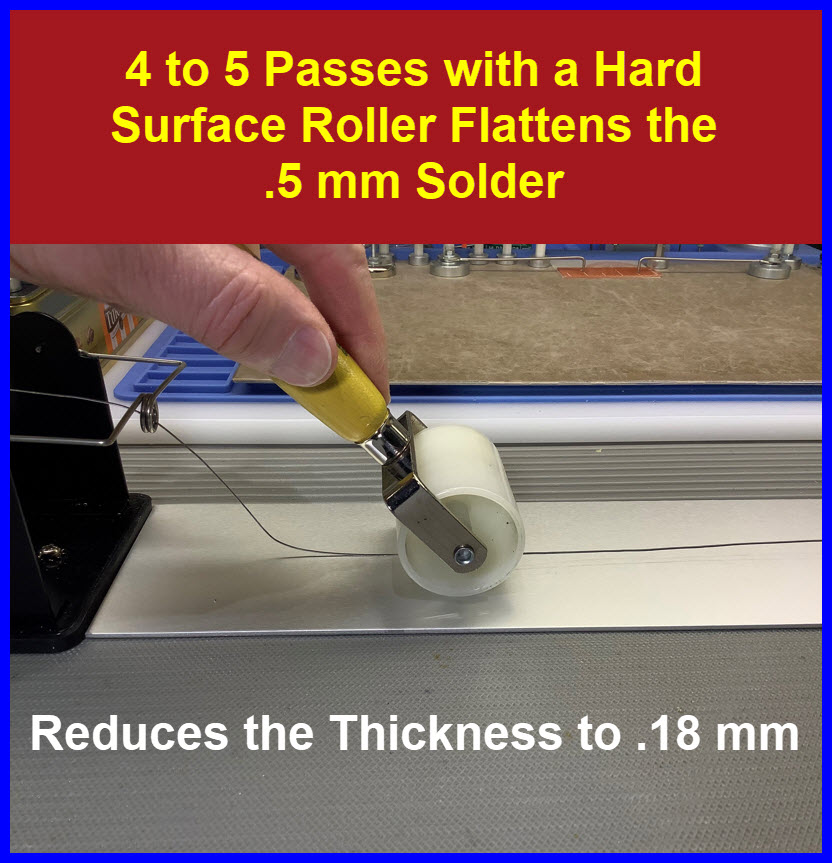

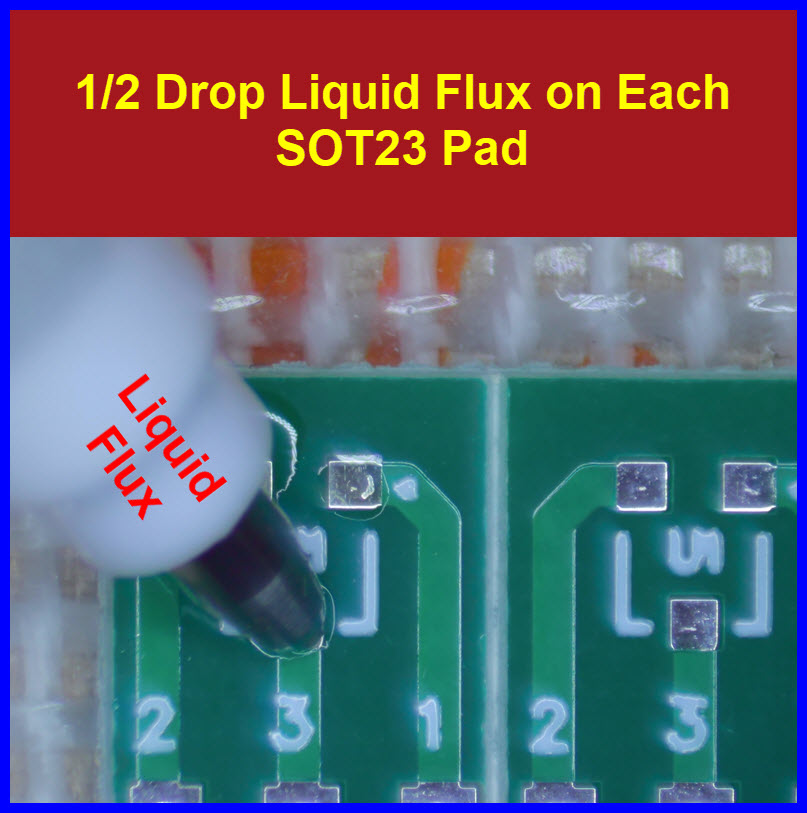

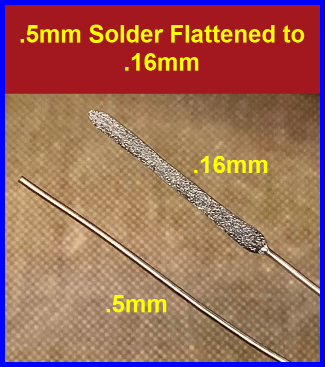

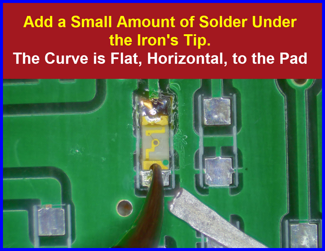

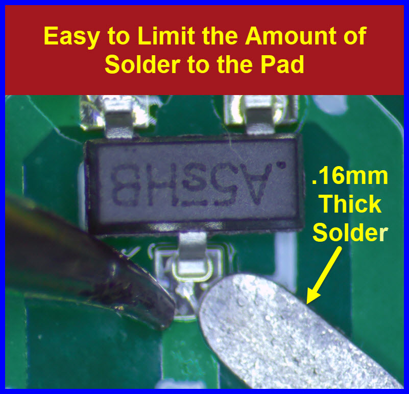

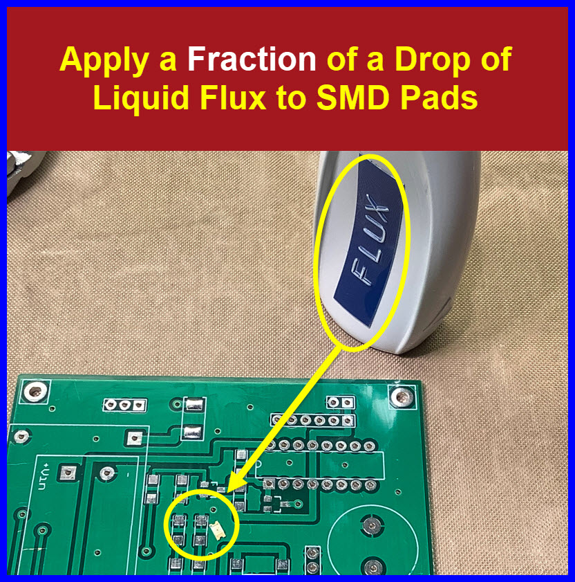

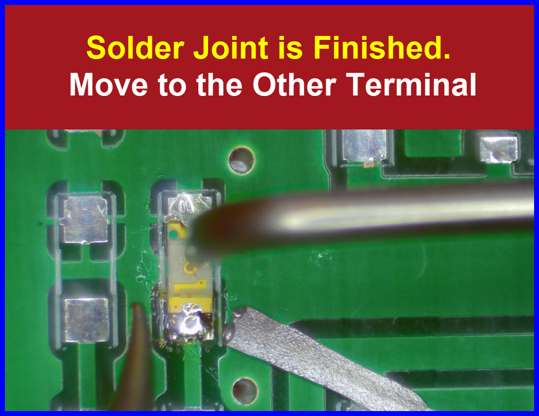

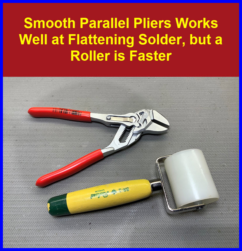

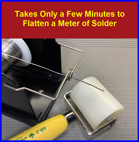

Flattening Solder Ahead of Time
Further to post #1015.
It can be difficult to source thin solder for SMD work.
Very thin solder seems to not have an appropriate amount of flux.
.5mm is a bit too large for soldering SMDs and usually results in using too much.
Parallel Pliers work well for flattening solder as you go; the main problem is it cuts into your soldering productivity and your soldering rhythm.
If you have a hard plastic or metal roller you can flatten solder quite fast and do it ahead of time.
Prepare few meters so it is ready to go when needed.
See the following images for this technique.

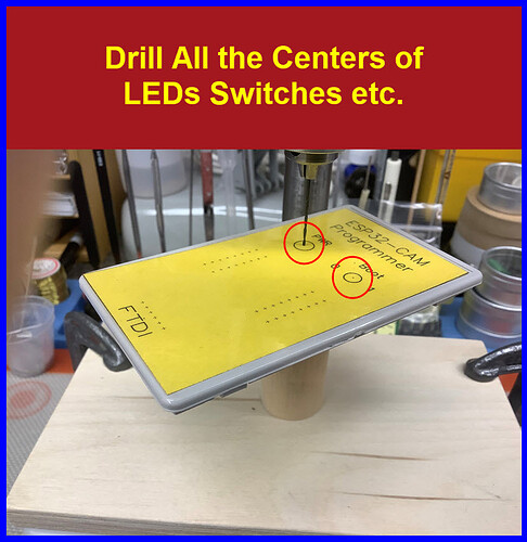

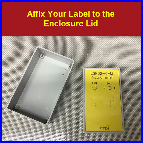

Making a Reasonable looking Test Jig
The following images show how to build a test jig.
  • Design your front panel layout.
  • Print a 1:1 paper copy and add double stick tape.
  • Laminate.
Enlarge the holes for your LEDs switches etc.
See this post for soldering the proto board components:

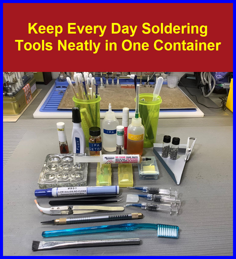

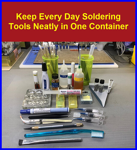

Bucket For Easy Access to Soldering Tools
New to Soldering ?
Stay organized by placing your soldering tools for easy access in a tool bucket.
Have several tool buckets for repeating jobs ;)

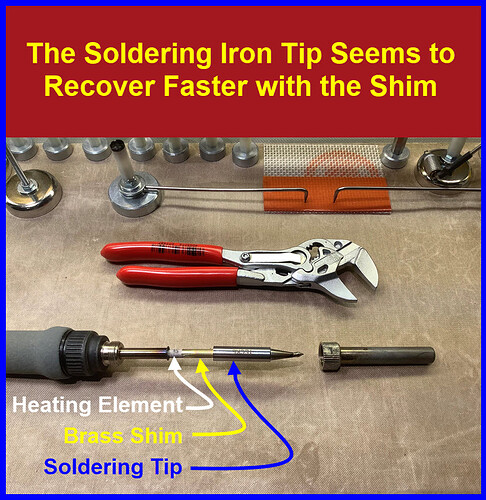

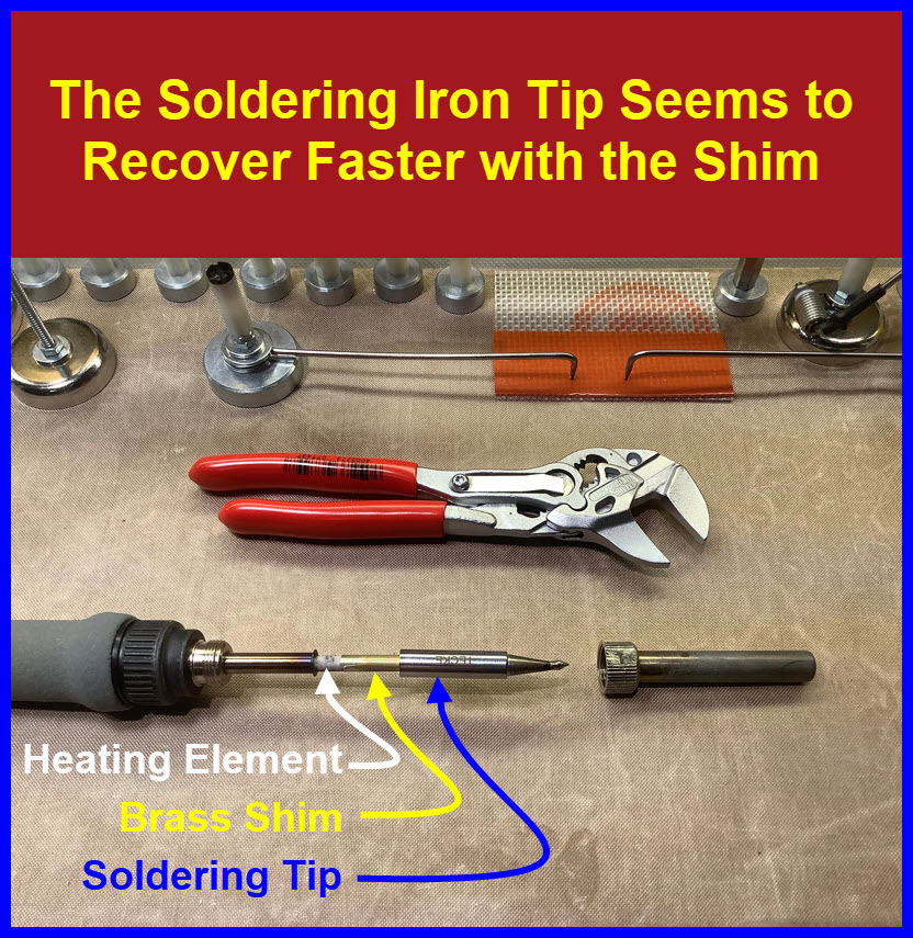

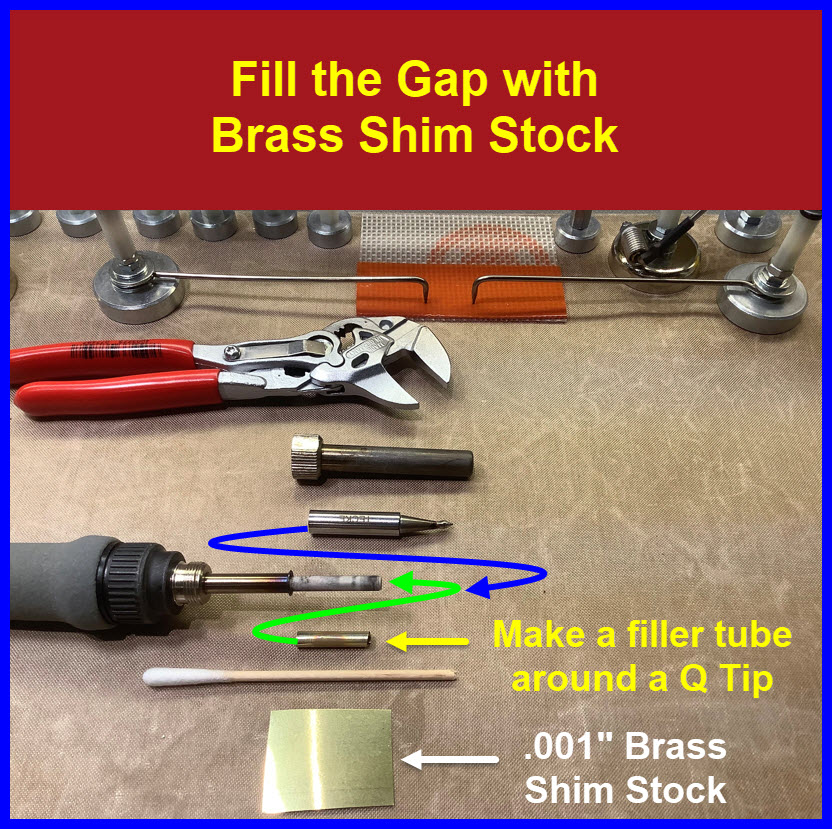

Faster Soldering Iron Tip Recovery ?
Small soldering iron tips can have a long recovery time after you solder a connection.
The modification shown is done on a FX-888D soldering iron.
It seems to make the recovery time shorter.
Make the filler tube size so the tip can still easily fit over the assembly.
If you make the modification, please let us know what you discover.

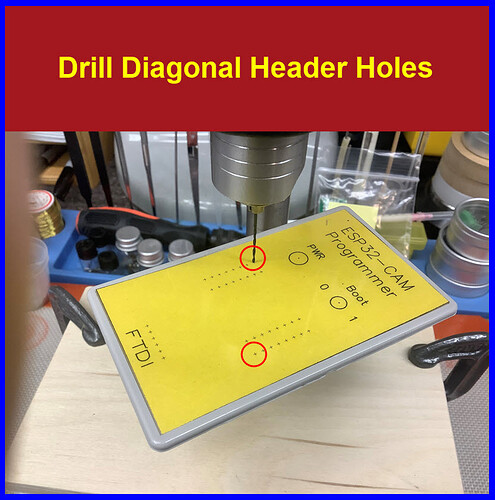

If you happen to order a terminal shield which is the wrong width for your ESP32 board, because everyone's favorite Asian Ecommerce site never provides an adequate description, then you can get a heavy-duty razor blade (cheap box cutters probs won’t work), score the board down the middle a few dozen times, then snap it apart with your hands. I used a narrow piece of flat bar to line up the first few scores. Finish it off with a file and sandpaper when done. Also drill additional mounting holes if you like. I Then cleaned all the dust away with some IPA and a brush. soapy water might be fine too.
wear a respirator during the entire process.
I then experimented with applying a thin coat of 2-part epoxy adhesive to all the edges, using both my gloved fingers and a cotton swab. This worked great in sealing up all the nasty fiber's which may have been left in my machining process, and gave the added benefit of a silky-smooth corner finish, which is actually way nicer to handle than any other pcb component I've purchased :open_mouth:
I have had a similar situation when making a test jig for a product, my boss simply got the angle grinder out with a cutting disk and did the same thing.
Yes PPE was worn, and we used a couple of layers of conformal spray to fix the cut edges.
Luckily the particular PCB composite used for the shield cut very easily. I've had some trouble hand cutting and drilling some other boards. Thanks for alerting me about that conformal spray.
thanks :beers: :australia:
If you want the result to be a board, not two, then just epoxy a stiff material across the gap. Maybe a piece of PCB, or a piece of other sheet goods. Result is a card that may not be as rigid as the original, but can still be mounted on the corner standoffs quite acceptably.

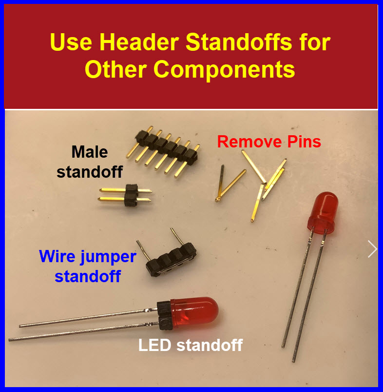

Two Quick Hints
  1. Over sized flat component leads can be difficult to plug into solderless breadboards.
    These oversized leads can even damage the springs in the breadboard conductors.
    It takes only a few seconds to modify these component leads so they can be accommodated better.
    Flat leads are bent at 90 degrees, so their orientation lines up with the breadboard spring mechanism.
  1. Use the plastic standoffs from male headers on other components to stabilize them and lift the component off the PCB surface.
    Pull the male header pins out of the standoffs, insert the new component leads in the plastic standoff holes.
